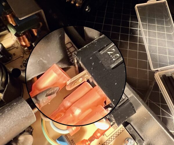

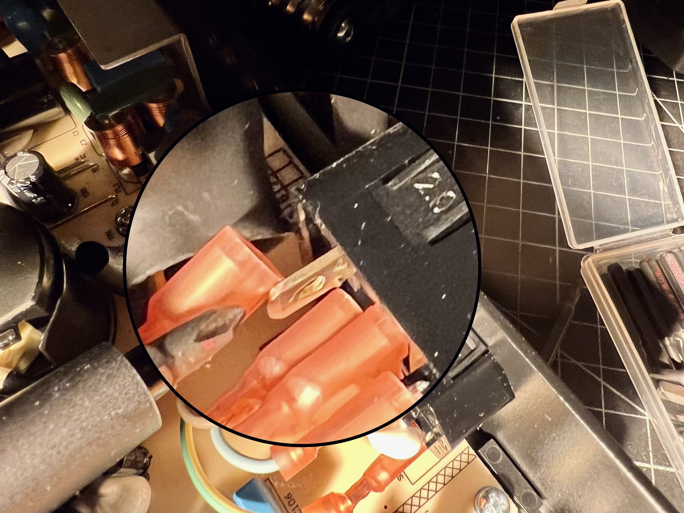

Just finished building the machine, was very careful. The plug is definitely pushed in all the way, and I've tested the outlet in the wall,, seems to be working fine.
One strange thing to note is that when I turn the machine onto its side, after 30 seconds or so, the power comes on, including the green LED on the power supply and the LCD on the front of the printer!
Any ideas?

Okay, I see what the problem is now. The black, plastic plug coming out of the power supply is moving too much, and when the power cable is pulled towards the left, it works, LED on. When the cable is left straight or pulled towards the right, the LED turns off and the printer gets no power. I just need a new power supply. My guess is something is not soldered correctly inside the power supply or something.

I opened my power supply and found this. Just sloppy assembly of the power supply at the factory I suppose. Thankfully a simple fix. Lots and lots of wasted time and headaches though.

Three years later, but thanks for posting this! A friend’s new printer’s PSU wouldn’t power on at all, and sure enough, the very same spade connector was detached! I wouldn’t have bothered checking if someone else hadn’t mentioned it.
Interior of a Prusa PSU showing a disconnected spade connector.
