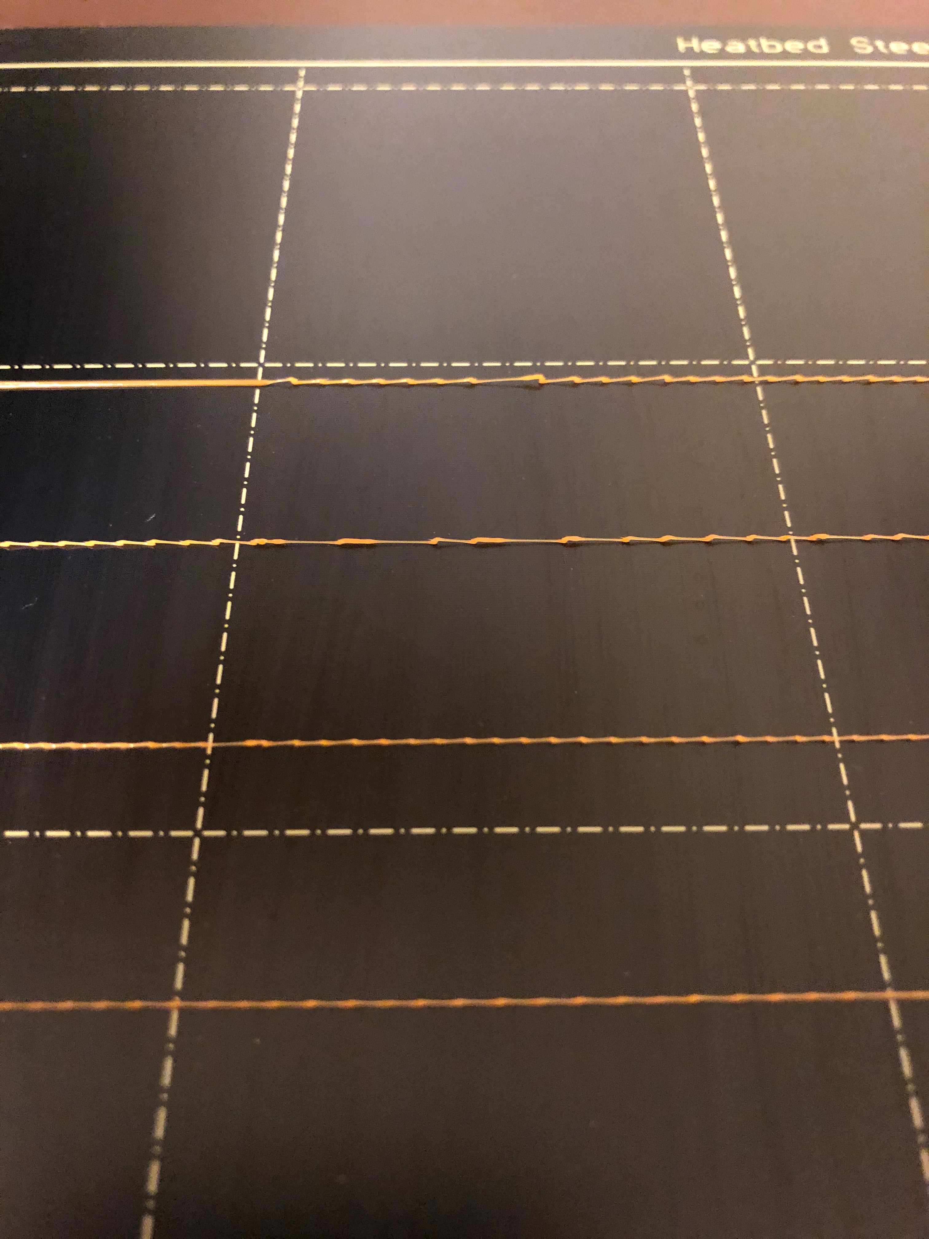

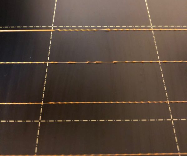

possible nozzle clog?
What would be causing this??  Haven't used in a few weeks and worked fine until now.  I have cleaned extruder and ensured that the filament is correctly aligned.  Could this be a nozzle clog that needs to be cleaned? Thanks for any suggestions!!

Read up on doing cold pulls. The top line looks good until the "squiggly bit" starts. A cold pull will help clear any partial blockage out of the hotend and nozzle easily.
It may be that your Live-Z adjustment also needs to be recalibrated. If you have not already done so, try using Jeff Jordan's "Life Adjust" procedure for calibrating your Live-Z setting. It is much easier to use and understand than the on-board routine. It's much easier to make mid-print adjustments accurately with. In general, start high (less negative) and work lower (more negative) in large increments (e.g. 0.1mm) until the filament starts to stick on its own. When you've got your Live-Z setting adjusted properly, you should be able to gently rub the extruded lines on the PEI surface without dislodging them.  Then start lowering (more negative) the level until there are no gaps between layers.
