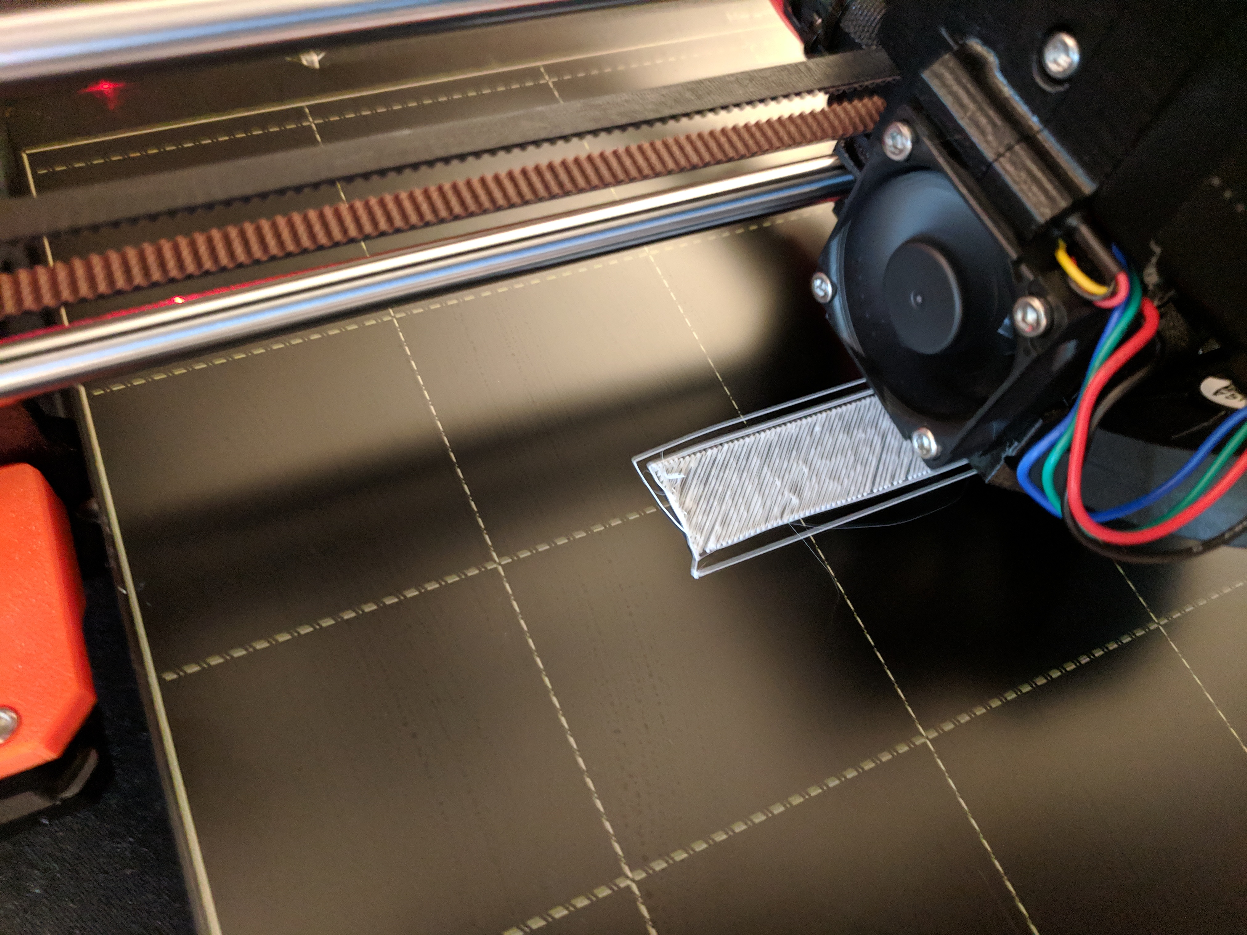

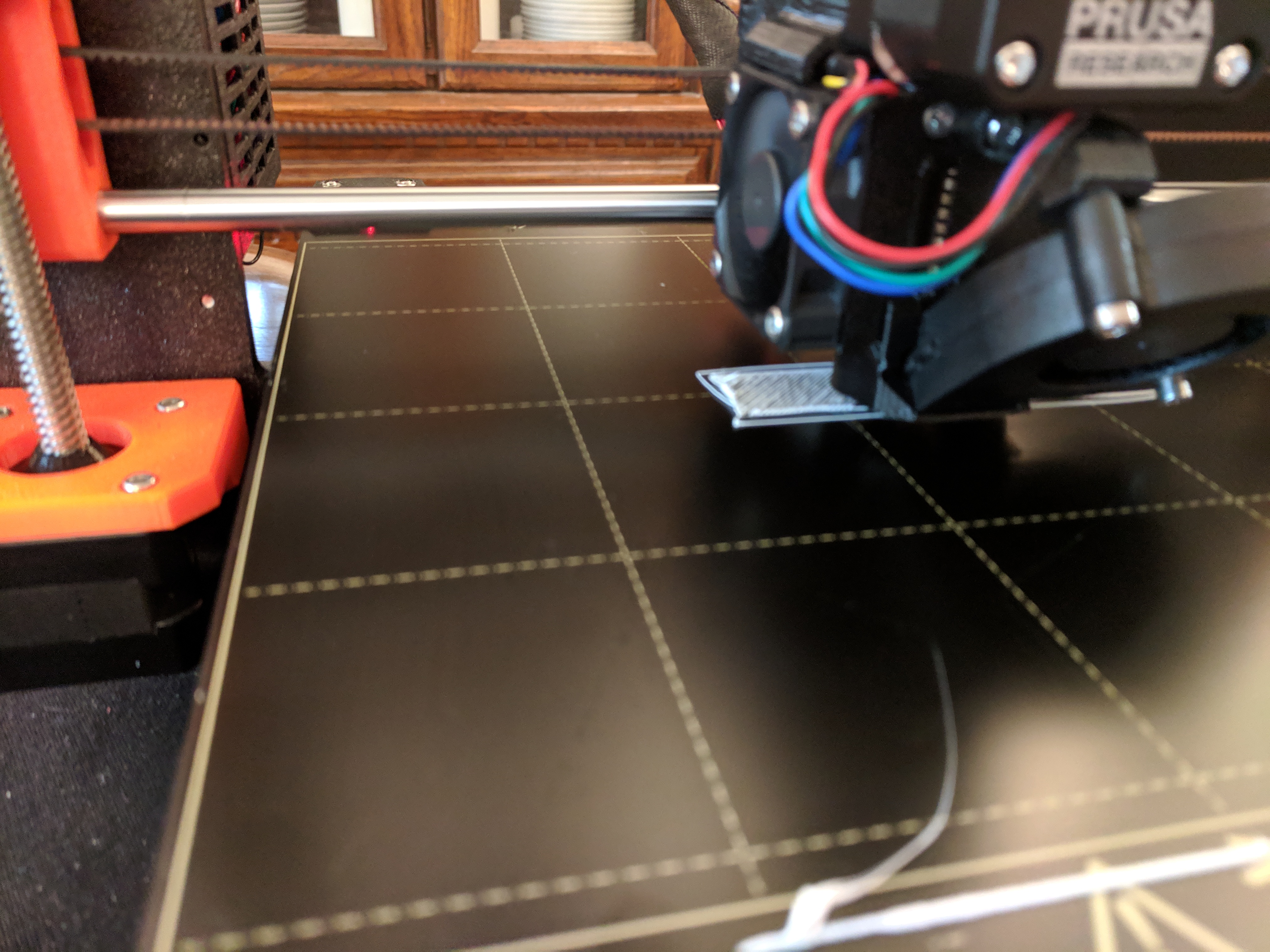

I just finished assembling my MK3S kit last night and tried printing the sample prusa logo on the SD card.
After a number of runs of "some problem encountered. z-leveling enforced" and it performing z-calibration multiple times, it gets around to printing.

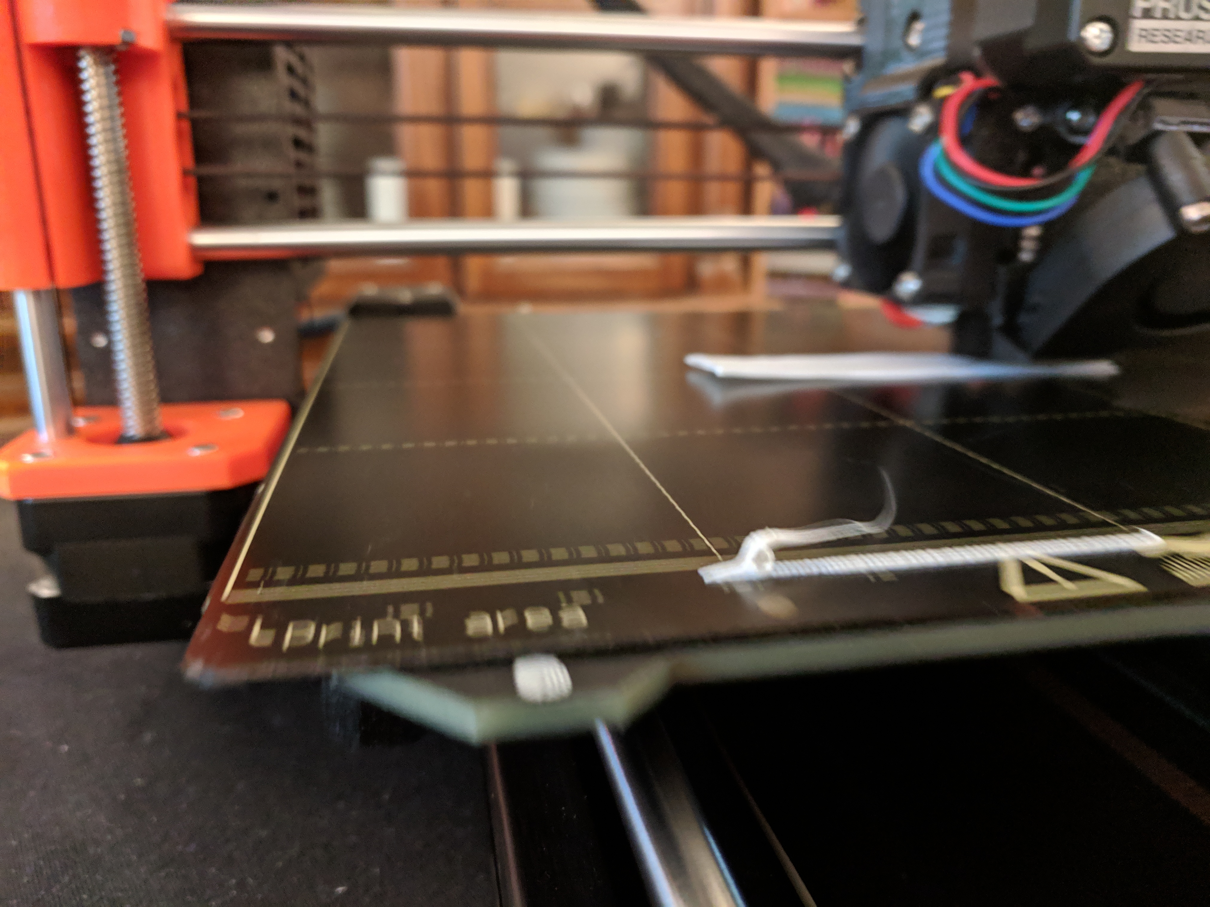

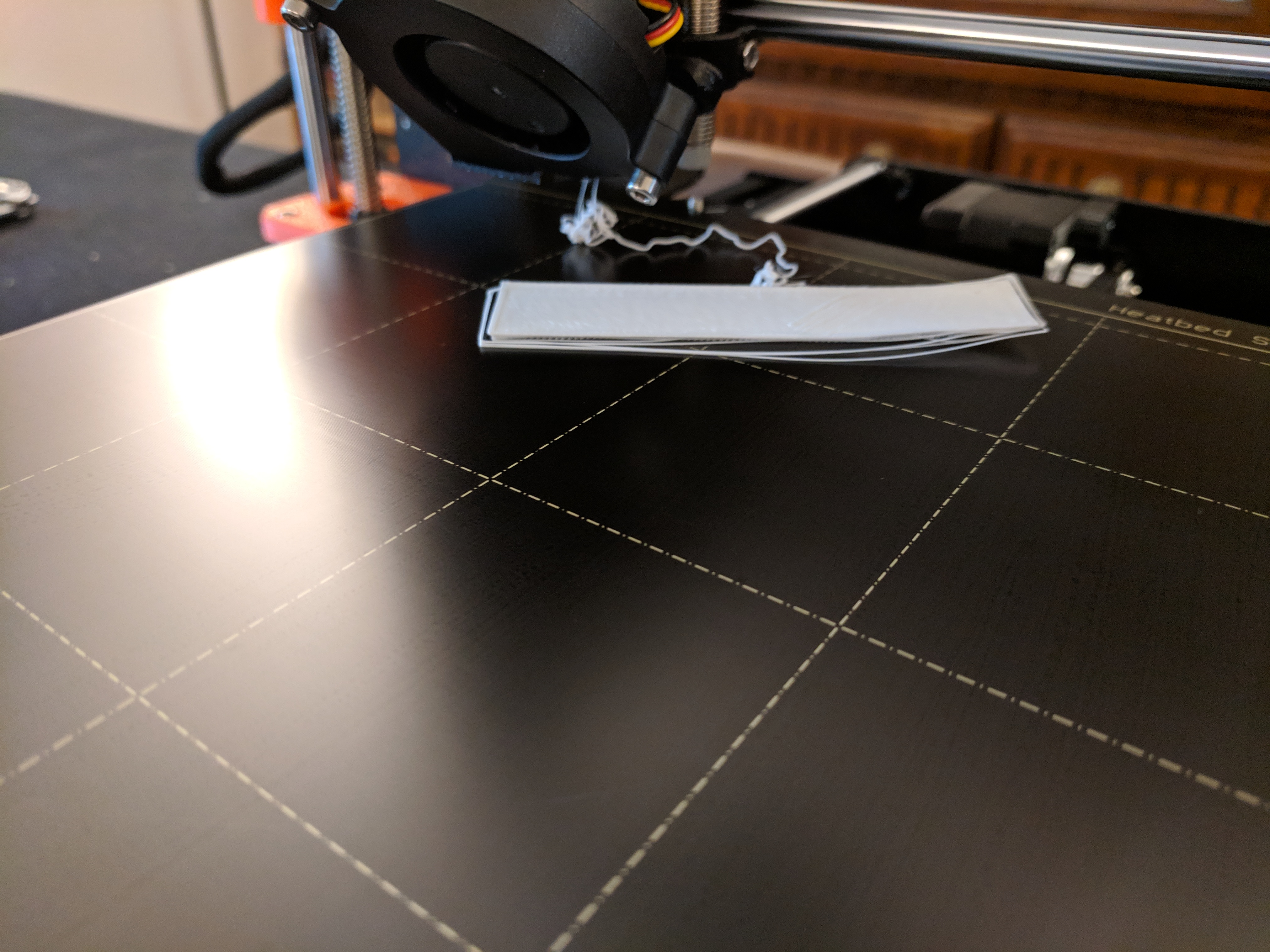

First layer seems okay. Second layer seems okay. By the third layer, one end of the material is starting to curl up off the bed. By the fourth layer, the curl is worse. By the fifth layer, the nozzle catches it and knocks the entire thing loose from the bed, and I stop the printing.
I tried this three times, getting the z-calibration issues and the curl issues each time.

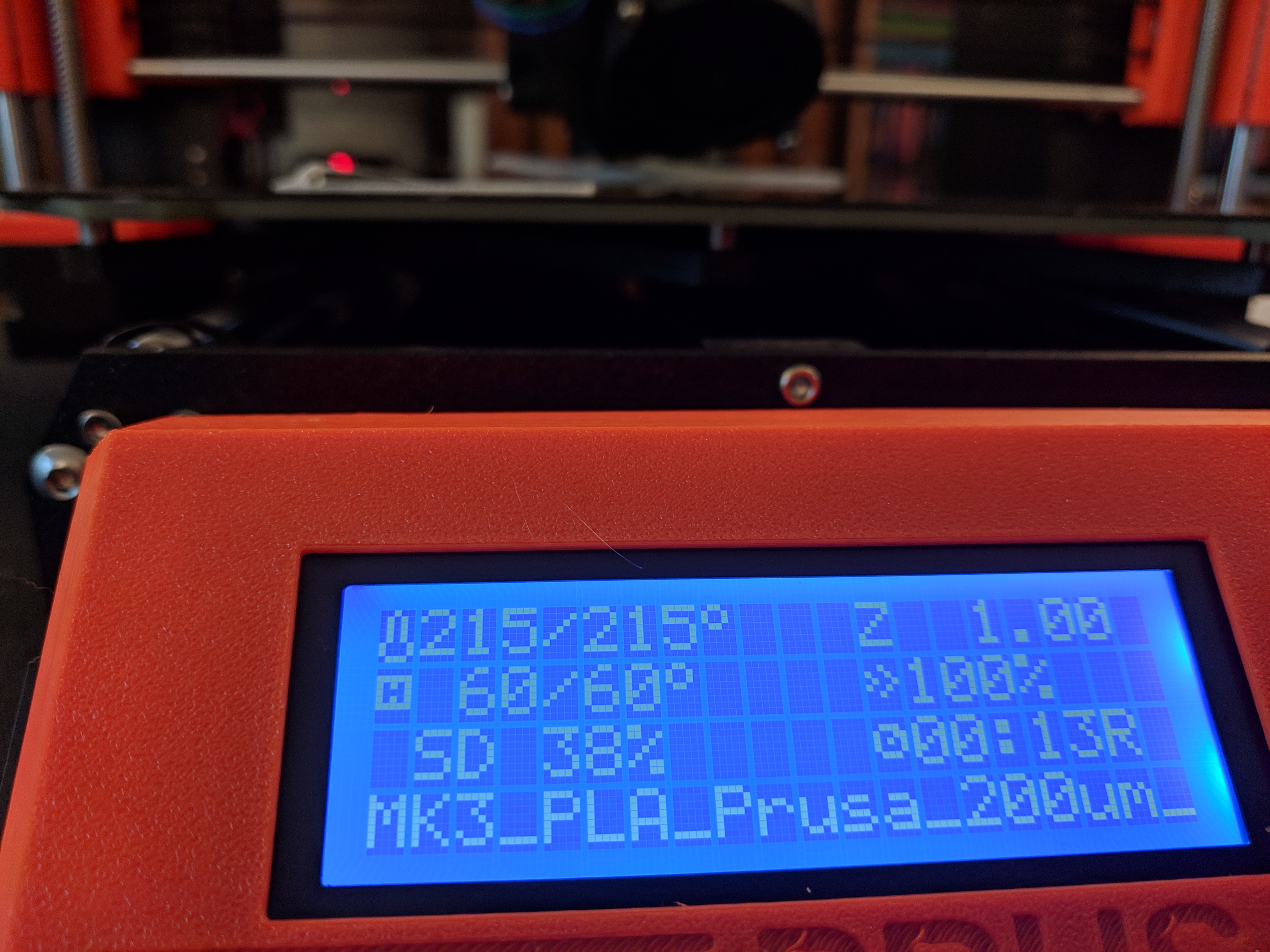

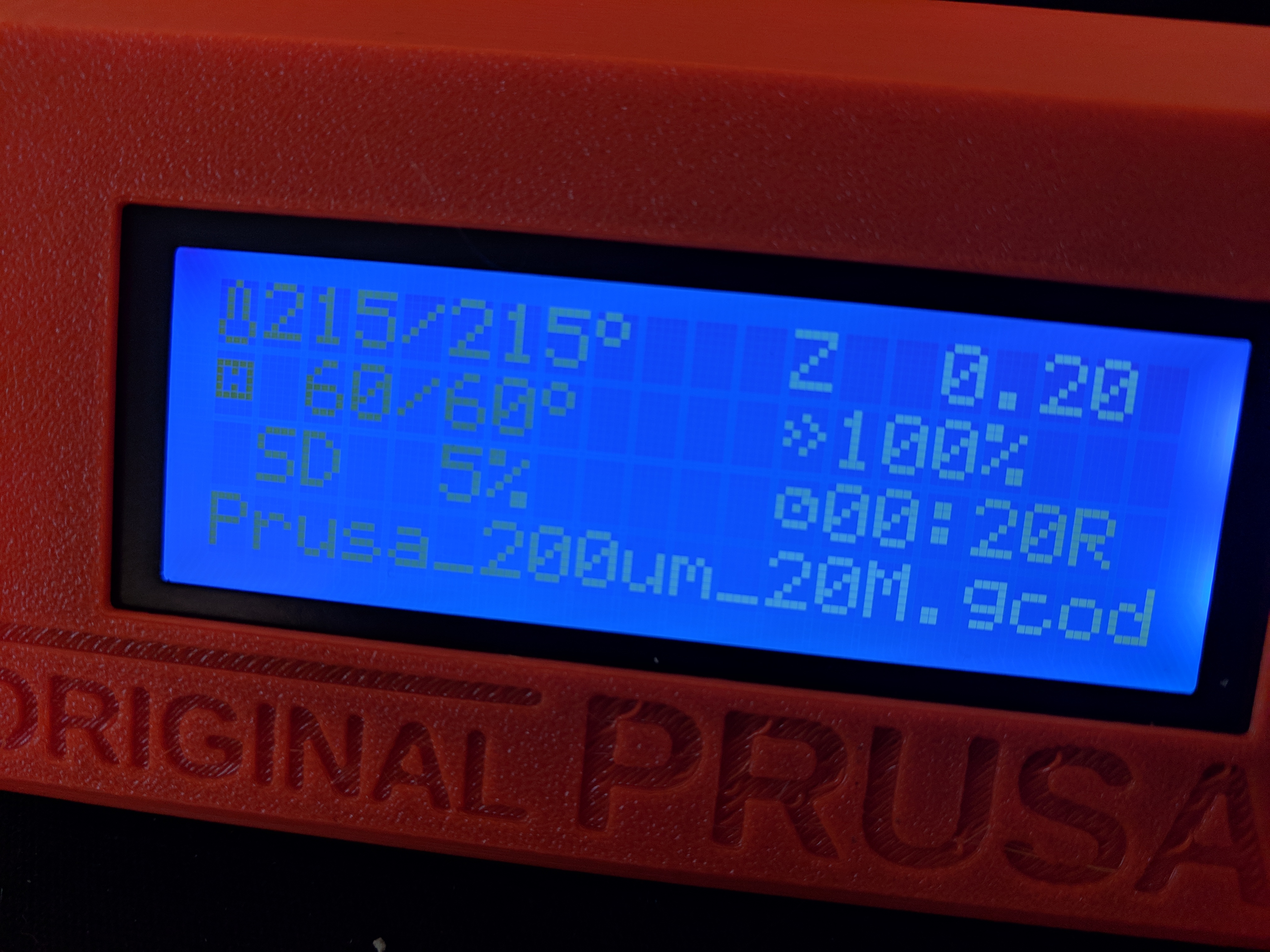

The display shows the heatbed is at 60 C.
Firmware is at 3.5.3 (I didn't updated it from what was shipped, though I am considering it).
I'm seen reports from others in the forum about the z-leveling issue, and it doesn't sound conclusive whether or not firmware 3.7.0 addresses it at all.
Anyone have any thoughts on either issue I'm running into?

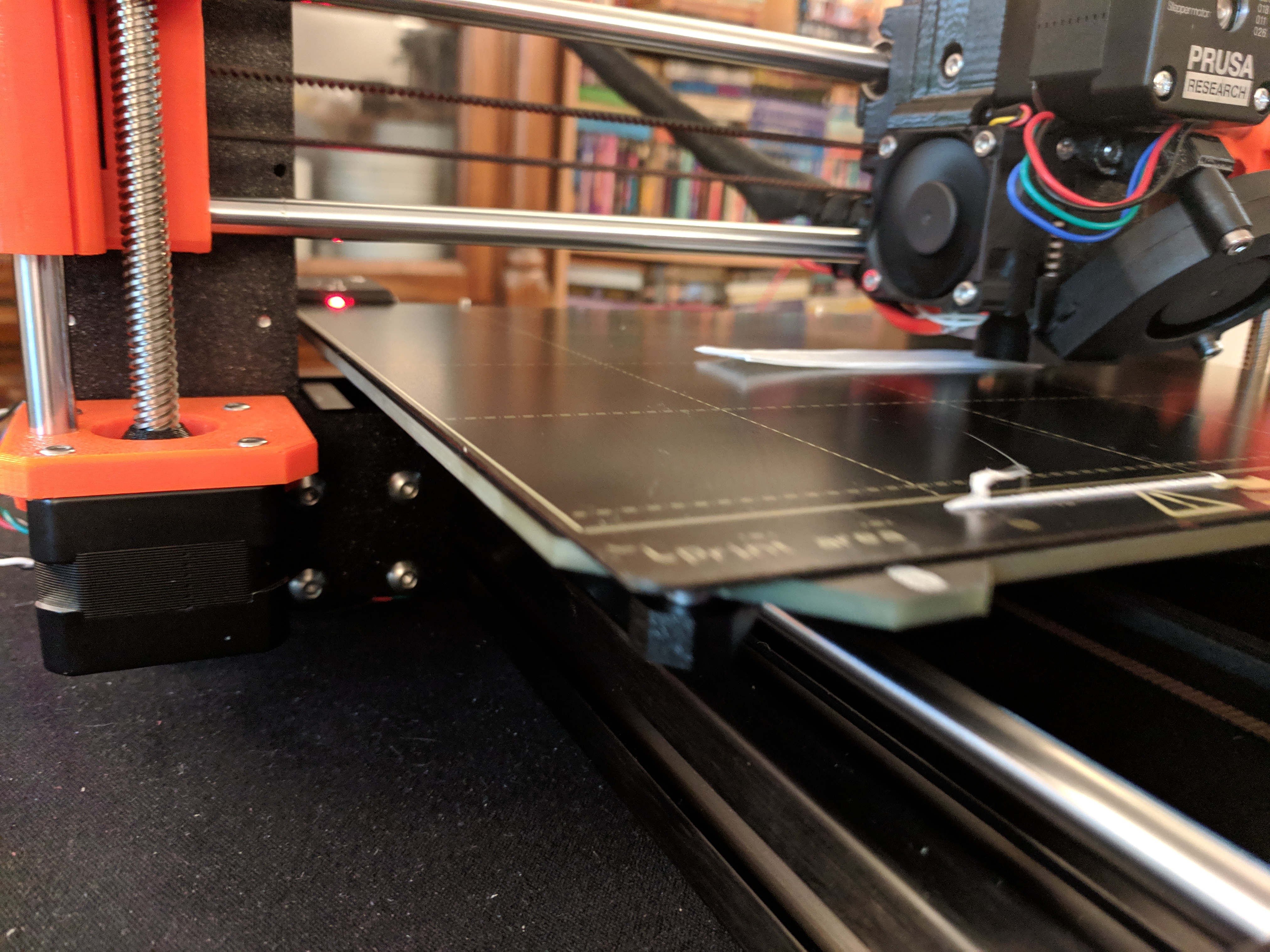

I upgraded to firmware 3.7.0-2201 downloaded today from prusa. No change in behavior. Two forced z-leveling events before it started printing. Printing failed in the same way. Same edge curling up to get caught by the extruder nozzle.

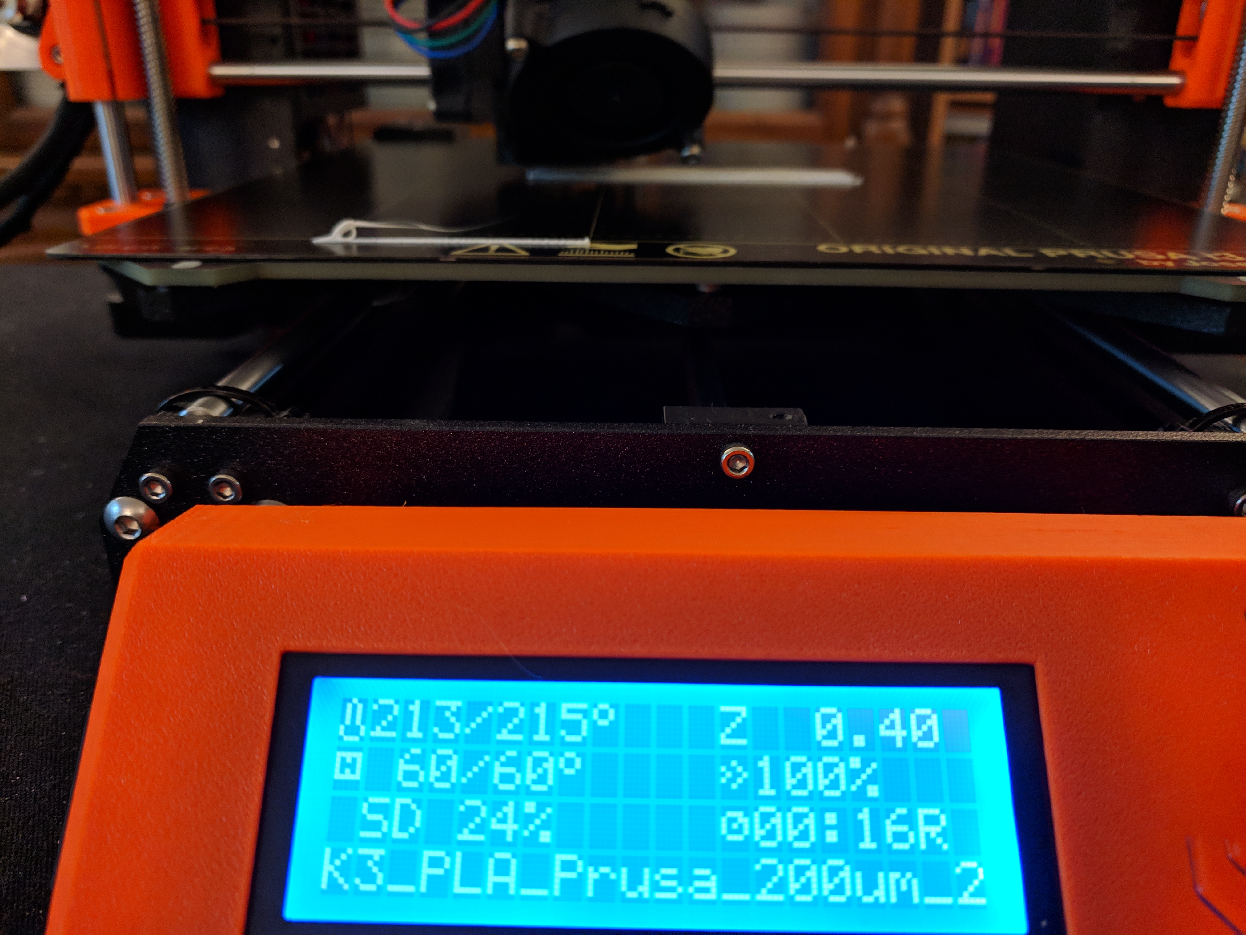

upgraded to latest firmware
extruder and hotbed temp are good:
printing starts (this is after the "z-leveling enforced" iterations are done)
next layer started
curling is starting

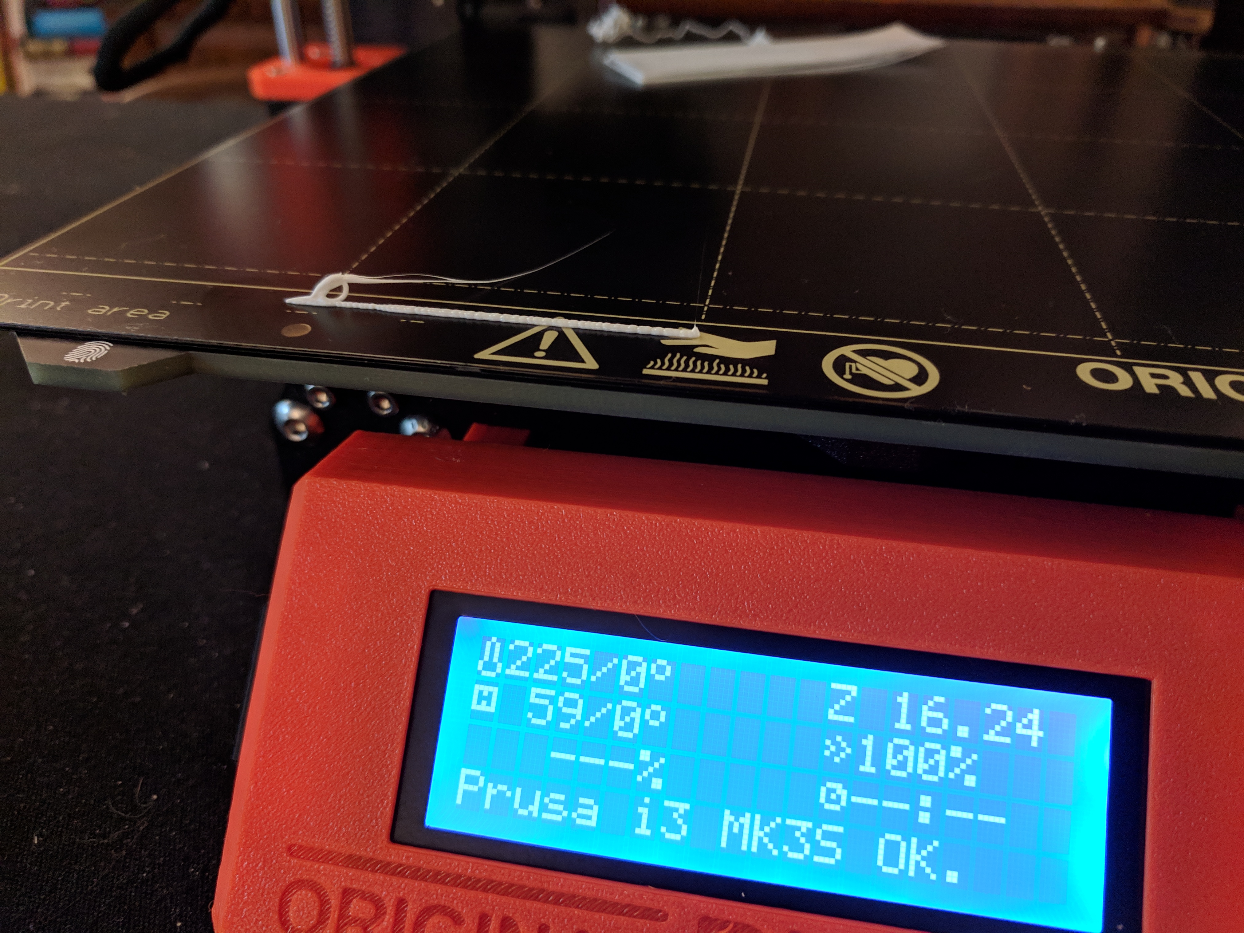

up to layer 5
and the nozzle catches it
stopped printing

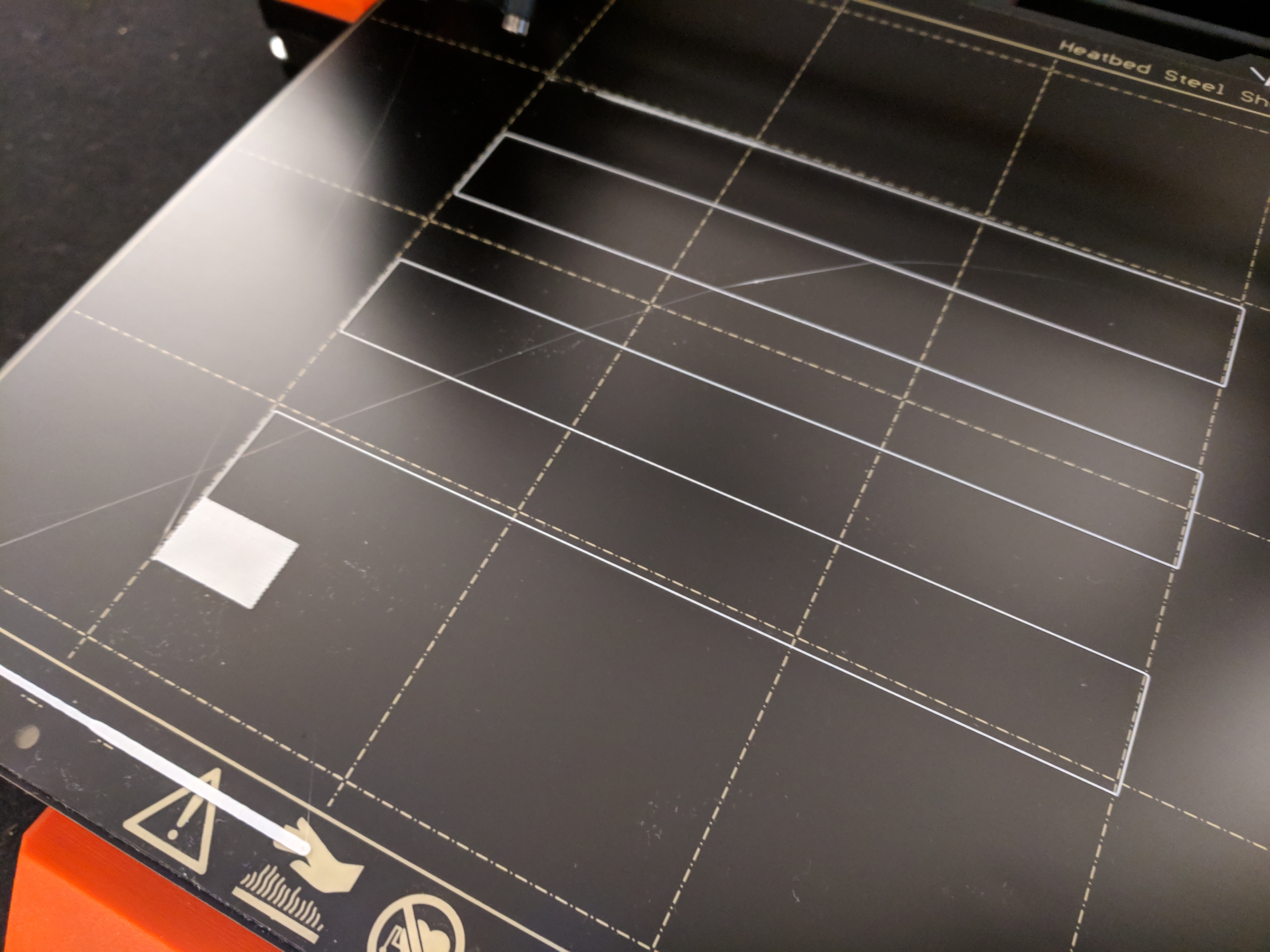

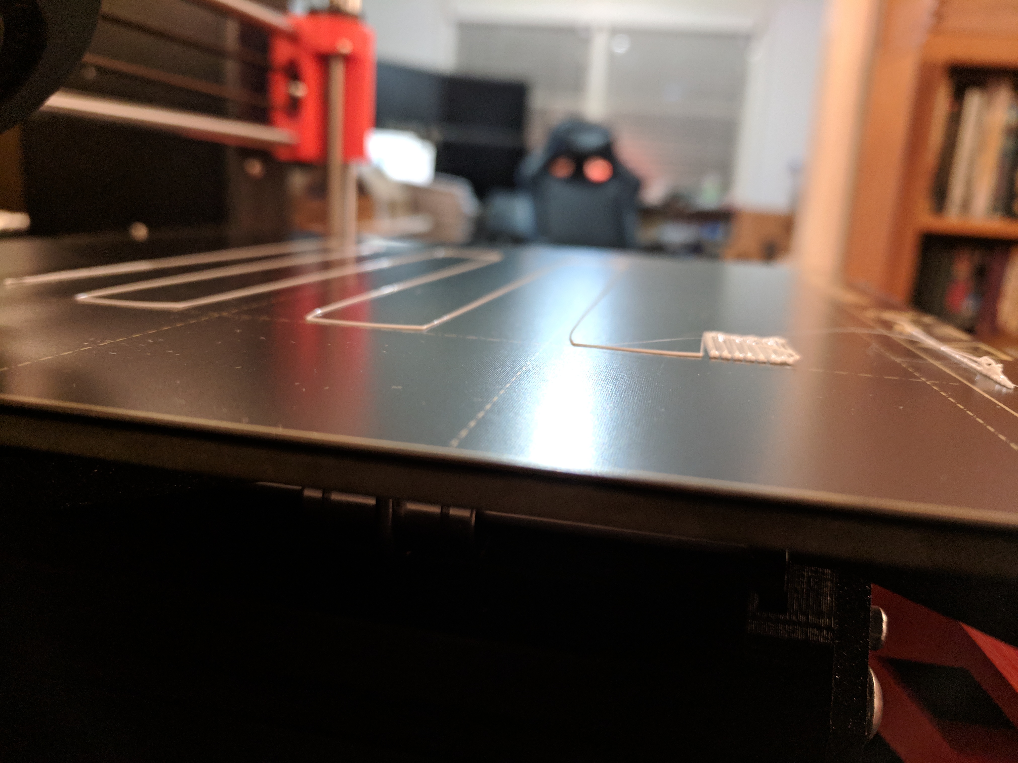

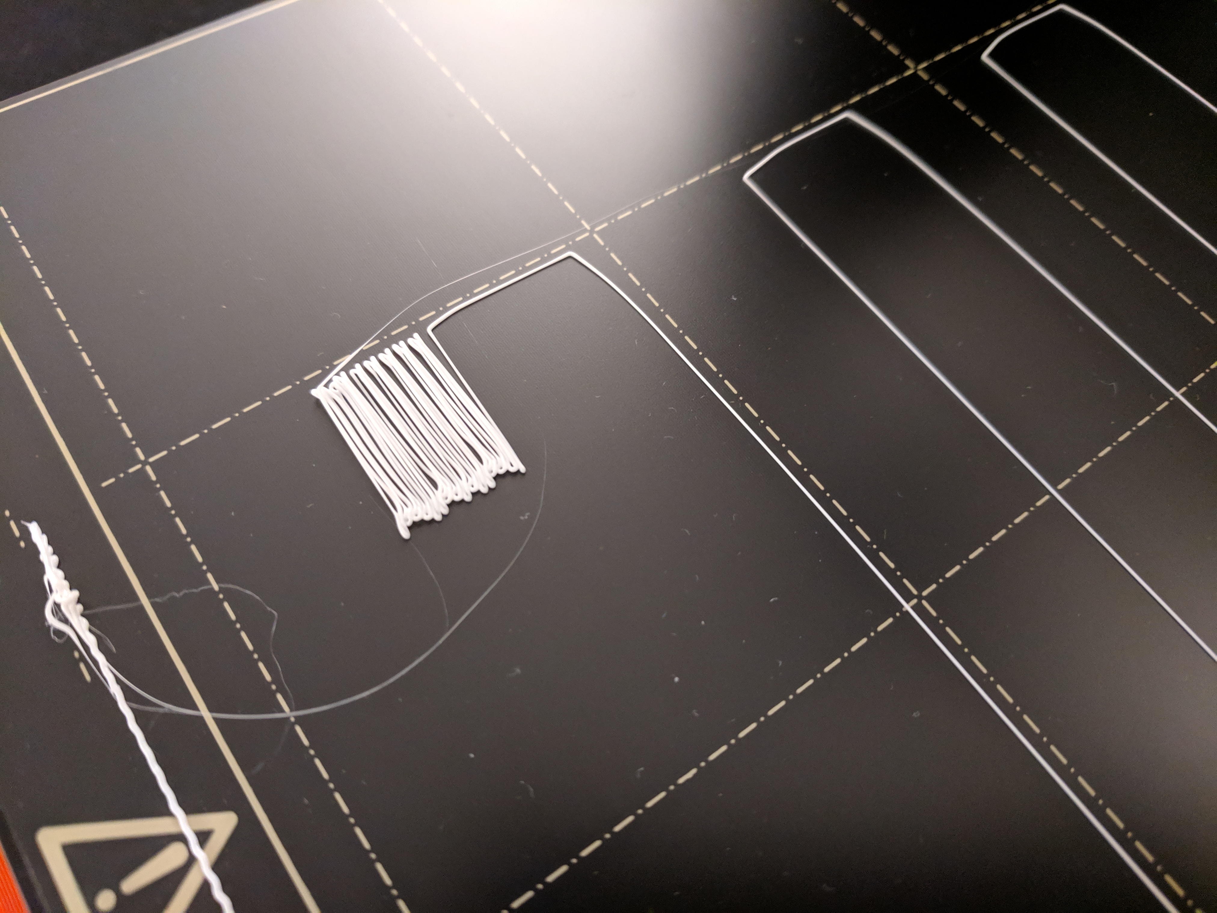

Sounds like a) your bed is dirty and b) there's something stuck under it.
Take it to the sink and give it a good scrubbing with hot water, clean paper towel, and a drop of dish soap (no additives - so no hand lotions, softeners, etc).
Once it is clean, handle it by the edges ONLY. Fingerprints on the bed surface will cause havoc with adhesion, and you'll have to wash it again to get them off. (IPA and acetone only spread them into a very thin film)
Then make sure there are no stray bits of filament, gunk, etc stuck between the heat bed and the sheet; the Z error happens when the PINDA gets a reading that is more than 2mm out of whack with what it expects. If all is clean, and the issue persists, re-run your Z calibration from the calibration menu.
Edit: your pics came in while I was typing this. I can see your bed has streaks/spots, so it is dirty.

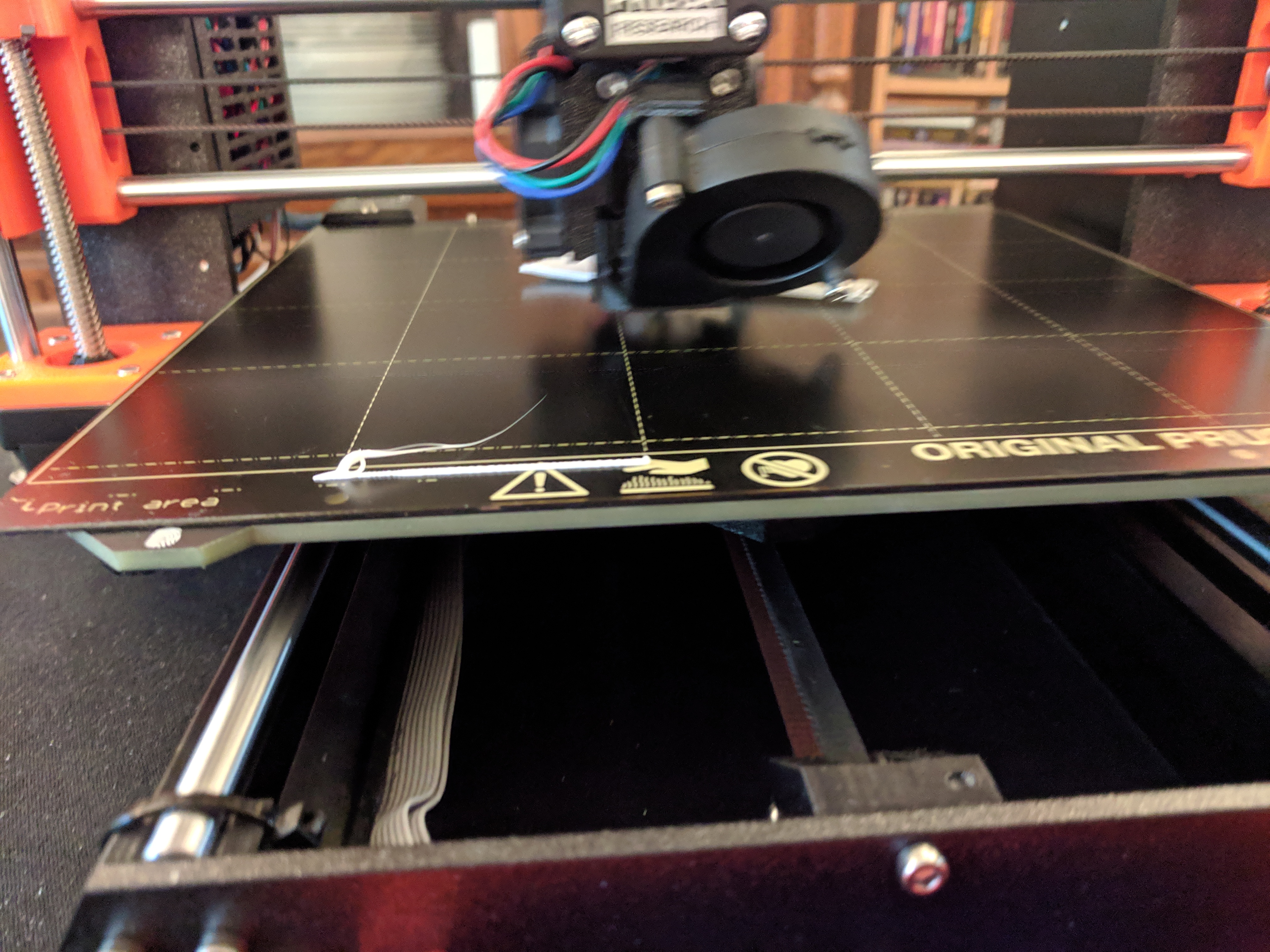

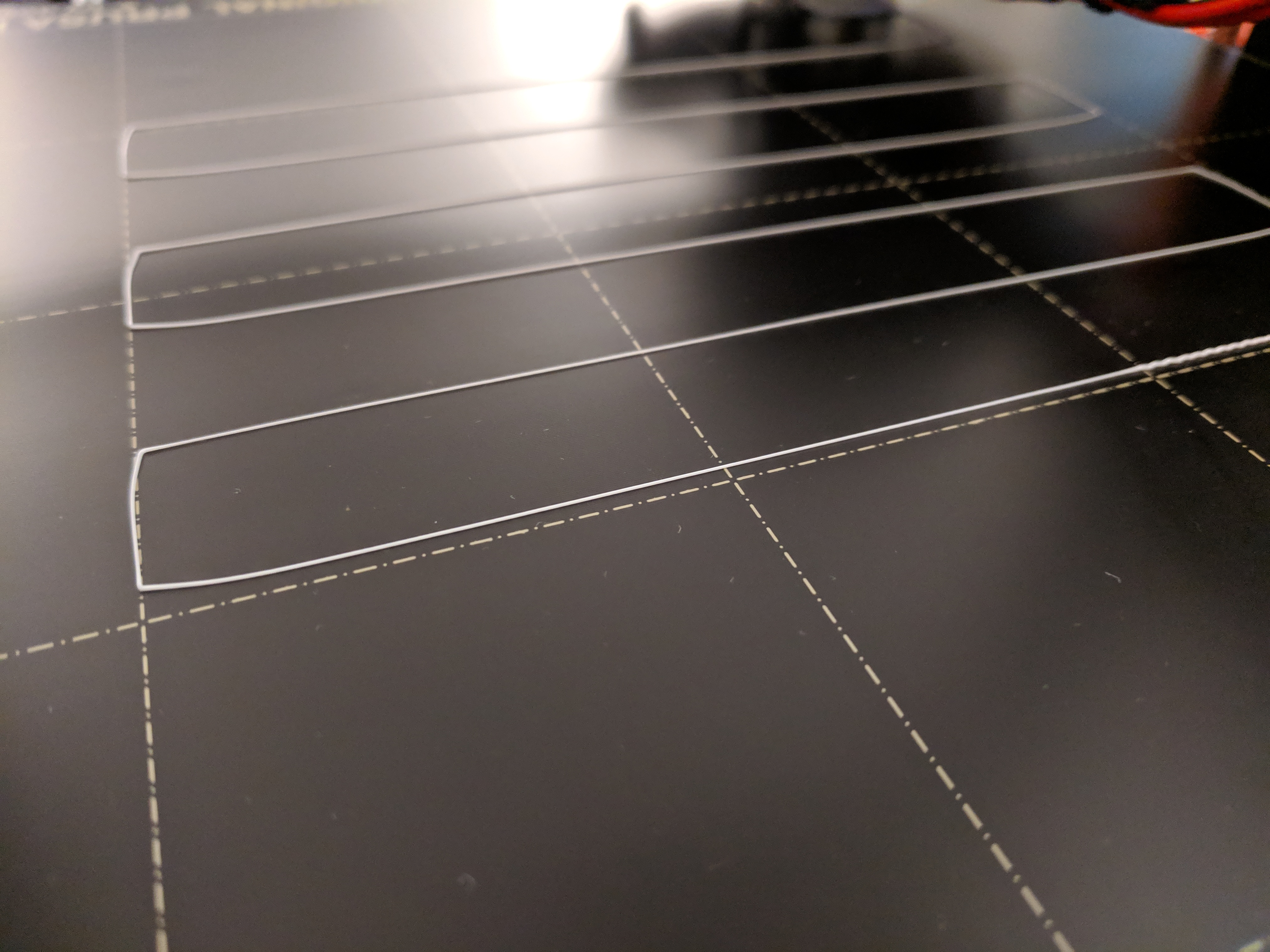

It also looks like your live Z setting may not be right, or you have massive underextrusion problems. Please post a picture of your first layer only (or the bottom layer of the failed print).
Further edit: I can see from your purge line your first layer is WAAAAY too high. See this thread for a more helpful way to get it dialled in:
https://shop.prusa3d.com/forum/assembly-and-first-prints-troubleshooting-f62/life-adjust-z-my-way-t2981.html
Right now you're basically just laying stuff down in the air on top of the bed.
Posted : 12/04/2019 9:52 pm

After the first couple failures, I had scrubbed the bed with 70% isopropyl alcohol wipes which I saw suggested somewhere. I just took a flashlight to it and see streaks left behind from that. So, I'll clean it your way. 🙂
There had been some fingerprints from when I first pulled it out of its bubble wrap and almost dropped it. And again when I was laying it on the bed and wasn't ready for the magnets to yank it from my hands.
The problem with the z error is it is not consistent on where it occurs. sometimes at point 4, others at point 5. Sometimes it makes it to point 7 or 8. But so far it always occurs 2-4 times before it will start printing.

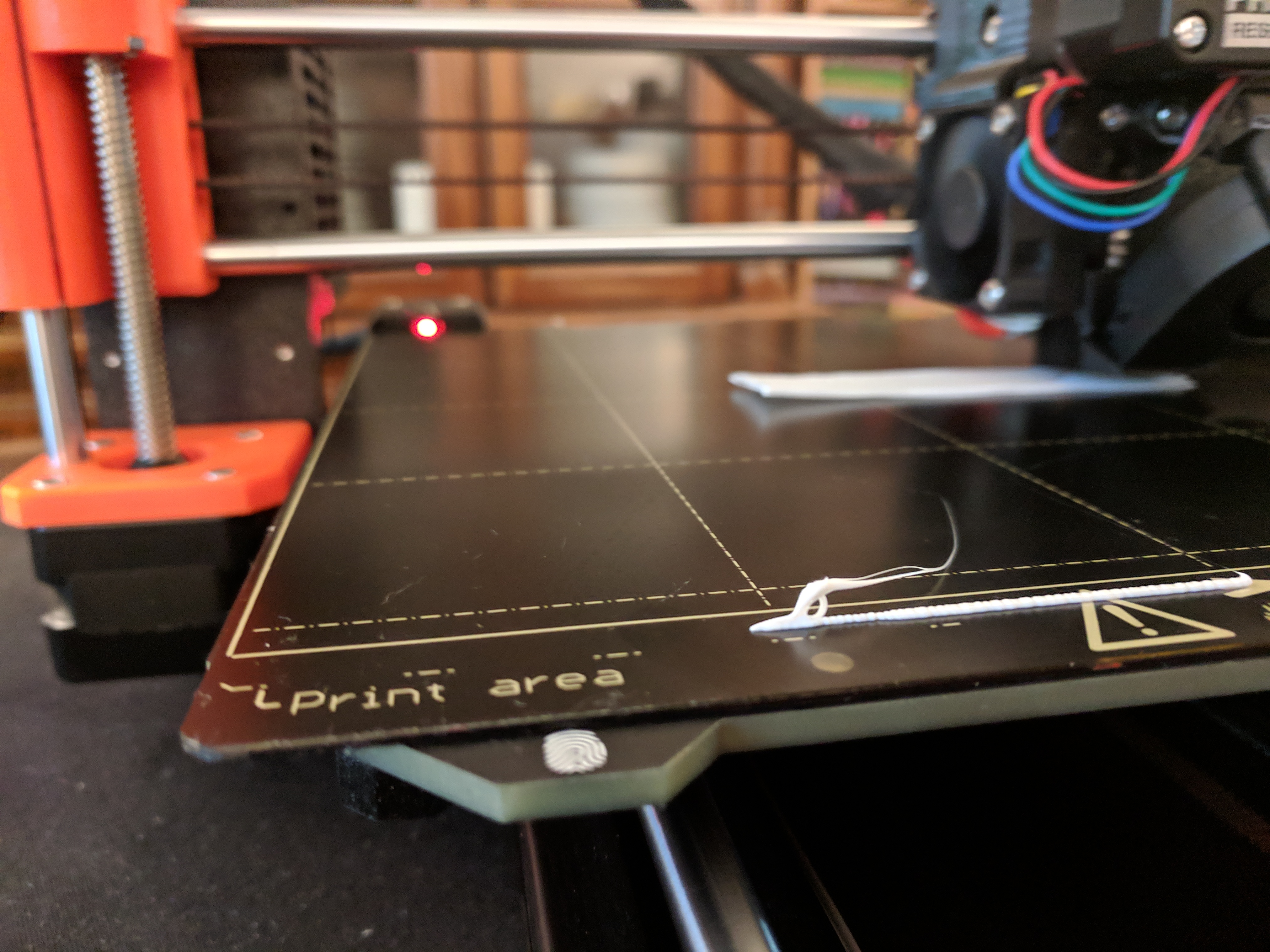

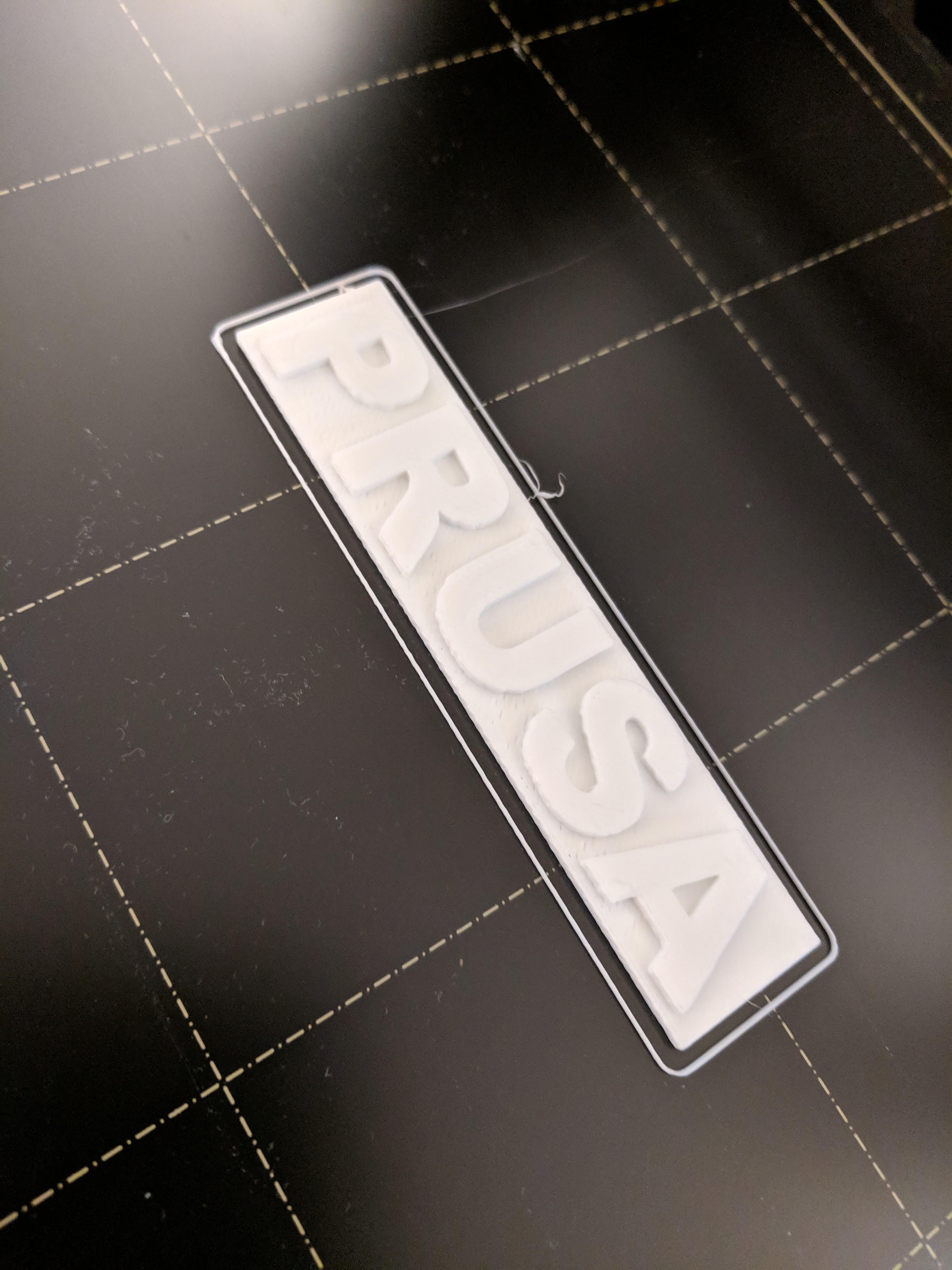

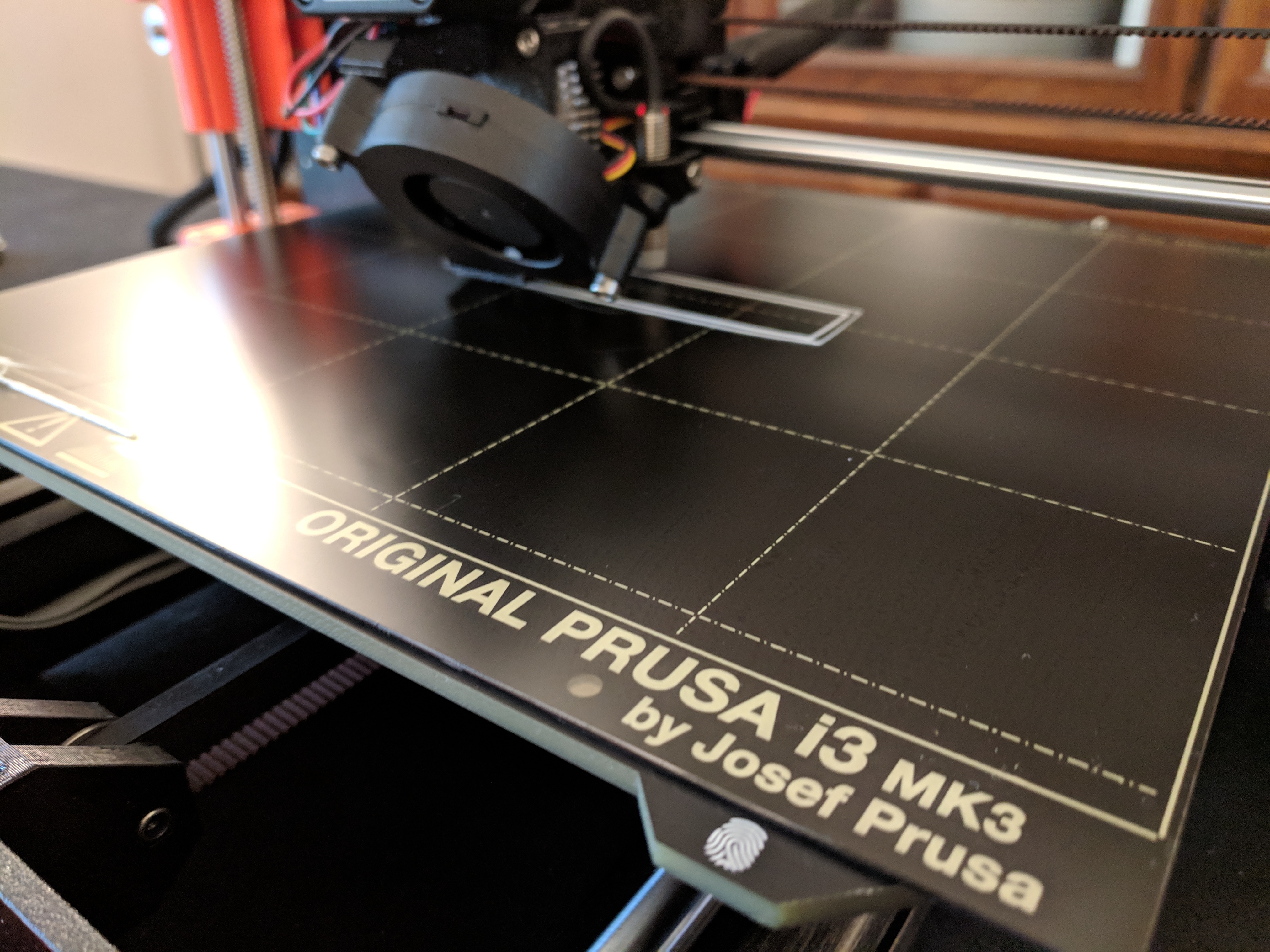

Ok, ran a full selftest and it failed at Y-axis. Had to tension the belt just a tad. Z-calibration looks good, the carriage reaches the tops of both screws at the same time every time (multiple times! due to...) Then I kept getting stuck on the paper test, having to power down. Finally figured out that the nozzle had a tiny drop of PLA on it and cleaned that off, so finally passed that test.
I ran a "first layer test" multiple times, lowering Z throughout and saw marked improvement. I reached -1.300 and decided that looked good, I think.
before adjustment
after adjustment
and finally!
Also, the "z-leveling enforced" issue seems to have vanished somewhere in the middle of all those reboots.
Thank you ever so much for the help!
