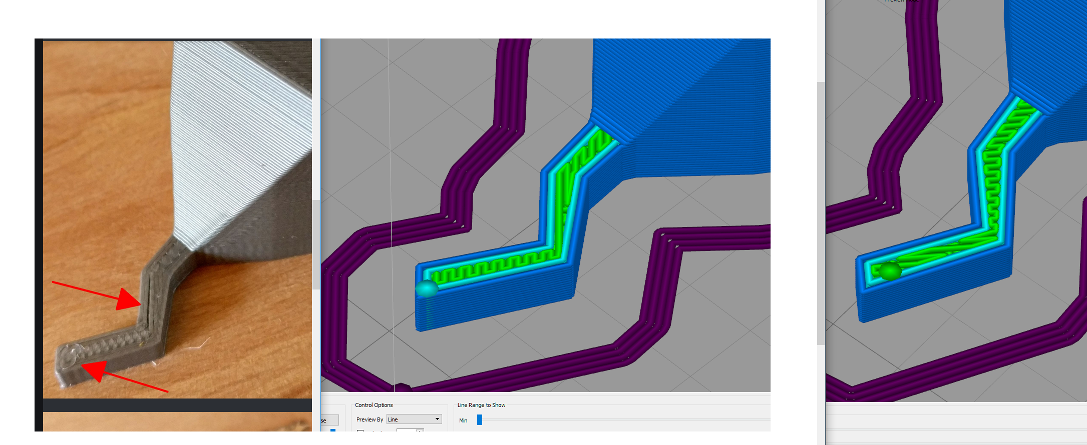

[edit] Also, is there a way to correct that drooping layers (points of the letters on the XYZ cube, holes on the front of the benchy...) that's a case of not enough cooling because of small object right? should I speed down a lot? or print more than one object to give them time to cool down? any other way? because I see those a lot (the underside and ears of Marvin...)

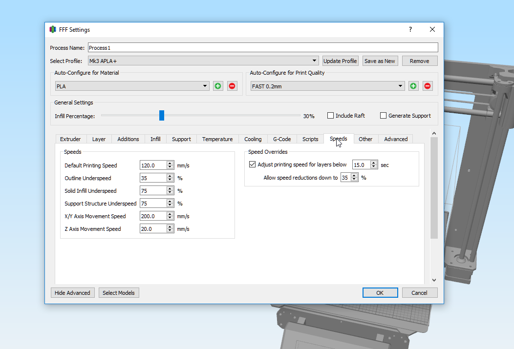

I updated to 3.2.1 and did the linear calibration printing the ECOR tower. Pretty good results (of course is presliced by prusa so...) with "just" two small separations between layers, and, of course those damn gigantic seams that I guess won't ever go away . On the other hand I measured the walls and they are exactly 0.45 so I guess I'm not under extruding.
Just to test the new firmware after the linear advance calibration I reprinted the iris box (it works this time) with the only change of lowering both infill speeds (Infill and Solid infill) to 100mm/s. It works well although on the exterior looks like crap, full of zits and seams, and the closing leaves look horrible.
Finally, while reading the extrusion inconsistency discussion on github I printed some XYZ cubes. The 0.1 one is the default Slic3r PE detail settings and looks absolutely terrible. The middle one is printed with a gcode (downloaded from the discussion) that someone sliced with simplify3d and the one on the right I sliced with Slic3r PE at 0.2 with both infill speeds at 90mm/s and it doesn't look bad apart from the seams and the extrusion inconsistency problems (present in all of them).
Clearly the best one is the simplify3d one. Probably because of my inexperience in setting slic3r, but I'd love to do more tests. Unfortunately I don't own S3D (nor am I going to spend 150 on it atm). Since you use both, could you send me a gcode sliced with both with the settings you have good results at 0.2? A calicat or cube or something. I know there are lots of factors so good settings won't be the same for every person but would put me in the right track wether they work better or worse for me I can look what's changed.
thats the default 'wipe' behavior that slic3r uses instead of a coast, plus the fact that its a single walled model. much less noticeable normally.
the alpha version of slic3r finally has a real full featured gcode preview that will be very useful to you to see where those retractions are actually happening.

  • These are the speeds I'm using
    I'm also using very low acceleration and jerk values which I commented in the start script.
    For comparison you can take a look at a Cali mouse I printed yesterdaywith the standard prusa fast profile (0.2 mm). The only change I made was slowing infill and solid infill speeds to 90mm/s instead of the default 170mm/s
    That looks like an effect of the orientation you printed in. The extrusion width can only be varied so much by the slicer so its possible to end up with small gaps.
    Check out the infill pattern on the tail when you change its orientation 90 degrees. Not sure if slic3r can do this, but I can change infill angles if it becomes a real issue. Changing infill extrusion width is another solution. But either way its not the printers fault.

    [*]haven't found the speed, at least in a way I can understand it[/list]
    So translated to Slic3r speeds that's more or less:
  • Perimeters: 78 mm/s (120-35%) - way quicker than the standard 45mm/s on Slic3r PE
  • Solid Infill: 30mm/s (wow, really? that's at 170 on slic3r and I put it at 90 on that calimouse
  • Support material: 30 mm/s
  • Travel speed: 200mm/s (higher than Slic3r where it's at 170)
  • Unless I'm reading that wrong of course, also slic3r seem to have more speeds to control (i.e distinguises between solid infill and top solid infill).
    Also jerk and acceleration , I saw them on your start script but I'm not really sure what they're for or where to change them on slic3r (or what values they're set at for that matter.
    You know what? it never occurred to me that that could be the problem :). You're totally right, and yes, Slic3r allows you to change that angle.

    just taller. 150% would be .3 if you started with .2.
    Its % of the overall print speed, not % reduction. You can always double check using the gcode preview.
    this one won't affect you too much for now but if you're printing a lot of tiny parts in a row then its best to get the nozzle from point A to point B as quickly as possible without oozing. The printer knows how fast it can move, so setting to 9000% won't really do anything. If I'm printing something overnight I'll slow it way down because the travels are by far the loudest movement in stealth mode.
