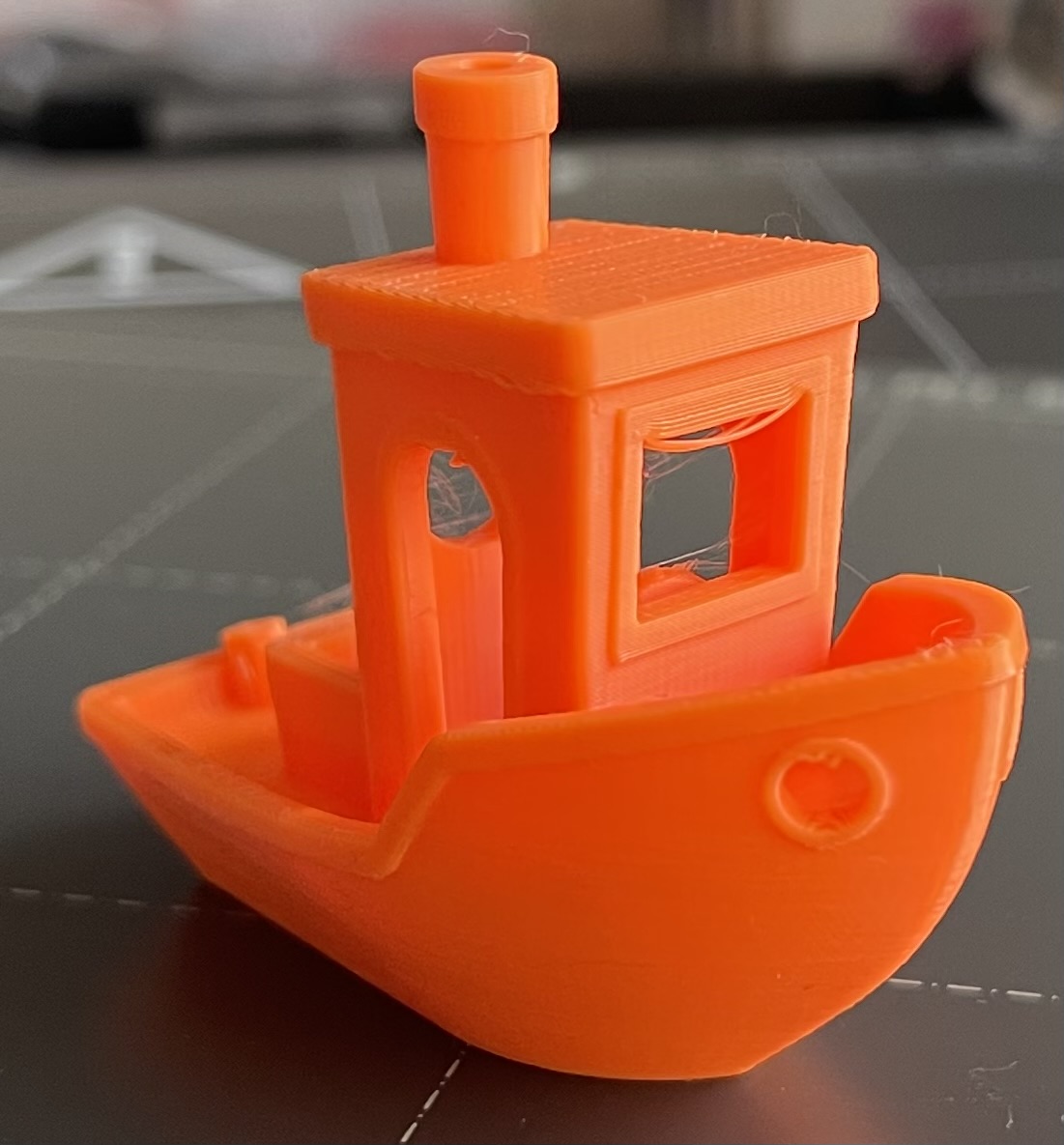

Done a print of the Benchy to test the printer and all seems well apart from openings with no support as seen from the top of the cabin front square window and even on the top of the little hole in the side hull.
Does this give any clues as to what I need to adjust to start with?

try reducing the print temperature so that the unsupported filament does not droop so easily!

Ive reduced the print temp by 5° and I am printing another benchy so will see how things go. If the problems not solved I will post the correct file and be a little more patient.

Just keep in mind: If you are using a filament that has a default profile in Slicer with a stock PrusaPrinter and you use the corresponding profiles without modification the resulting bridges should not look like that - if they do, tweaking parameters will most likely not make things better, because the default settings are pretty good and is very unlikely that you (as you pointed out, a newbie) make them any better...
