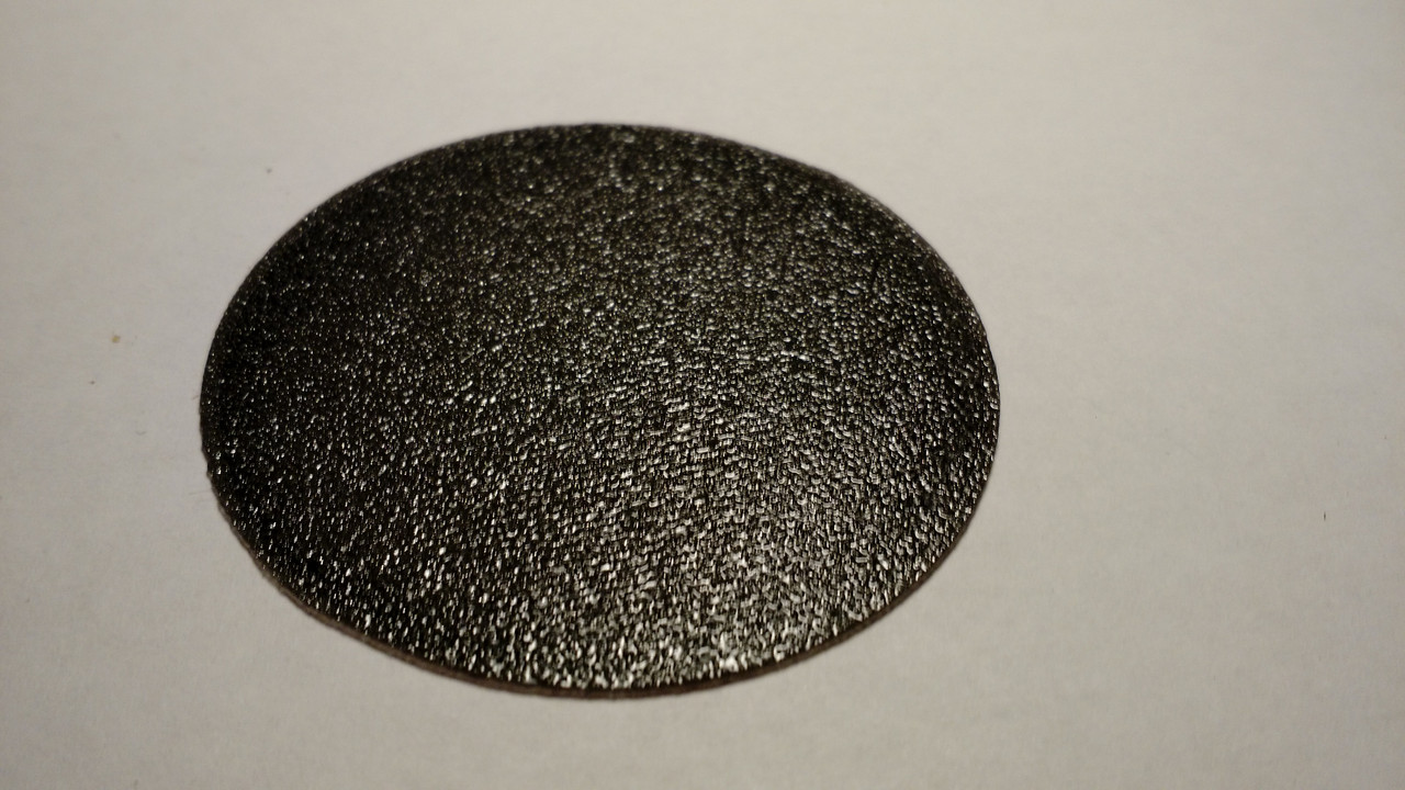

I have a terrible time telling what calibration images should look like. Could I get a comment on these? This is the 60 mm circle, two layers. Measured thickness at center is .043 mm. The rim on one side is rough and .073 mm. Could be why I am catching an edge.

RE: Need tips for light bar print not sticking
I don't use the textured sheets so I don't have any personal experience with them.  But good examples come on the printer: and in all those cases there aren't any visible extrusion lines in the texture.  I'm not sure what the Galaxy Black should look like, the Mystic Brown I used the sparkly filler would flow and make odd patterns and I expect the same of the black filler, so it might be that effect I am seeing.  Your prints look pretty close to ideal, but my impression is you could go a bit thinner, a bit more negative on Live-Z.  Not much, just enough to fully fill the texture - probably no more than another -25 microns.
My current setting is -1.090, not that that means much. It does show I spent a lot of time going thinner...
Any idea why one edge would be rough and raised? Seems like second layer is dragging at start.
A dirty bed will cause the PLA to lift ... have a look at this example. Bed looks spotless but since I had used alcohol on it I actually put down a nice invisible layer of oils ... and note how some of the edges are curling back ... and the second layer comes along and lifts most anything it touches.
