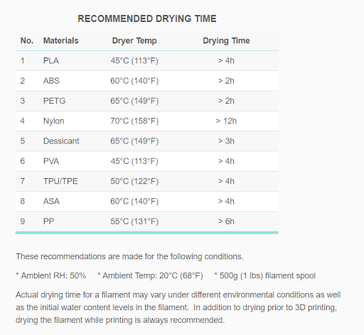

As I look at the photos it appears to me that your filament still had a high moisture content at the time you printed the example benchies, as well you did not mention what type or brand of filament you were printing with, this can be very helpful information when trouble shooting, as all types and brands are not created equal.
This is a list of recommended drying times from the Print Dry company, it assumes certain RH and Ambient temperatures.
you may be able to use this in conjunction with your dehydrator to improve your drying. In some areas and
with some filaments you will need to dry the filament as your printing with it, and of course ditch the swamp cooler
or move the printer to a controlled environment.
