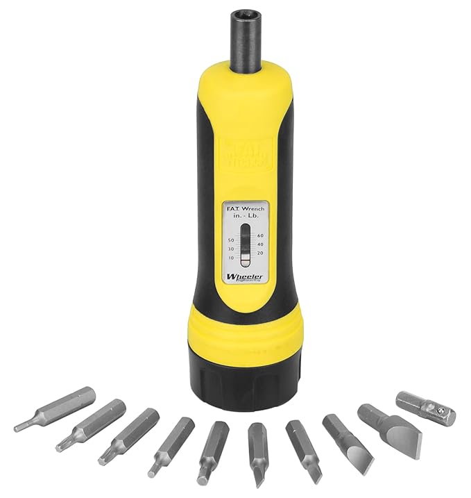

And a short note on how I used the Torque screwdriver in one of several places where SS 3mm fasteners are going into metal threaded items.
from assembly section 7 Heated and PSU section 17
I also used a 3mm tap here to clean out holes for these screws just on the basis of it being good practice to clean out threaded holes after a part is painted or powder coated. Also using SS locking forceps (or plastic kit builders locking forceps) to place all but the centre spacer where a tie wrap end was perfect for the job. I tightened all of them in the approved pattern with a torque screwdriver to 10 inch pounds and some guidance here on what PRUSA would like for a number would be nice… I would not want to go above 30 to 40 inch pounds with ss fasteners into aluminum threads with fasteners this small but even torque on each would seem to be what they are looking for.

Having these tools in my box made several steps easier that said I would not buy a $40 torque driver just to assemble a printer kit but it gives a person like me a bit of extra comfort when assembling things with delicate fasteners
