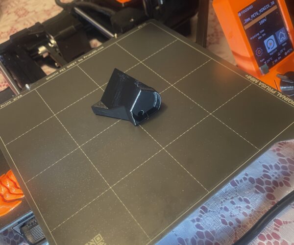

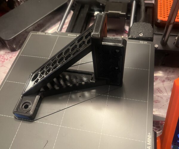

Oh it’s way worse I’m sure. Started at -1.545 and it would lay down a layer on the right side but stopped doing so moving to the left side of the plate. Now Z is around -0.650 or so maybe. But did recently add a Z axis foot it’s installed. Waiting on screws to install the Z axis brace.
The black prints are PETG and orange is PLA. Everything’s Prusament. Just got into the game last month. This mini is first printer. Still learning lots everyday. Thanks

Looks like you are moving in the right direction...
whilst you are waiting for the bits for the brace, you should be able to do smaller prints towards the back left hand corner of the build plate with the first layer print that you showed above.

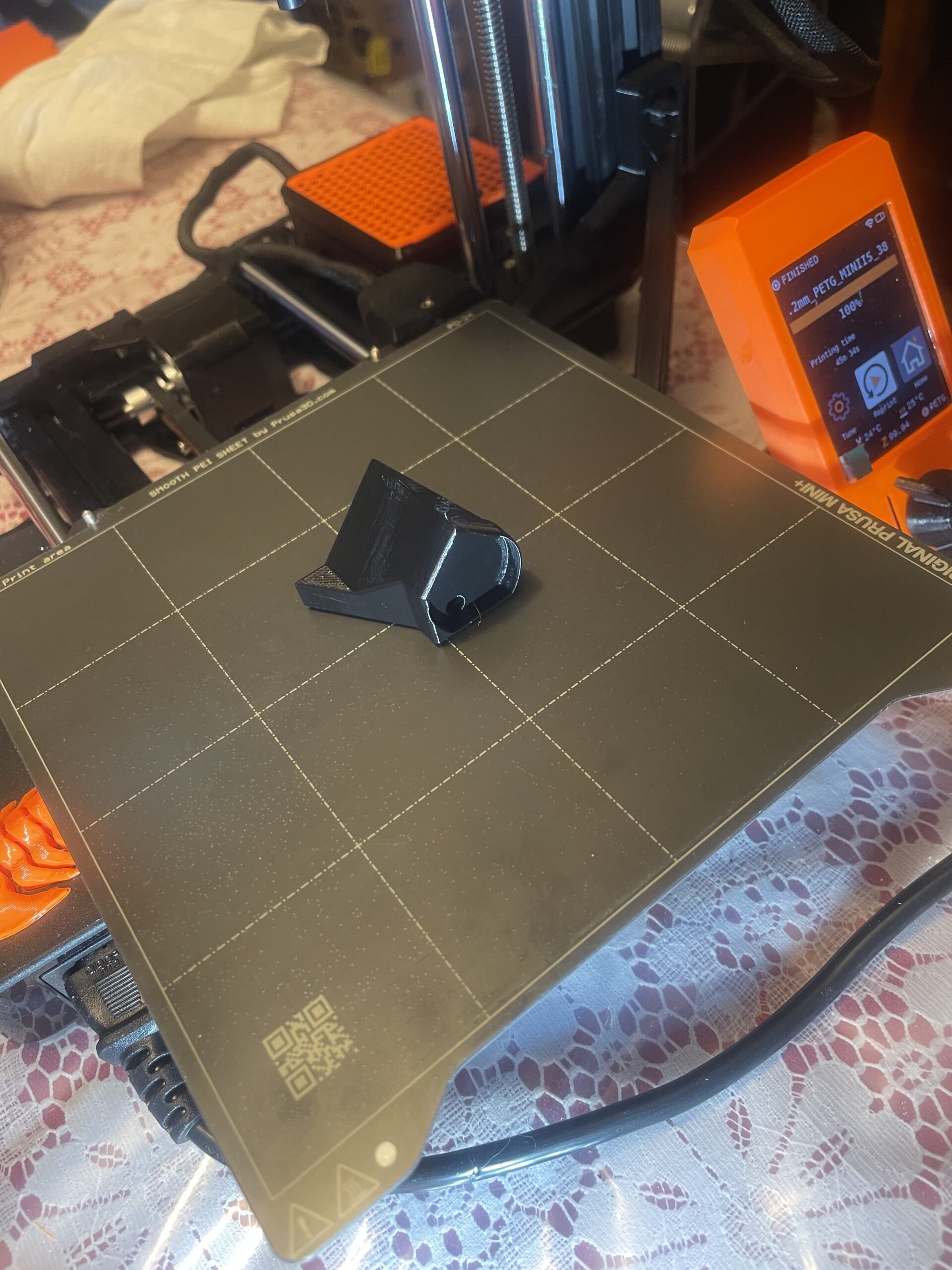

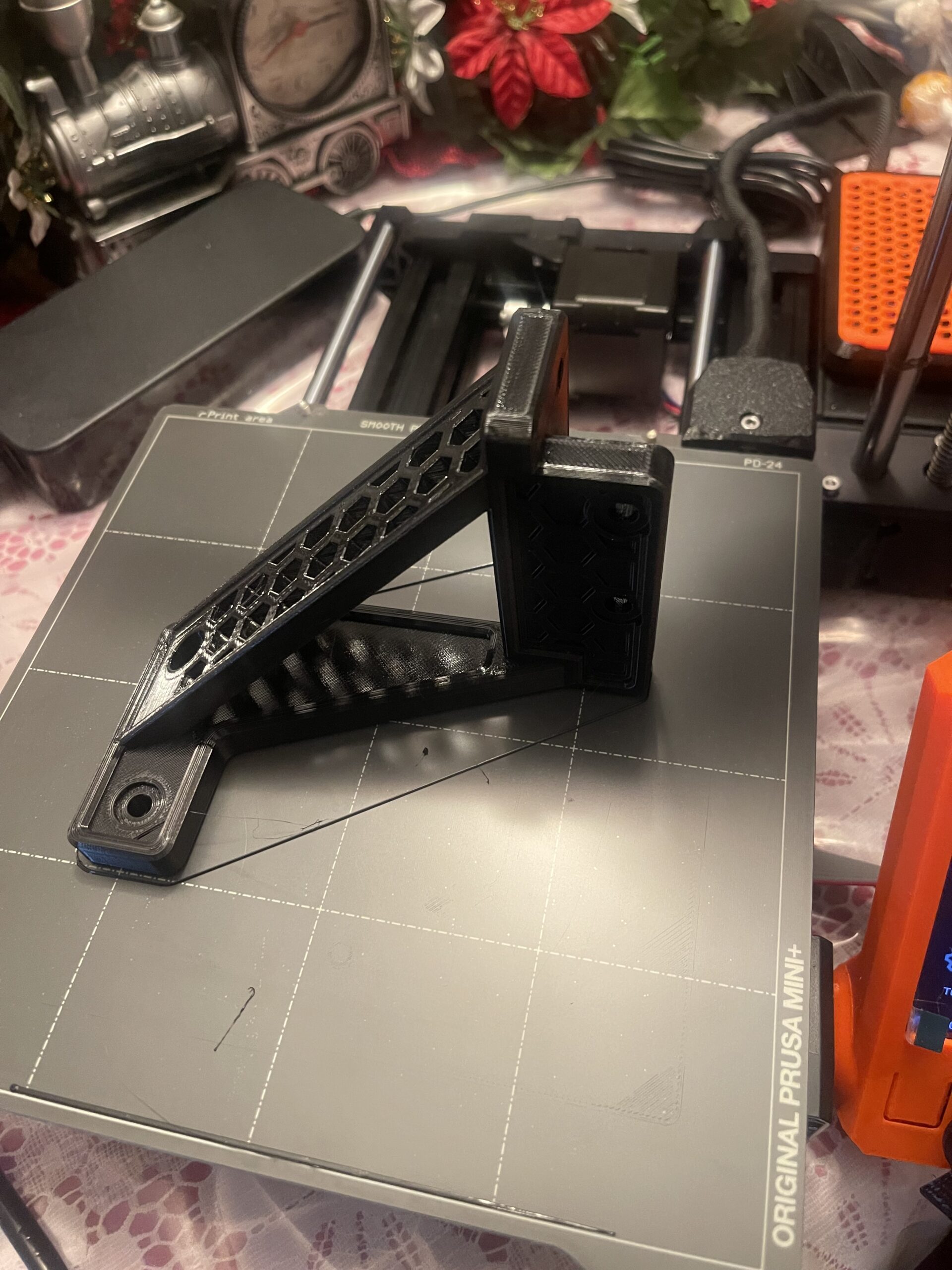

Did a 2nd run this evening switching over to white PLA. This happened. Any guesses out there?
