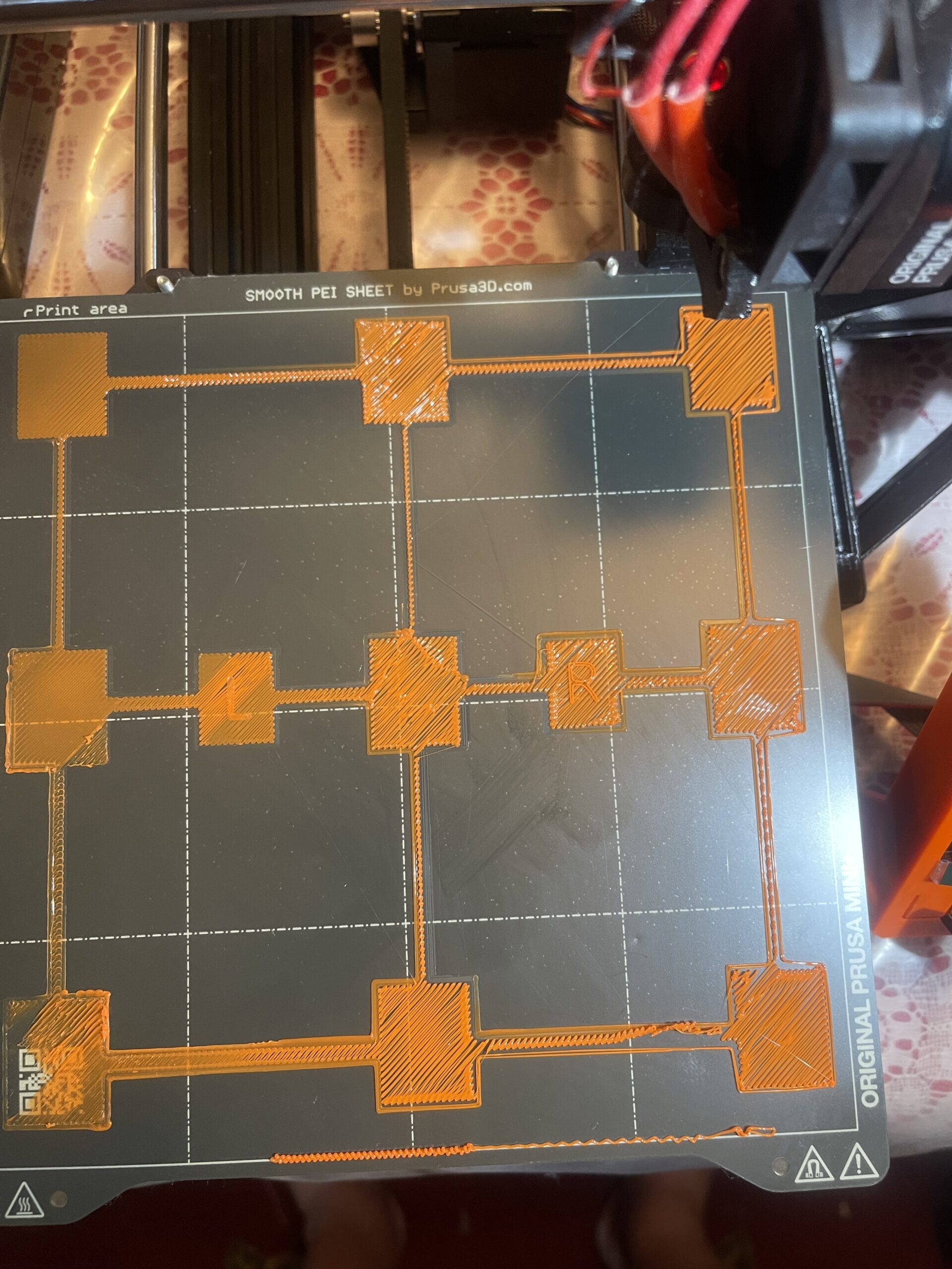

Top left corner is -1.300. I had slightly more separation at -2.000 before I reseated the sensor.
Okay while I can see this model makes it a lot easier than the zig zag I’m going slightly nuts trying to get my Mk3S+ to work. I got to -2.00 on the adjustment and was getting separation still on the model. I’ve reseated the SuperPINDA and redone calibration (and cleared my first PTFE tube blockage which was fun) and I’m still getting separation between the lines at -1.300 and starting to get worried about how close the nozzle is to the sheet (LED on the PINDA sensor is off)
Should I go back round and try to reseat the sensor again? After my most recent reseat of it I had to switch off and check again as the nozzle was snatching at the paper sheet (but not actually tearing it).
I have a resin printer so I’m used to having to do calibration prints and the like it just feels like all my adjustments haven’t actually done anything!

what do the test patches, look like?
I can't find my image, but this one may help (Note it's not based on the Mk3, but the pictures are representative. )
it's possible that the adhesion issue is due to poor adhesion, rather than wrong 'squish'
build plate cleanliness is also an important factor.
I Wash my build plate with hot water and dish soap. rinse with hot water and dry immediately with plain paper towels.
Posted : 23/09/2023 9:41 am

So to expand further I’ve looked at the first image you put up and it’s clear that the nozzle is still too high off the bed as there is a mini “waterfall” of PLA between the nozzle and the build plate.
Confusion I’ve got (which I really don’t understand) is that I set the XYZ calibration and the initial stage without the build plate I had to adjust the PINDA as the nozzle was “snatching” at the sheet of paper (held in place so it was flat) and when it did the last calibration (not contacting the paper) the PINDA LED flickers on and off (presumably working as intended).
It feels like once you get on to the phase with the build plate the z-axis is not coming down as low as without the build plate in place (PINDA LED did not go out until at least -1.000 live z adjust). Z-axis home calibration the stepper motors do “rattle” at the top. I’d almost expect the reverse and that putting the build plate in place you’re either closer to the plate or the same distance.
Using 7 by 7 grid and magnet compensation is on, PINDA LED flickers on and off as z-axis does measurements at this stage but as above with zero live z-axis the PINDA LED is constantly on, checked PINDA operation in the LCD as well as described under the troubleshooting article and behaves as described. Standard smooth plate, nothing fancy.
Posted : 23/09/2023 11:13 am
RE: life adjust Z - my way
-1.000 Live Z is OK.
the pinda thread is 1.0mm pitch, is you wish to reduce Live Z, you could reset live Z to 0.000 then unscrew the pinda (Move it upwards ) Half a turn, and re test Live Z,
After raising the pinda, half of a turn, the new live Z should be in the region of -0.500mm
please be aware that the live Z for a smooth build plate will be a larger negative number than the live Z for a textures or satin, build plate, because the smooth build plate has a layer of double sided adhesive and a layer of PEI on top of the steel, whilst the textured and silk build plates, only have a layer of paint on top of the build plate
Posted : 24/09/2023 9:10 am

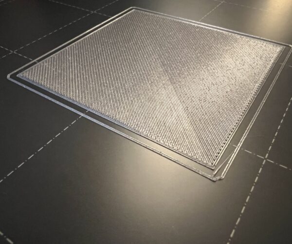

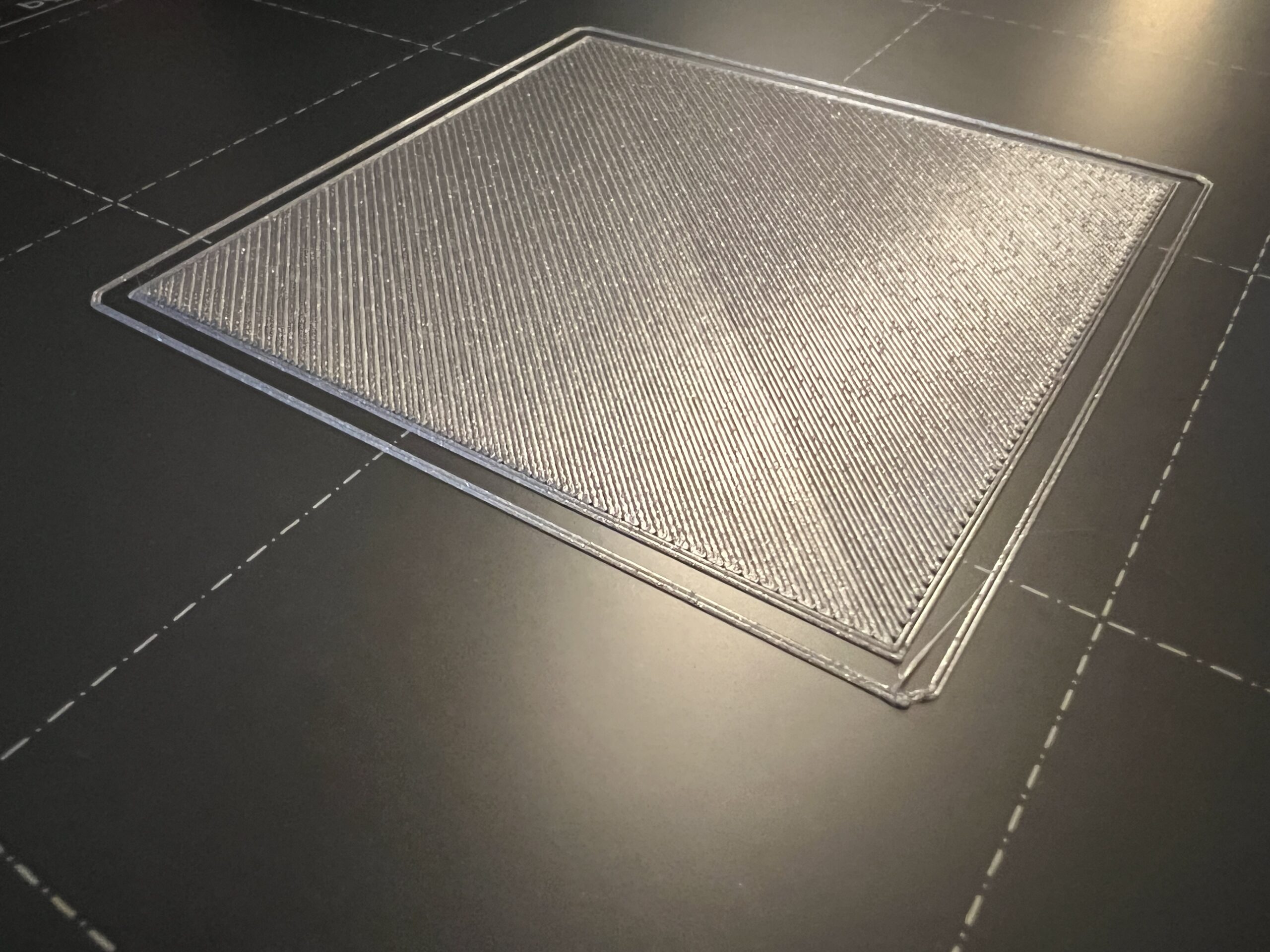

Finally feel like I’m getting somewhere. This is -1.700 on the right and -1.750 on the left but looks a lot closer than it was.
Given Joan’s feedback above about the different build plates I feel I definitely need to move the PINDA again as I’ve got a satin coat plate to setup as well.
This is a lot better method than the zigzag pattern I feel but I’m as worried about extruder hitting the build plate as I was worried about a mistake in resin setup piercing the FEP!
Posted : 26/09/2023 7:47 am
