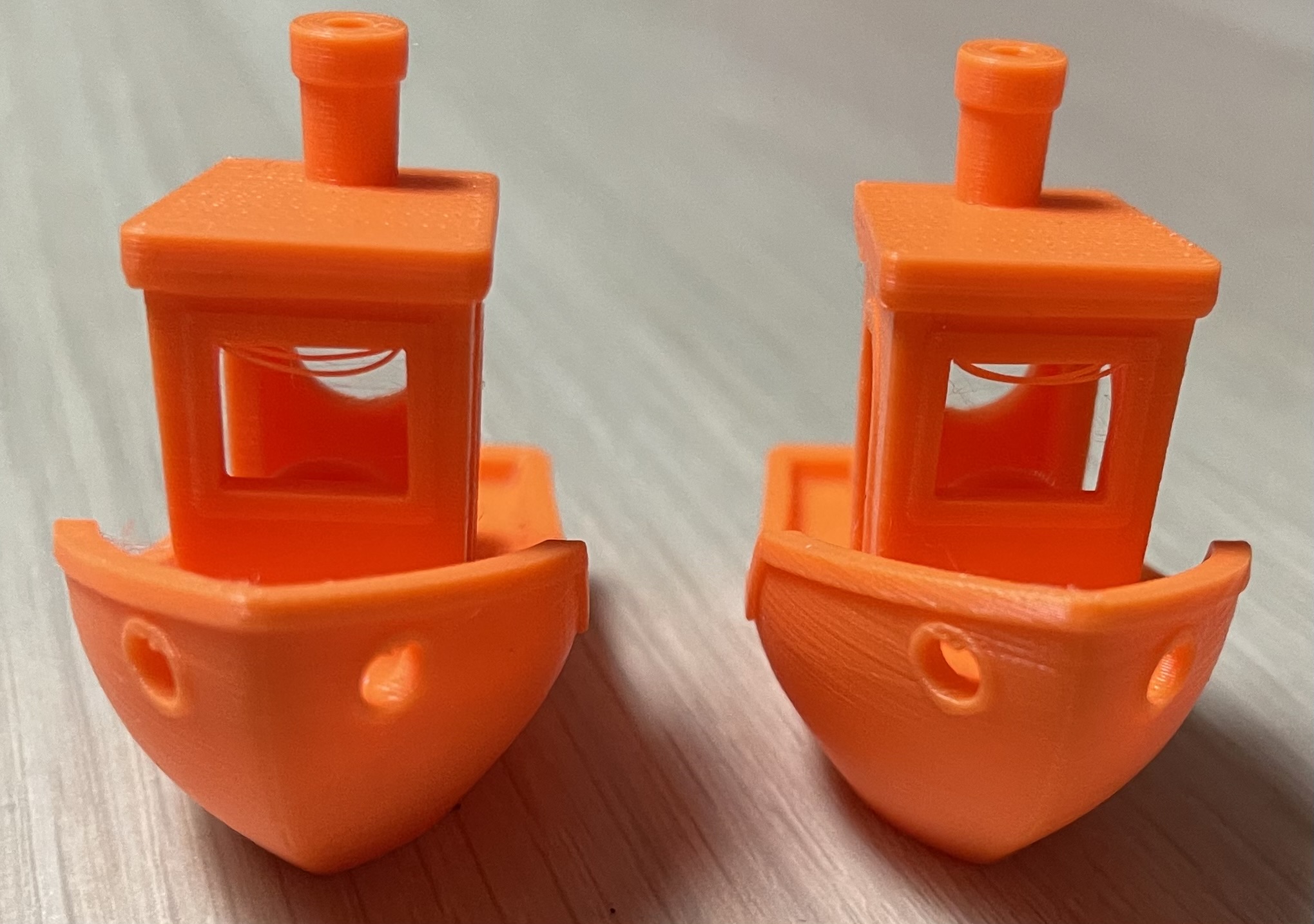

I'm having trouble with what I think is called 'bridging' on open spaces 3DBenchy.3mf
You can also make out a bit of sagging in the small port hole.
The boat on the left was printed at 215°, the one on the right was 200°. I'm using eSun PLA+ which is a brand new roll.
Any help would be appreciated.

I would try more part cooling if PLA behaves like that.

How would I do that?
The printer is not in an enclosure, the room temperature is around 17°C and the bed and nozzle fans are 100% on throughout the print I believe.

I wonder if your fan is dying. Can you video your front fan on full.
Check the fans are clean first.

Thanks for you help. Ive cleaned both fans, there was only minimal dust to be honest and reprinted.
Both fans were running at 100% throughout the print. I've attached a small clip of the printing. Filament was e-sun PLA+ and the temperature of the hot end was 200°C

Are you sure that was 200c? Seems hot

200 degrees isint hot. I print esun pla+ at 215.

I'm assuming you're talking about the temperature of the hot end being hotter than 200°C . If so I'm wondering that too. The display shows the hot end at 200°C and the initial tests passed so I thought all would be ok. Is there a way to calibrate the temperature of the hot end?
I purchased the printer second hand, it was purchased originally in kit form and since I've had it I have found a few issues with certain things that I have now corrected. So I'm wondering if the temperatures have not been calibrated from the start, or is there other things that would cause the temperature to be read incorrectly?
No easy one. But have you tried a temperature tower? Starting from the recommended high point going down to at least 200°C. If it cloggs at some point 5°C above that point would be the absolute minimum I'd recommend. Look if all of the temps look somehow too hot on the tower.
Regarding sagging bridges. At which speed are you printing the bridge? I found that depending on the filament both, fast or slow can be valid strategies. I'd try both and see what works best. Or better a few speeds for bridging (all at 100% cooling of course): 20, 40, 60 and 80 mm/s for example.
