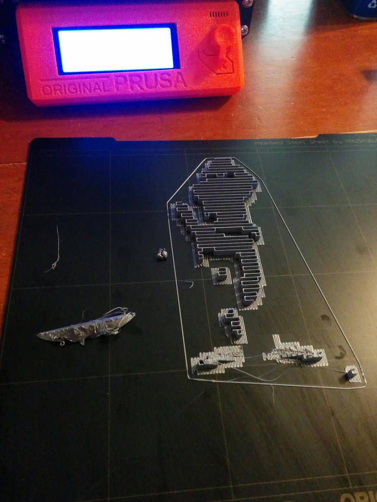

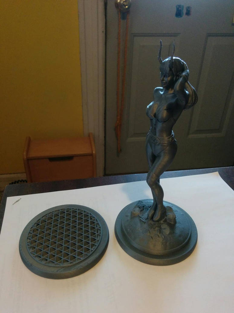

Here is an image of the first two times I tried the print:
The disc on the left looks fine. I don't see any problems with the printing--the printer just stopped at some point and crashed into the right side of the X axis. I went through the complete setup process again and redid the G code, then did the second print (on the right). It has some problems (I think the gashes on the chest are places where the support6s were touching and transitioned badly) but I'm pretty pleased with how it turned out. The only difference in the two files was that the second was set for 10% infill rather than the default 20%.
This is one where I tilted the model on its back so that I could try to print it at a larger size in the build volume. It was printing supports and part of the base, when the extruder glommed on to the base, lifted it away from the supports, and then shifted to the right on the X axis and started printing in the air until I stopped it.

Re: intermittent X axis crash
Well, I doubt the model in the upright position really needs supports. It looks like it was designed with 45 degrees in mind. Laying the model down is a bad idea because it will bring all sorts of FDM limitations into play. Best to keep it upright and cut it at the mid point, belt, etc. And glue the two halves. It works better than you'd think.
I suggest you keep printing and assume the garbled crash a one off event. But for your own sanity, keep the filament sensor off.
More on low angles: when printing a part that has supported or unsupported low angles, like a body laying prone, edges down wind of the fan aren't cooled well and will curl unless you slow the print down, a lot. The curl will add until it can catch the nozzle and it can break the model loose from the support. Had it happen many times. Also, print quality suffers when printing over a support, or even just printing low angles. The printer just can't print overhangs as well and the underside surface will be distorted. Try printing a ball, and look where the quality seems to jump from rough to smooth. It is the transition where the overhang becomes well supported by the prior layer. Overhang test models will also show this FDM limitation.
