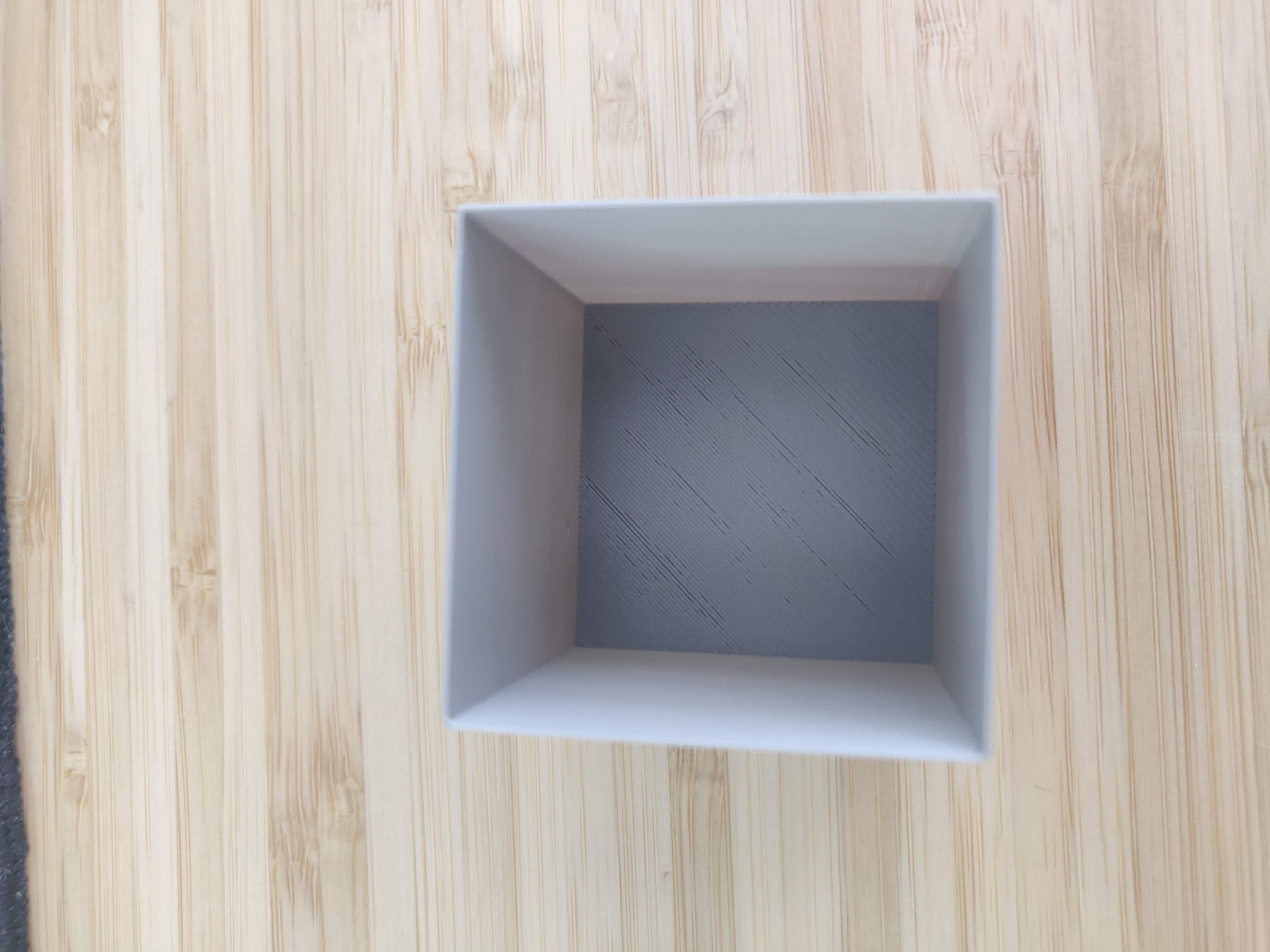

I have a Prusa Mk3. I recently switched out the entire assembled hotend. I am now having some issues with printing.
Here is a quick test print as an example.
First layer:
Post image

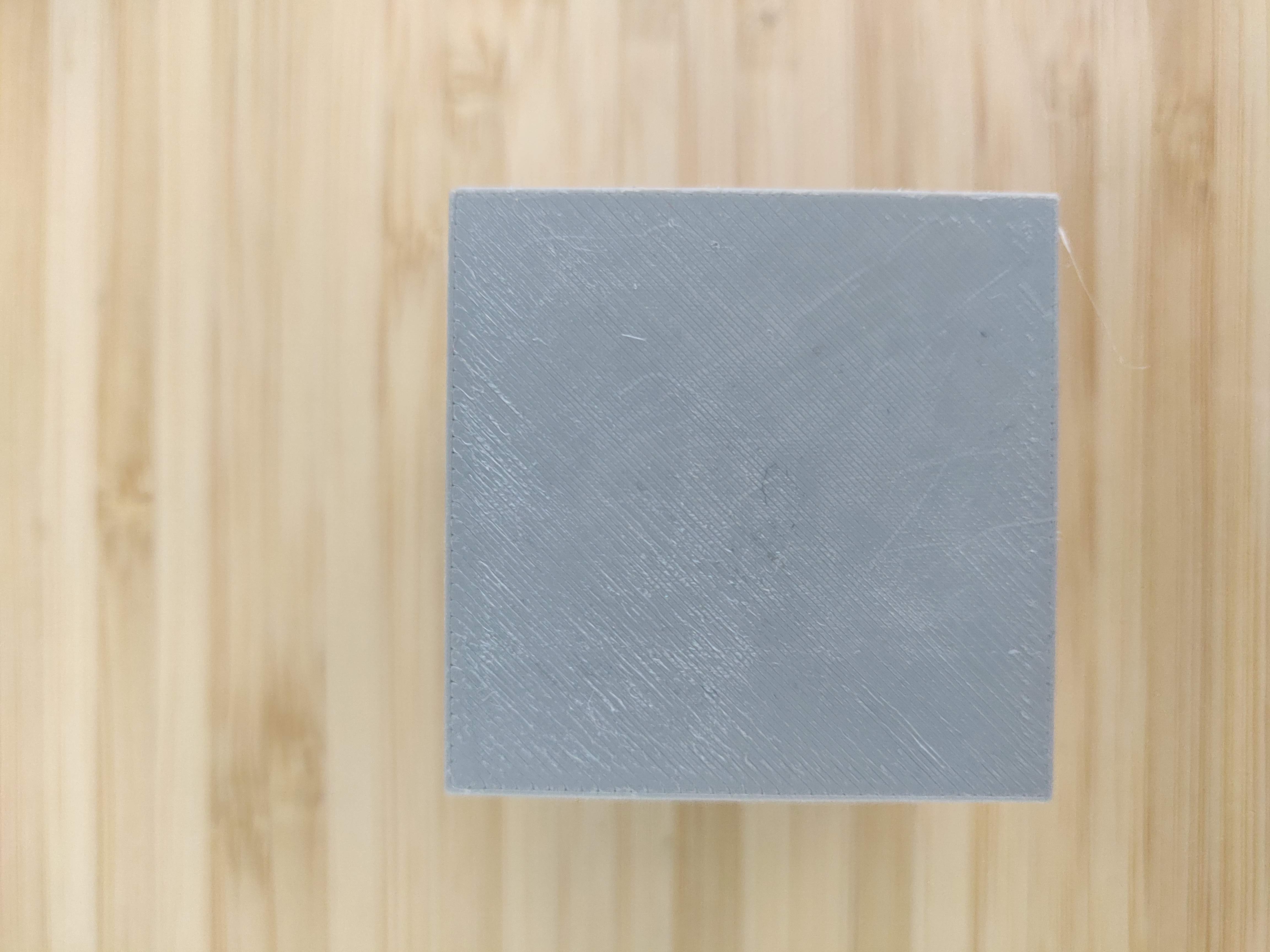

What the top layer looks like (this is after about 3 or 4 layers I believe):
Post image
This is happening for all models. It's like as soon as it hits the second layer, some parts of the filament aren't just sticking to the first layer.
This is happening also with g-code files that I have successfully printed with my previous hotend with no issues at all.
Could I get some help with this?

My guess would be that filament isn't supplied fast enough.
I assume the print speed for the wall is much slower than that last bottom layer?

But this doesn't explain why it would work before the hotend replacement. I've tried using the same gcode files that I have printed correctly with no issues from before the hotend replacement.

Did you recalibrate PID for the new hotend thermistor? PETG likes making crumbs and can degrade with moisture. Just thinking of things that can change over time.

It's recommended for any hardware changes such as hotend replacement. I'd put it in the "should be done" category, do it, then see if it helps. I'd also try another filament, whether PETG or another material, to make sure the problem is really with the printer and not just filament characteristics. Again, filament can absorb moisture which will impact quality.
I'd also try some smaller prints to help pinpoint the issue more quickly. That under-extrusion on the 2nd layer may indicate you need a bump more heat for the filament, or you might just have a partial clog. Raise Z to max, heat up the nozzle to print temps and examine the filament flow as you extrude a length of filament. Does the filament flow evenly and coil loosely under the nozzle, or does it come out irregularly or at an angle once the flow starts?

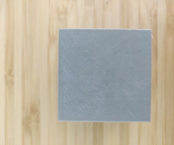

I tried with a roll of PLA filament. I'm getting similar results.
First layer
Same looking under extrusion on top layers.
This PLA print was printed at 225 degrees. I printed it a bit hotter than what I typically do PLA at. It doesn't seem to be a temperature issue.
When I raise the extruder and load filament, it looks like it comes through pretty evenly.

Petg is standard, first layer 240 and de rest of layers 250.(and you can try with  a higher temp 260).
Do you have enough tension on the 2 springs of the extruder?
