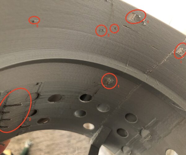

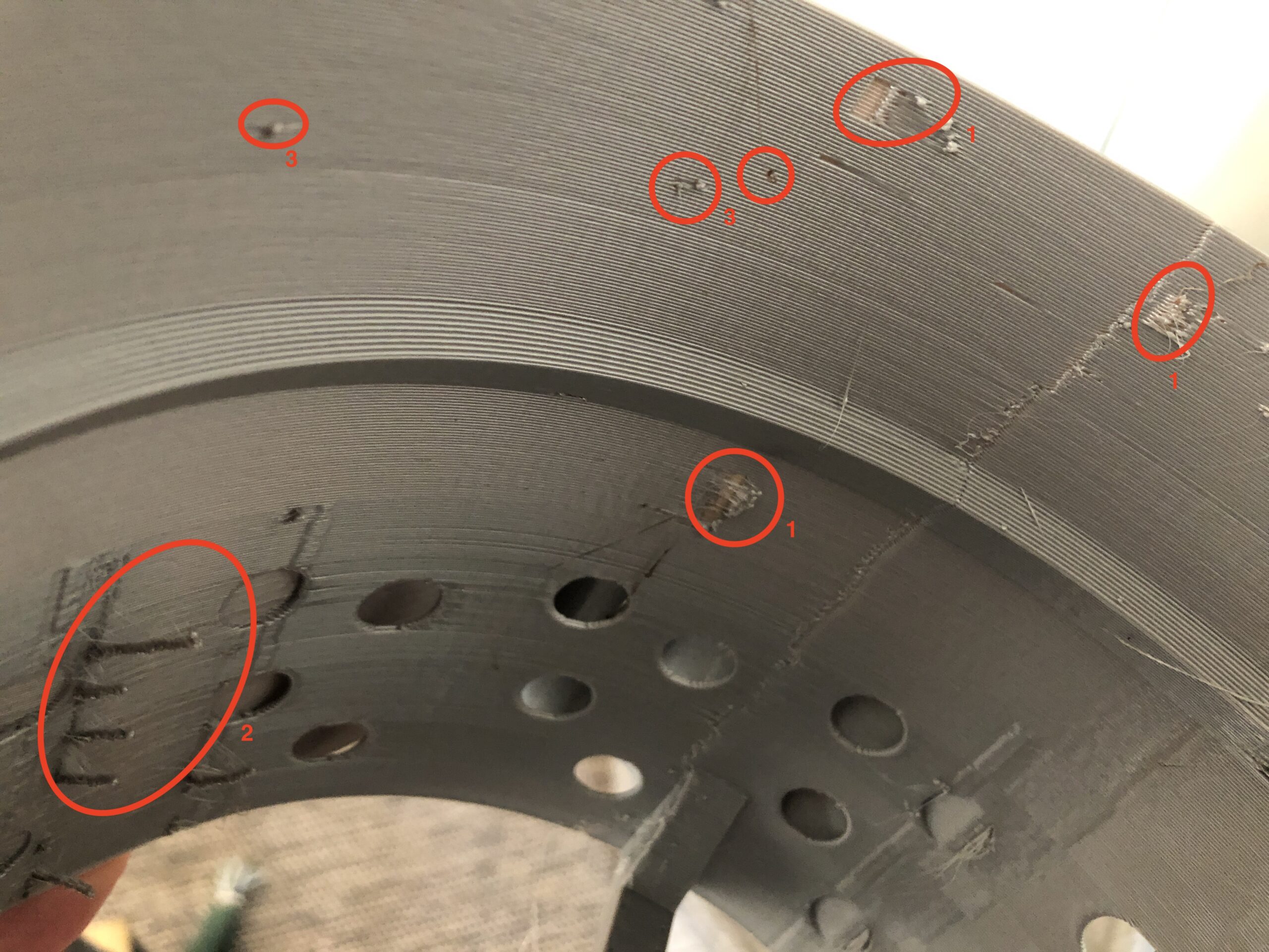

0.6mm nozzle, bad quality, what is the root cause?
I have owned a Prusa i3 MK3s for few months now and since most of my prints tend to be large and useful, I wanted to speed up the prints a bit.
So I swithed to a 0.6mm nozzle instead of the default 0.4mm. During the same time I change PrusaSlicer to 2.5-rc/alpha/release whatever have the new arachne engine. And since the switch, my prints have looked like this:
Material is PETG. Print settings are 0.4mm DRAFT. And I usually see there three types of symptoms
- Certain spot, on many layers, looks like few millimeters of line is missing. Where did it disappear? Why is this happening on exact same spot on many layers?
- Spikes of material pointing out. These are not part of the model.
- Small blobs on random places.
Can someone help me to find root cause for these? Is it all caused my 0.6mm nozzle? Or new 2.5 Prusasclicer? Or PETG stored badly?

Image disappeared somewhere. I'll try to re-attach it here.

I doubt it's the underying cause but dampness is compounding your print errors. Dry your filament and show us what issues remain.

Also, I believe you have the correct profile and nozzle size selected, that‘s not it either.
Before you start changing settings like retraction etc. you should rule out damp filament and leaking hotend as probable causes… Not uncommon after a nozzle change.

What layer height are you using? I had a very similar issue with 0,4 mm nozzle and using a too thin layer height. If you use 0,6mm nozzle then ideal height should be 0,3mm.
On the third picture you can also see that the outer perimeter is not consistent. The overall look of the surface is not smooth.
