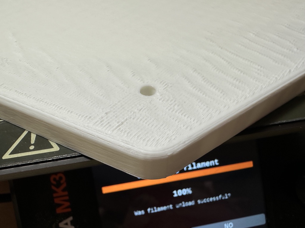

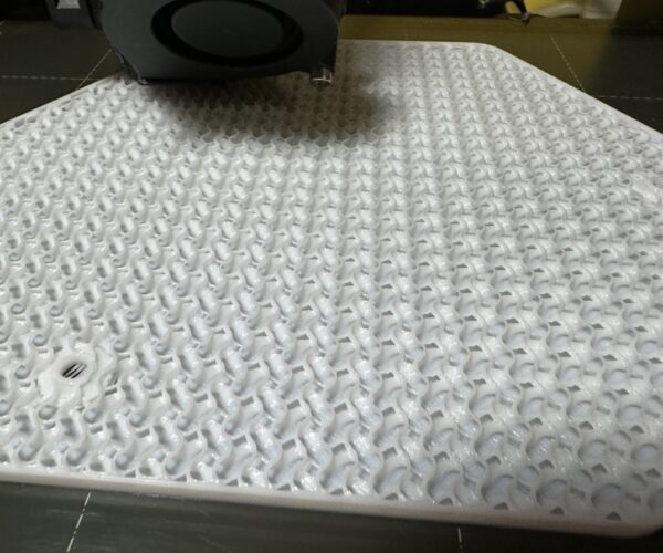

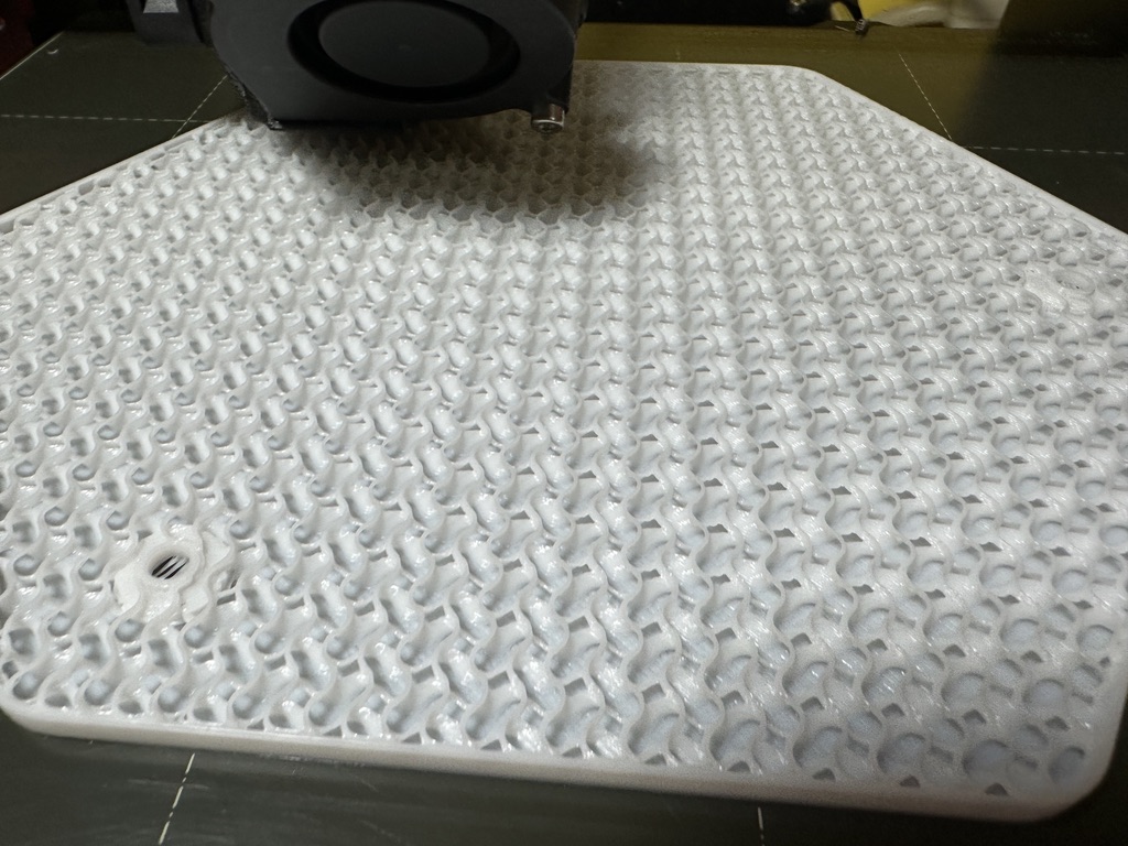

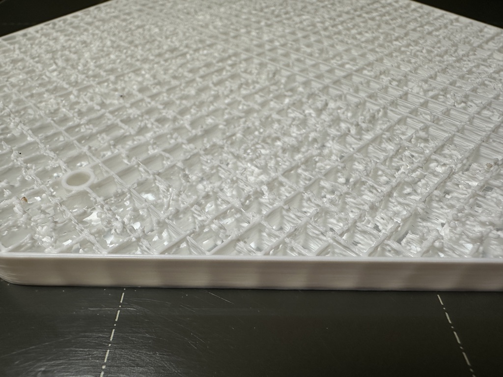

Even when prints turn out mostly decent, I'm having issues with the filling coming out evenly:
I find that I can change the infill type and that issue often goes away:

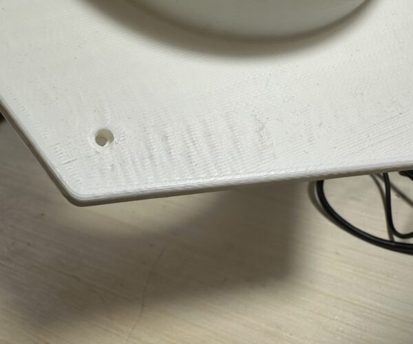

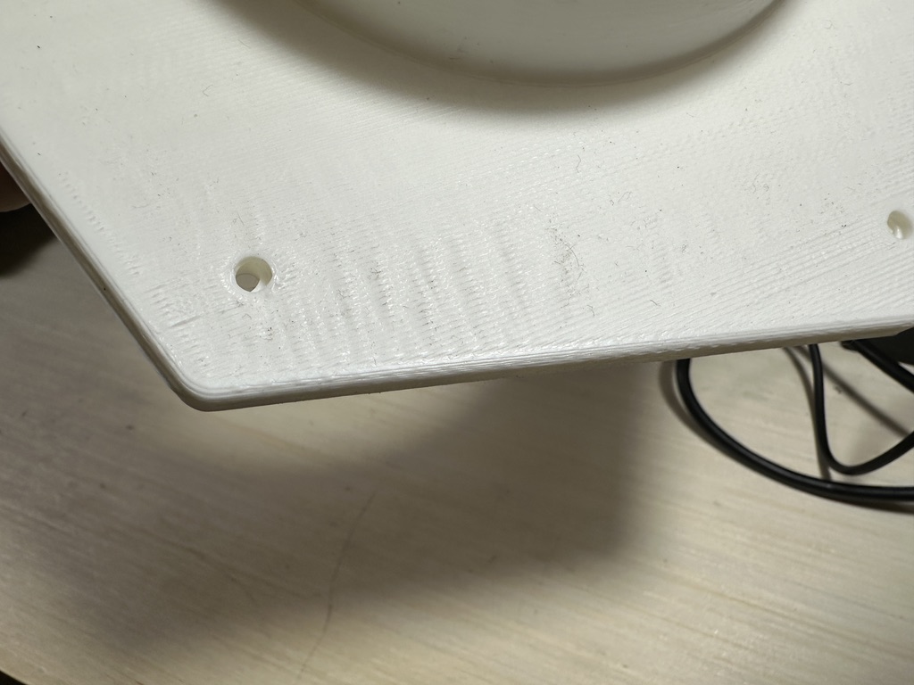

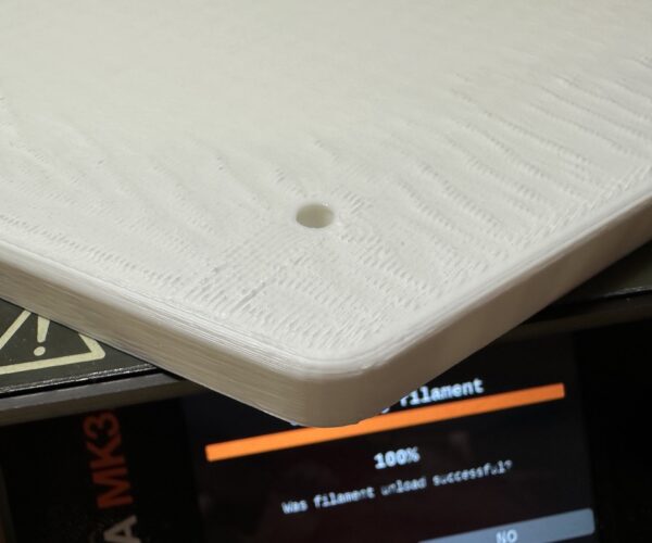

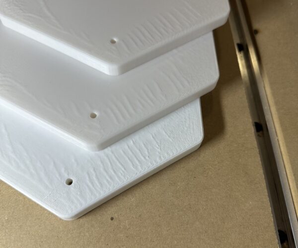

However, what I find interesting is that I'm having an issue where there are rough waves on the top layer, in the same areas where the infill has not come out well:

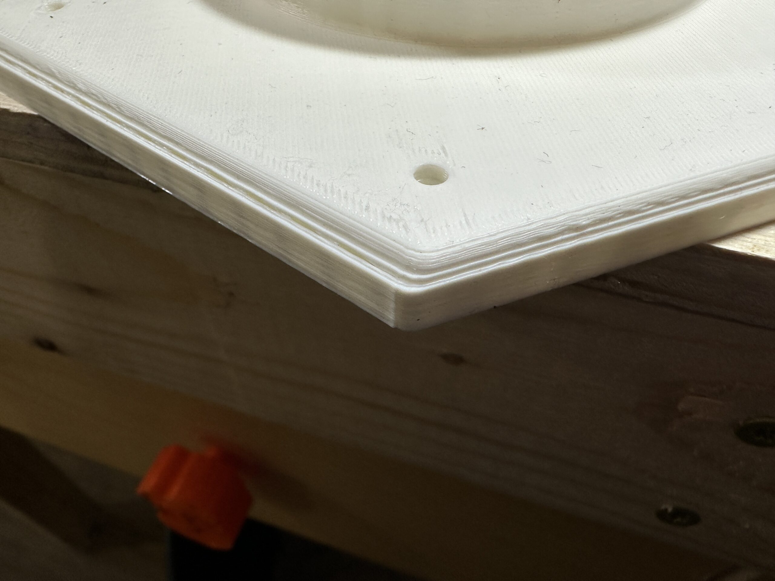

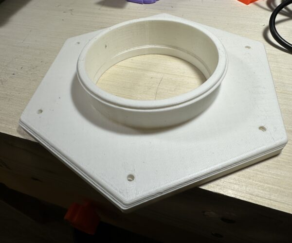

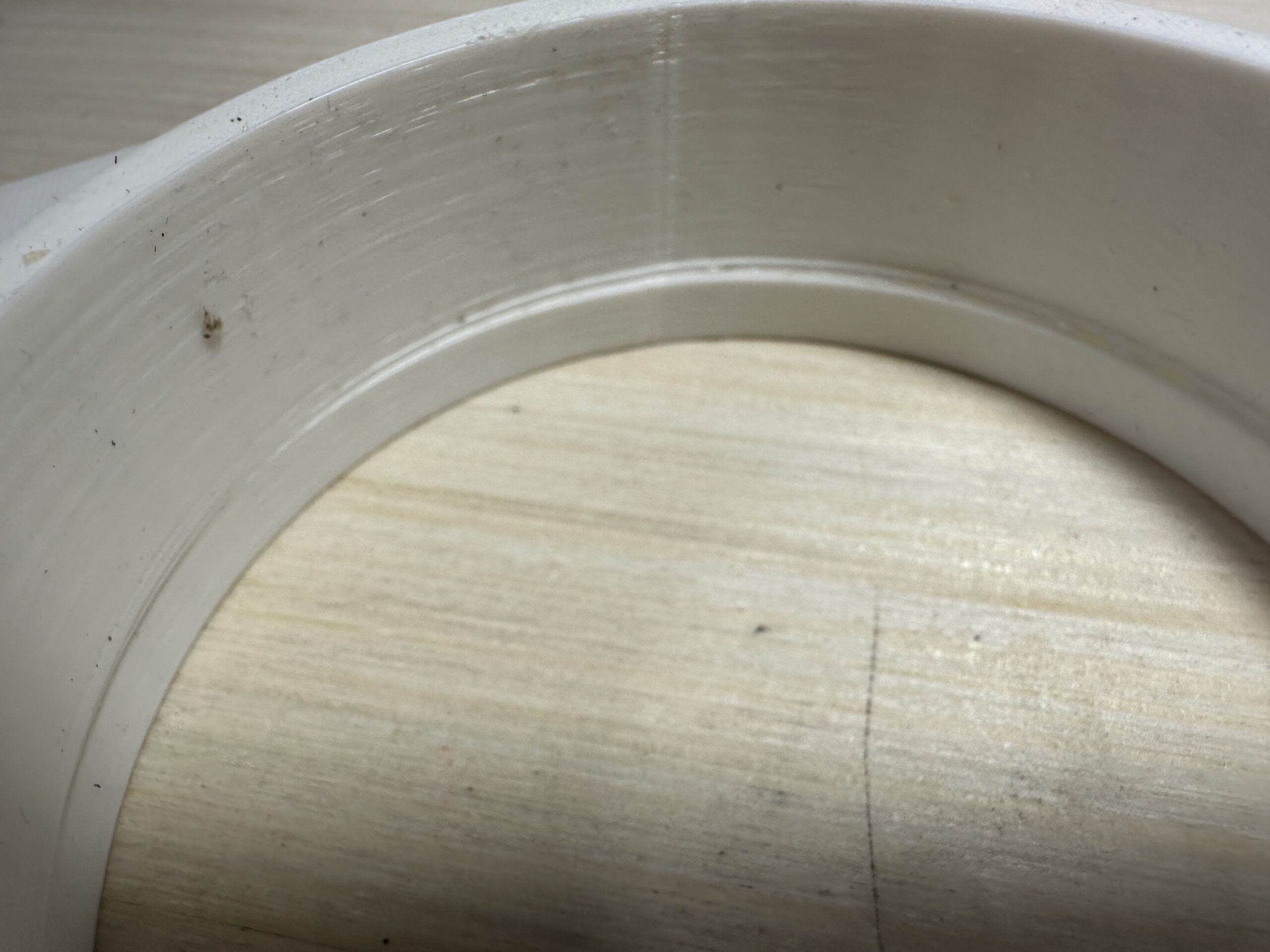

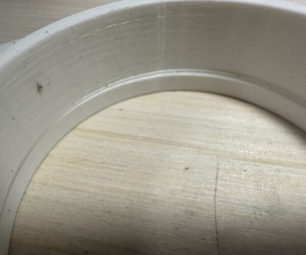

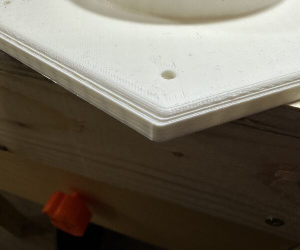

Then, for the past 4-5 prints, I've had problems with an axis shift. It's small and always the same amount and at about the same layer in printing:
What's odd is that I've had this issue multiple times and always at the same layer height (give or take a layer - hard to tell for sure, since I'm usually not able to be at the printer while it's printing.
I'm sure the layer shifting is relate to the Y axis belt, and suspect the rough spots are due to an uneven tension in the belt, too. I've looked over the belt and I don't find debris in it or dirt. I've checked for obstructions, since I've recently done the 3.0->3.9 upgrade and that included doing more cable routing and I've changed my OctoPrint systems from one Pi4 to a Pi Zero 2 W on each printer, so that meant some new cable routing, but I've checked to make sure there's no cables that come near the drive belts or could create a problem with movement.
Could my issues with infill and the rough waves on the top surface be part of this? What else can I do to deal with what seems to be a y axis issue? I do have a long loop of the same type of belt as used on the X and Y axes. I was thinking of just trying to loosen the Y belt by one notch where it's anchored to the print bed, then adjust to tighten it again. Also, I notice that when the printer is not working and I can manually move the print bed, it doesn't seem to run into obstruction of movement.

First deal with the warping, it might not be causing your issues but it's may be masking the causes and contributing to the shifts.
So: clean the print sheet, add brim and make ure you aren't printing in a draft. I presume you have cleaned and lubricated your smooth rods?

Good point. My thought was that if the belt is having issues, it could be causing the warping, but you have a good solid point.
Ah - cleaned 'em and forgot to lube them recently. Now that I think about it, it's been a while. Got into the habit of cleaning and not lubing them. The print sheet is clean and there are no air vents and nothing that feels like a draft there. The work I'm doing now is part of a ventilation system that'll let me put vent hoods over my printers and my CNC system (which produces smoke when the laser is used). That'll help me make sure there are no drafts (and if I'm using ABS filament, I can vent the printer enclosure when the print is done).
I'll do a clean and lube of the rods tomorrow and I have a 2nd print sheet and I'll swap it out. (Which means recalibrating the Z offset again, but that's not a big deal since I went up to the MK3.9 and it prints so much faster.)
