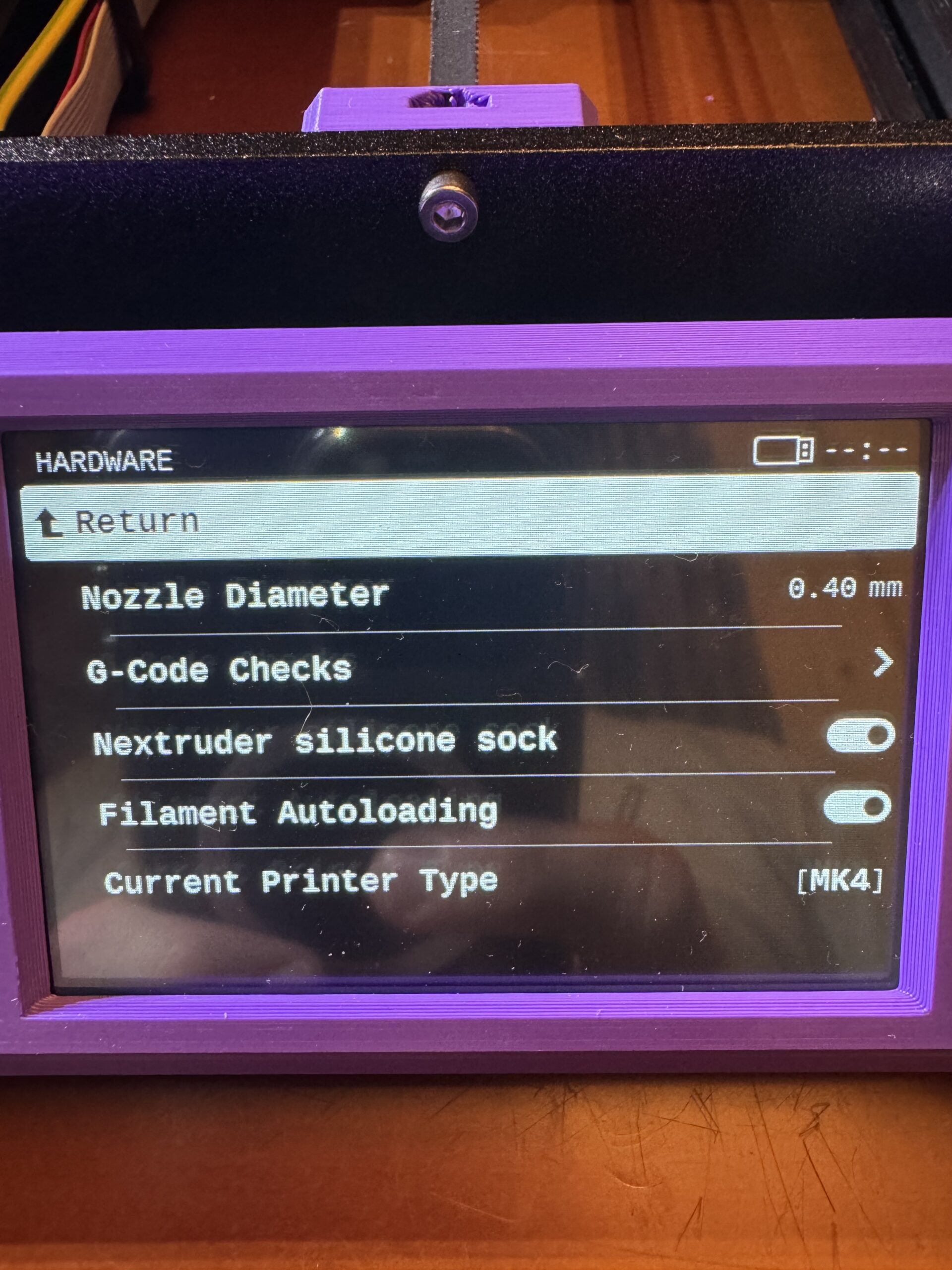

Thanks to both myself and our kid being sick this 3s-> 3.9 got delayed. But that let the wire adapters get here and so last night my MK4 came to life thanks to the motor swap
booted, ran tests (used the dental tool tip for the y axis test issue) updated firmware and it always registered as MK4  fun experiment
now to attempt some shorter custom wires like mentioned as the clickmate precrimped ones got here too

Thank you for the tips. This worked! Just a small item on the Y axis left rod in the front allowed the Y axis test to pass.
I "factory reset" the settings of my printer and went through all the tests with my new MK4 z axis motors... it still shows up as 3.9 though. What am I doing wrong?
Posted : 08/06/2024 10:08 pm
WarezMonkey
(@warezmonkey)
RE: Mk 3.9 with MK4 Z Axis motors.
Never mind, I was dumb. I thought I just needed new Z motors to go from 3.9->4, but I also need new X and Y motors 😛
