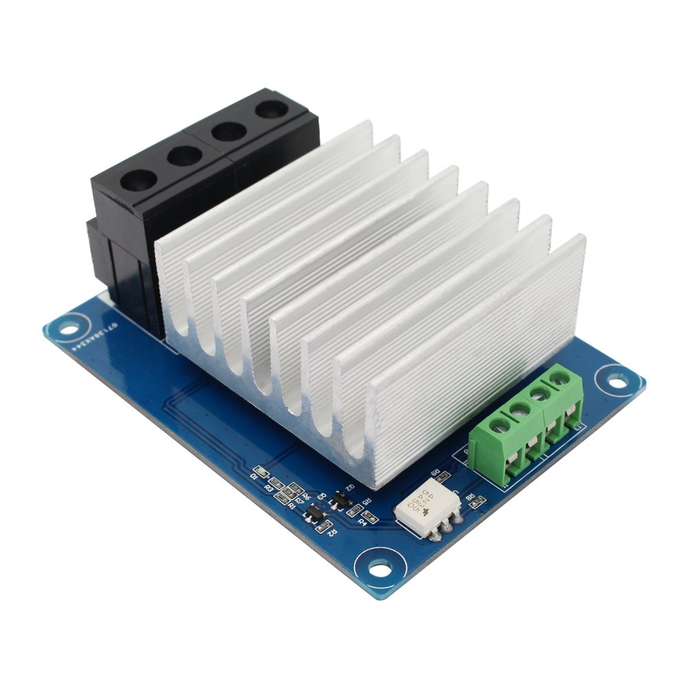

The MKS MOSFET I found is huge, is this all there is?
Did a CAD layout and it takes up the entire space under the RAMBo cover. I'll be going Volcano soon and wanted to get a pair but there no space under there. I saw little MOSFET, will they do or are they not worth the trouble?
Sorry about the huge images, these are from Amazon.

I'm not an electrical engineer and was hoping a more senior member of this forum could correct or input but just off the cuff logic tells me running a MOSFET directly off heatbed output off Mini-RAMBo IS a MOSFET working a MOSFET. Mini-RAMBo doesn't seem to have a heatbed bypass signal pin or Ultimachine tech would have said so. Since signal routing on an Arduino MEGA based board is one firmware line change, that is what they recommended. Presumably, this firmware change routes signal away from internal MOSFET to 5V signal line used on "digital" MOSFET types such as the big brick in photo above. This would mean the high speed binary signal managing power thus heat of bed goes directly to off-board to MKS MOSFET instead of on-board MOSFET and subsequent stress and threshold lag. Does it matter for 11.6A draw of the MK42 heatbed? Probably not, but I'm seeing if a second 12V power supply will double heatbed warmup speed as being reported on the interwebs.

The problem is that when you connect directly to an ATMega output pin, you have to ensure that you can't draw more than 50mA otherwise you will blow that output.
Personally I would connect to the bed output, simply because I would not trust an add-on of this nature to do no damage...

If you signal the MKS MOSFET via "digital" input, which is optimal as designed, you're trusting the manufacturer of said fet to pull no more than signal which I have just learned is max 50mA. 💡 😉 If not, MiniRambo's Atmega2560 or Atmega32u2 will get fried because there is no circuit protection on P3 pin outs. OK.
Right, the analogy. Isn't running MKS MOSFET off Bed out on a MiniRambo like running a dyno on a car running on the flatbed of a semi to control the throttle of the semi? Or, more straight forward, why send all that power out just to get a fraction more when one (me) was trying to stop roughly 12A from leaving the MiniRambo in the first place? Am I to conclude, that the receiving MOSFET gate is NOT taking 12A of power even though that is what the MiniRambo is designed to output on Bed Out line? If 12A is being pushed to MOSFET gate, doesn't that power have to go somewhere?
Also, MKS MOSFET gate gets fried, does it get stuck on, short the input and/or power, or just become a metal sculpture? As any modern MOSFET is the N-channel enhanced type, the assumption is the MOSFET will disappear from the circuit when fail. Right?

Just imagine a simple switch instead of MOSFET. MiniRambo does not push anything anywhere. It simply switches input power to heatbed on or off. The only problem is that the current going to heatbed is quite high (nearly 15A) and causes unwanted heating of MOSFET integrated on MiniRambo (less) and heatbed connectors (more).
By attaching external MOSFET you make the current go outside MiniRambo, which in that case does not switch 12V to heatbed, but only to external MOSFET.
Simple, no rocket science.

As I'm very curious about electricity and circuit design but am a specialist in user interface and some education in industrial, transportation and entertainment design, 3D printing is more a very exciting hobby for me. Let me try to rephrase in my own words. Internal MOSFET closes the circuit on its end via internal "logic" signal. As a closed circuit in on-state, power draw is dependent on resistance found on circuit. In this case off-board MOSFET should only call for enough to trip it's own gate. At that point, all amperage is handled within the wires of off-board MOSFET. Therefore, neither MiniRambo processor, internal MOSFET nor bed-out terminals see anywhere near amperage to be of concern as is the case for Search: "toasted terminal". Is that what you mean?
So, my desire to offload internal MOSFET is more a risky and unnecessary effort considering firmware flash annoyances and also potentially damaging processor via pin 84 logic sourcing over draw. Considering neither MOSFET in this daisy chain will ever need to signal past 1MHz (MOSFET performance breakdown threshold), there is zero point in driving external MOSFET via logic aka digital input unless my 3D printer happens to have digital out only design (MiniRambo doesn't). Did I get you right?

The power draw will depend on the "resistance" of the device receiving the power, so the output of the RAMBo will pass only enough current to turn on the external switch. And there will be no burned connectors on the RAMBo.
