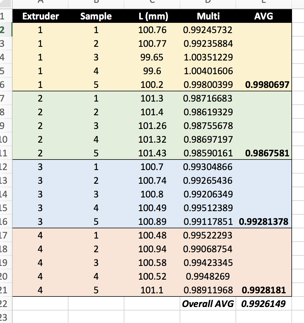

I can't get a decent print now...
I replaced the bed, redid the XYZ cal and reset live zero. I also replaced the PTFE tube in the MMU hot end as I had crushed the one in the kit with a new one from PRUSA.
Someone suggested I check the extrusion I was getting - because it seems I'm not getting enough material. That's fine (see pic) the problem seems to be a big lag in the start of extrusion.
I think that's fine... I changed my multiplier in slicer to the avg.
