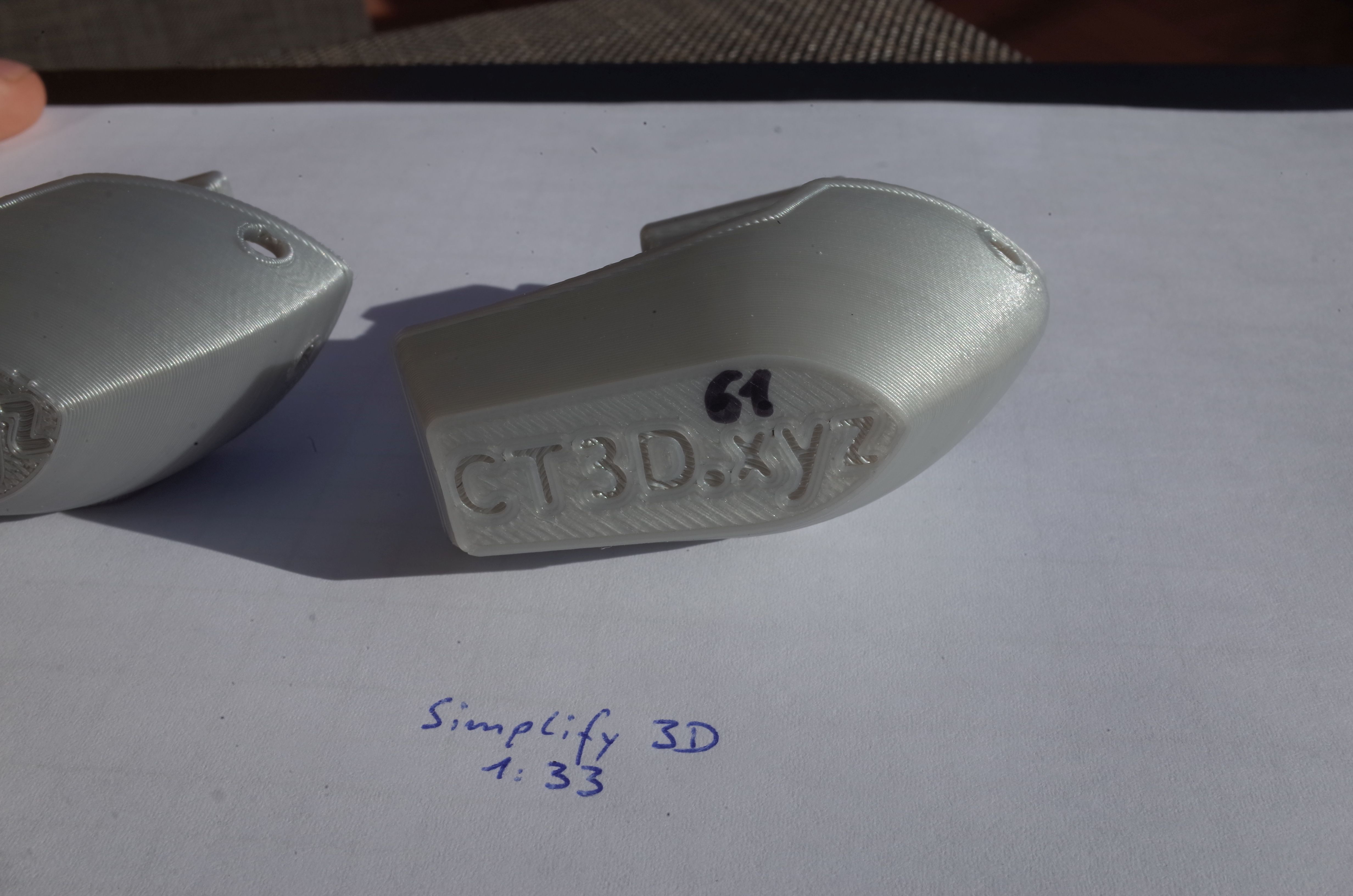

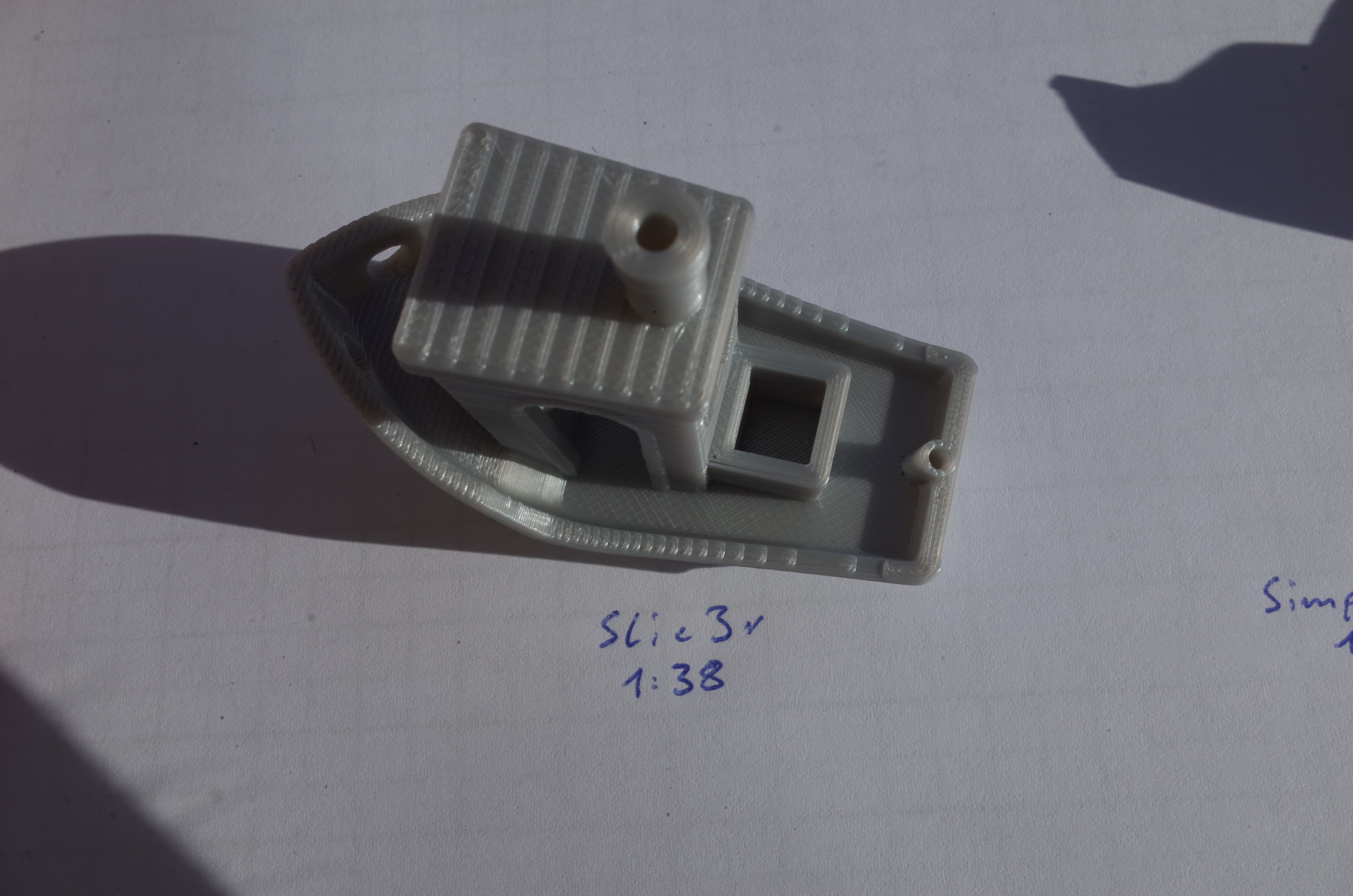

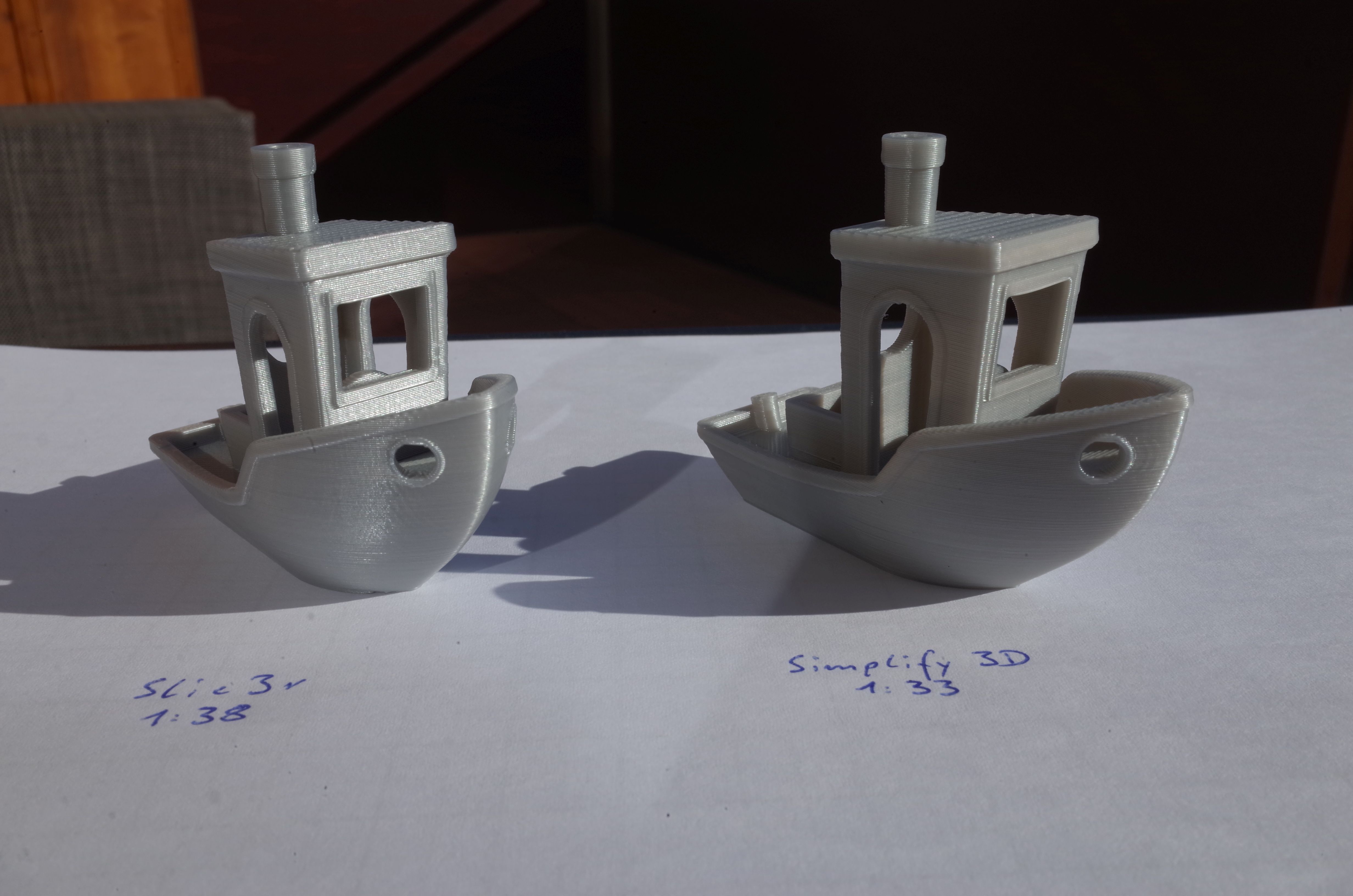

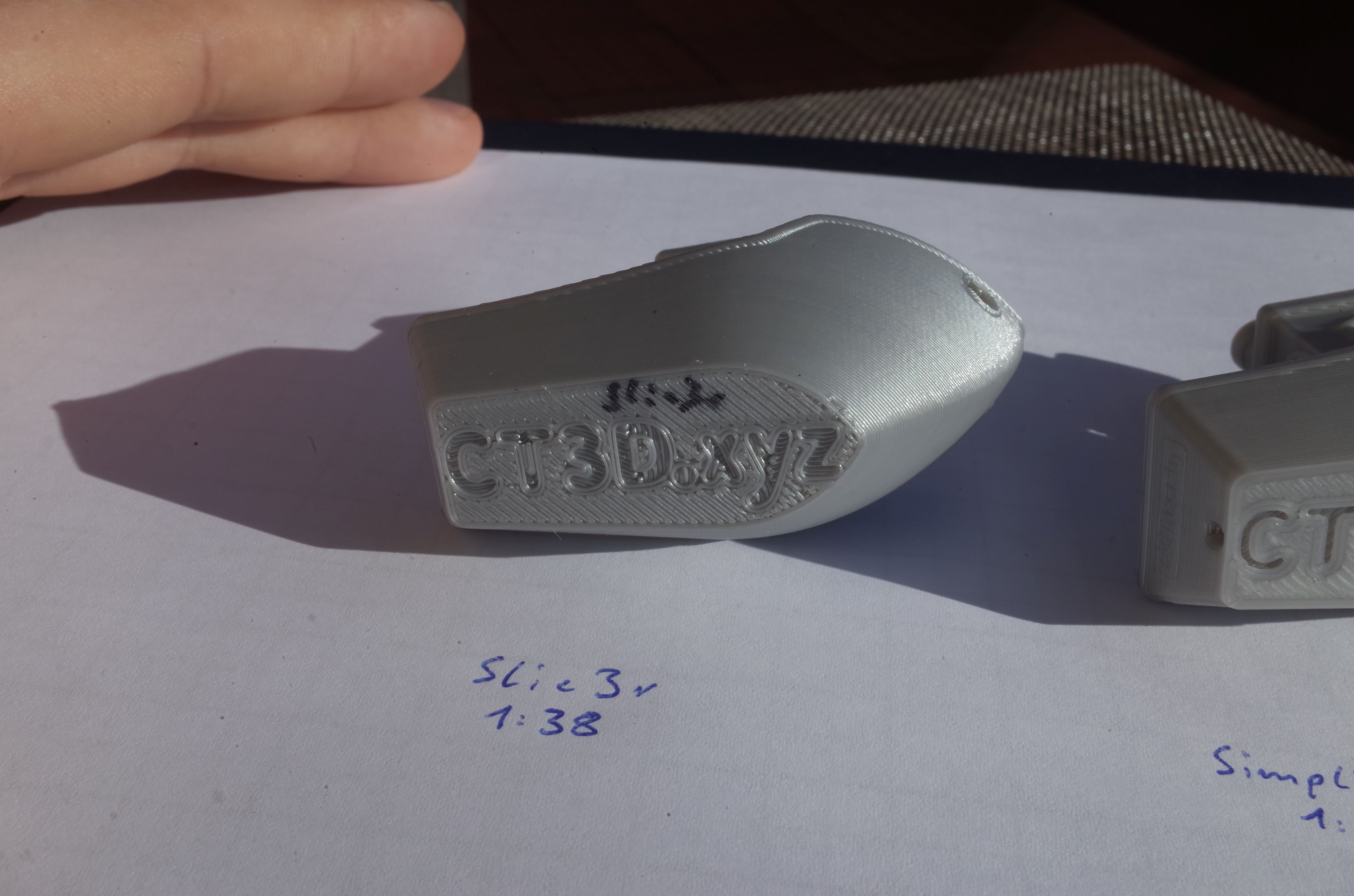

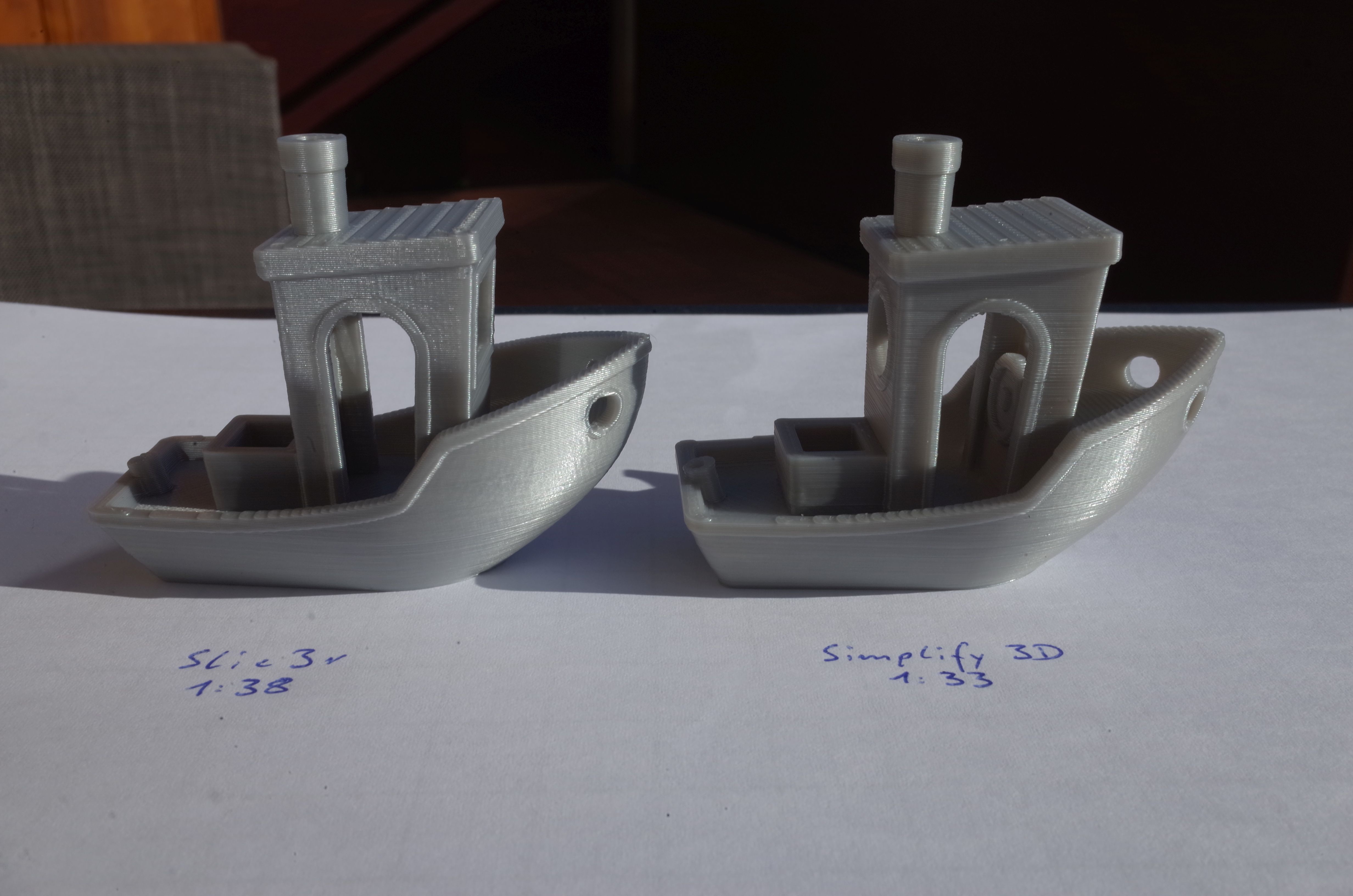

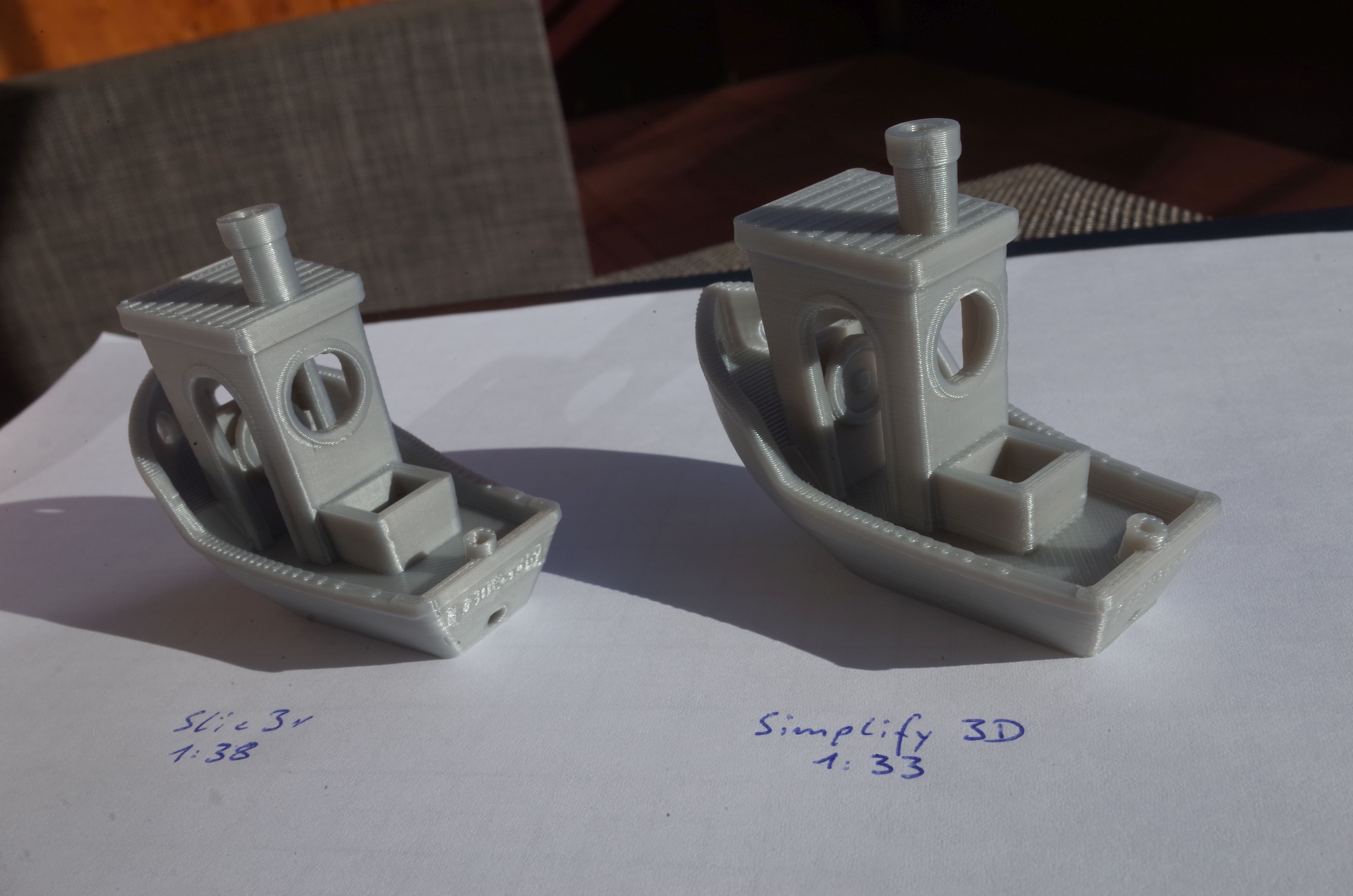

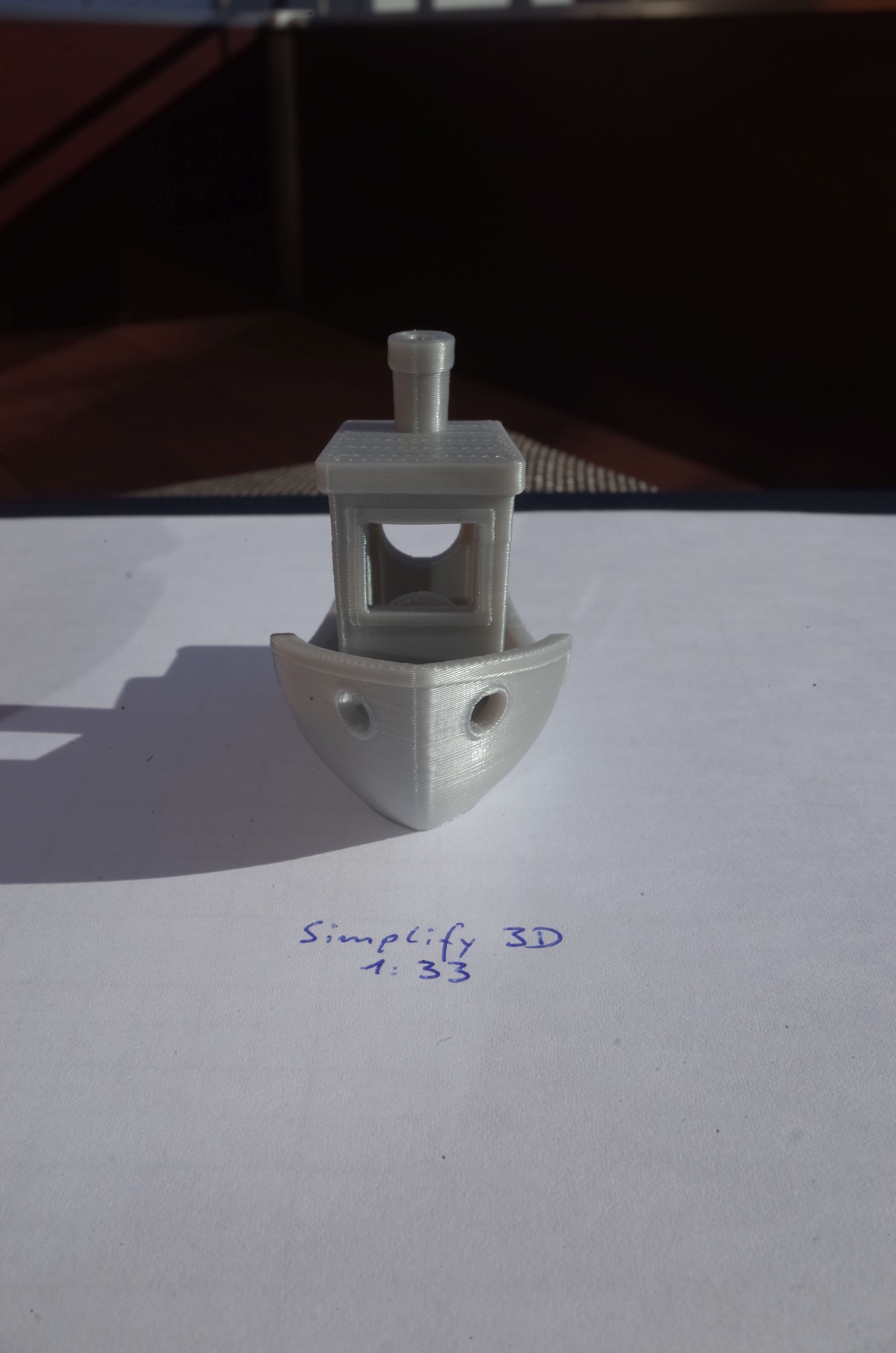

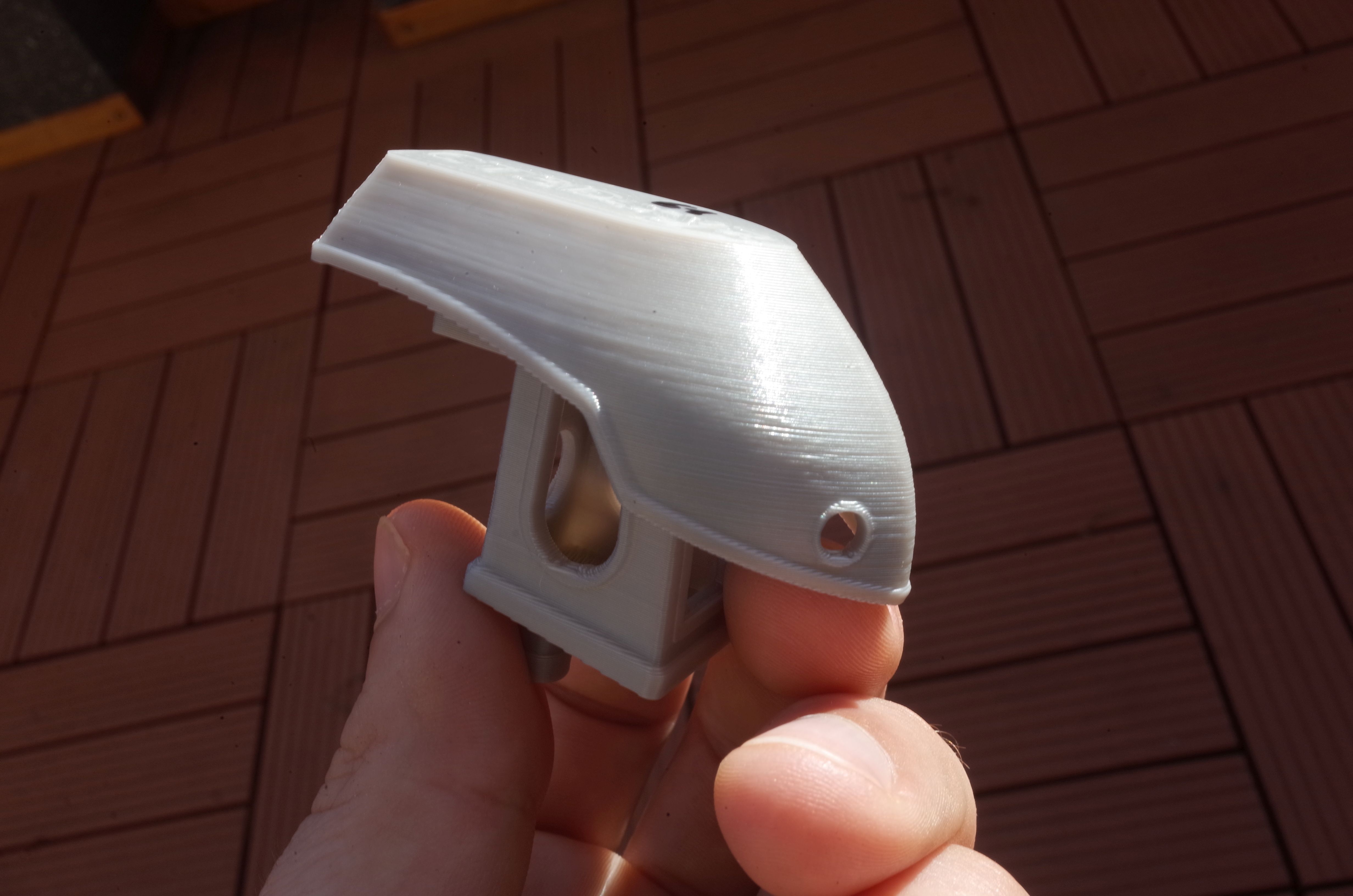

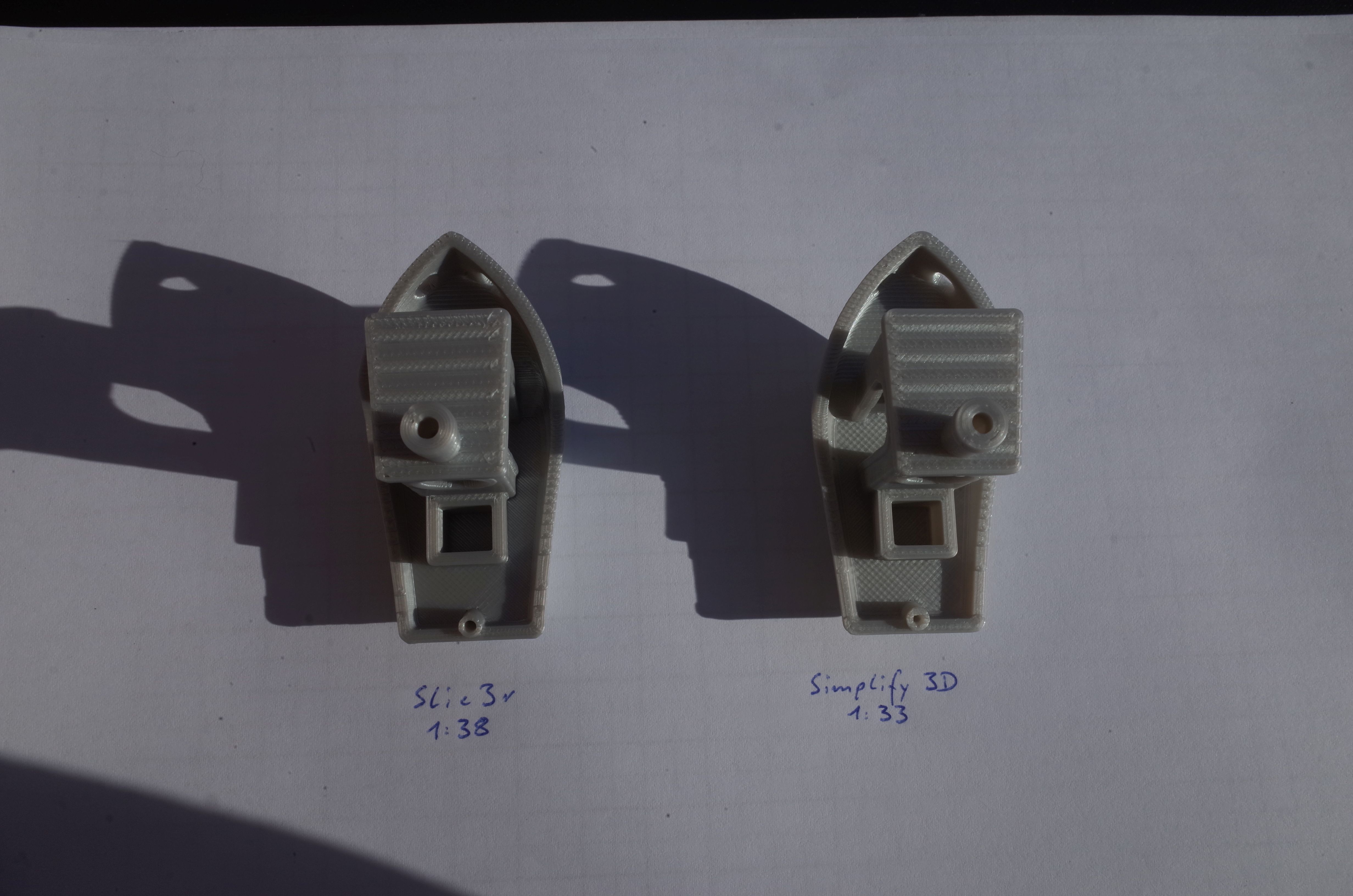

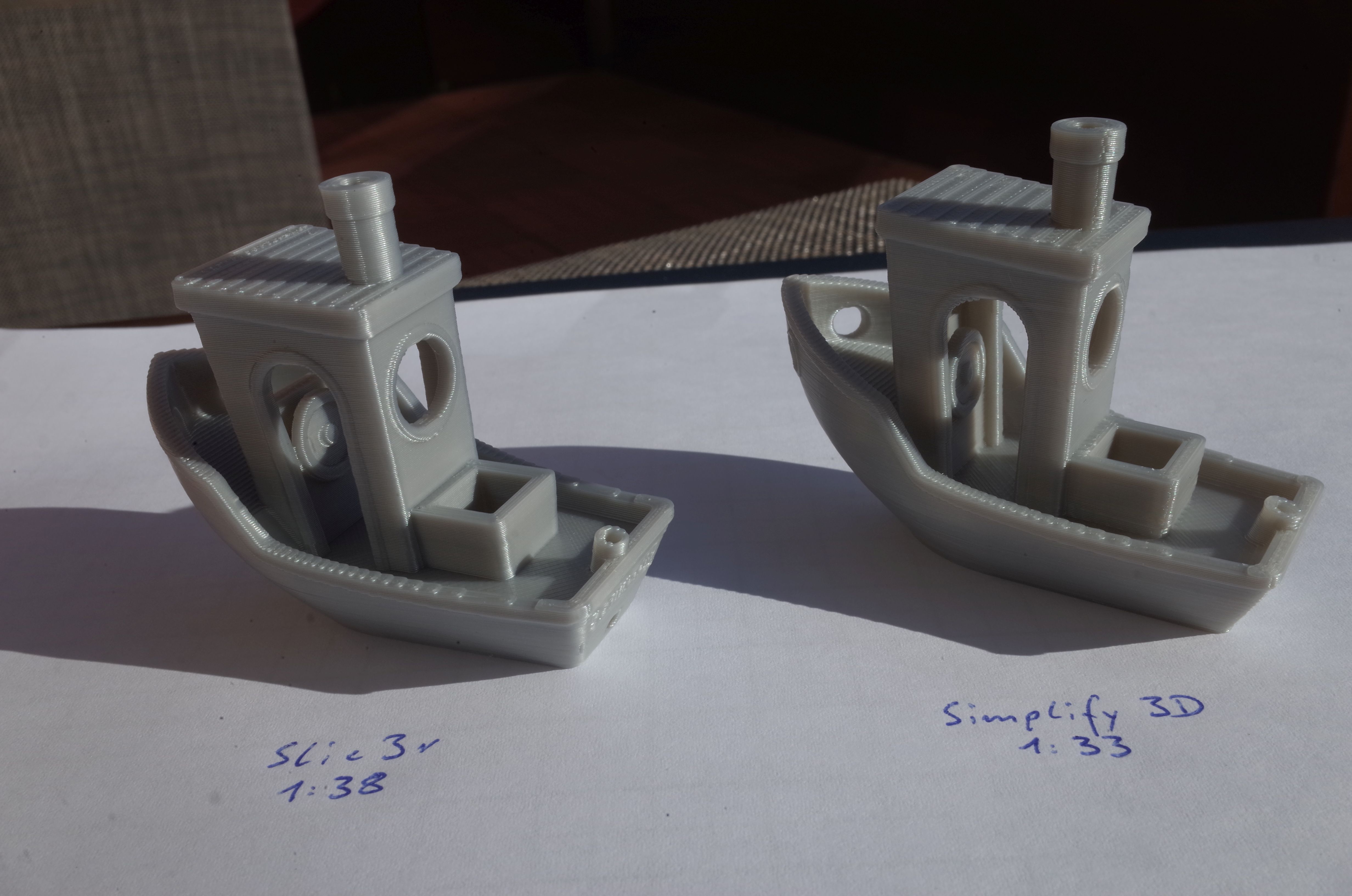

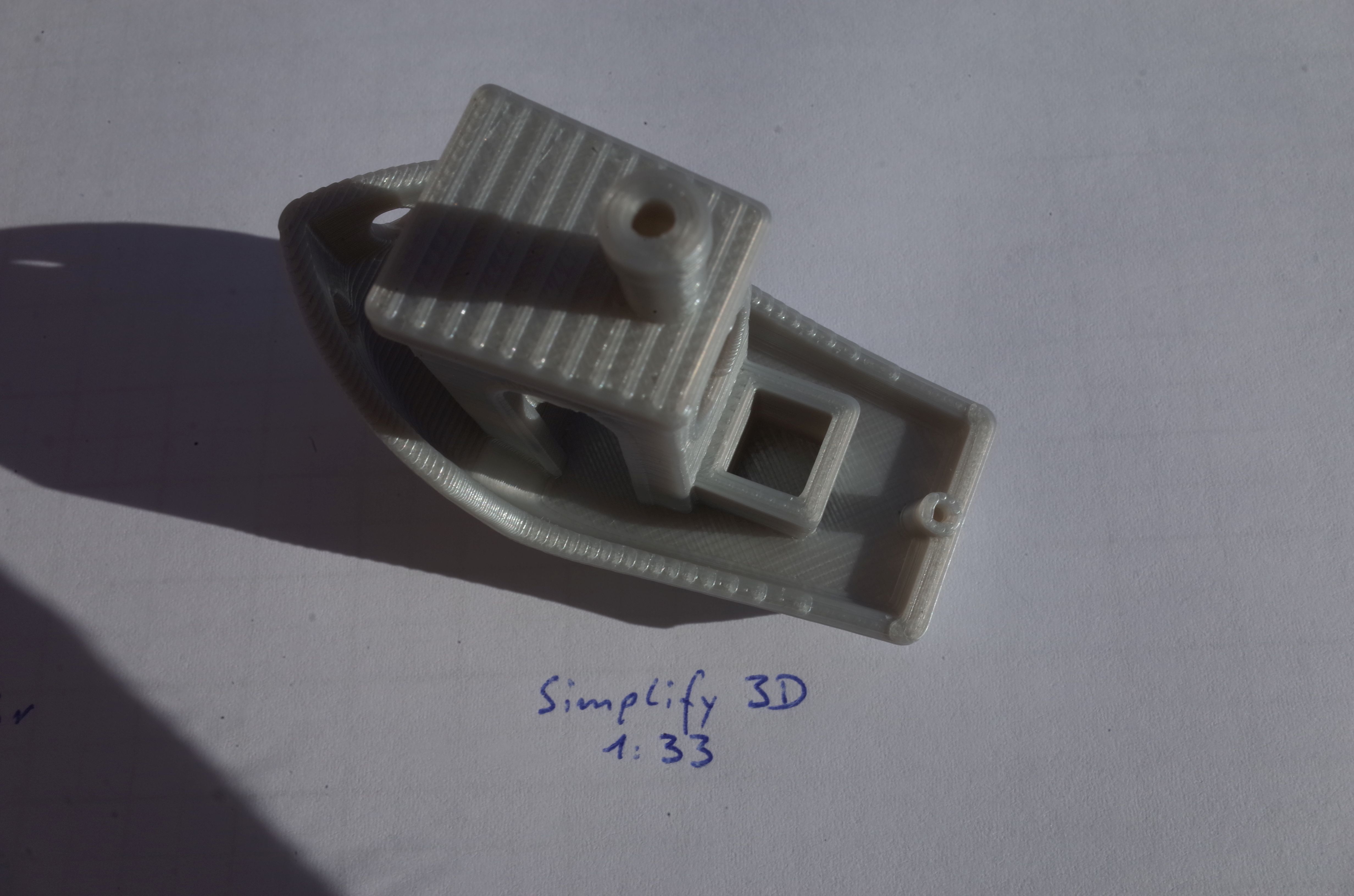

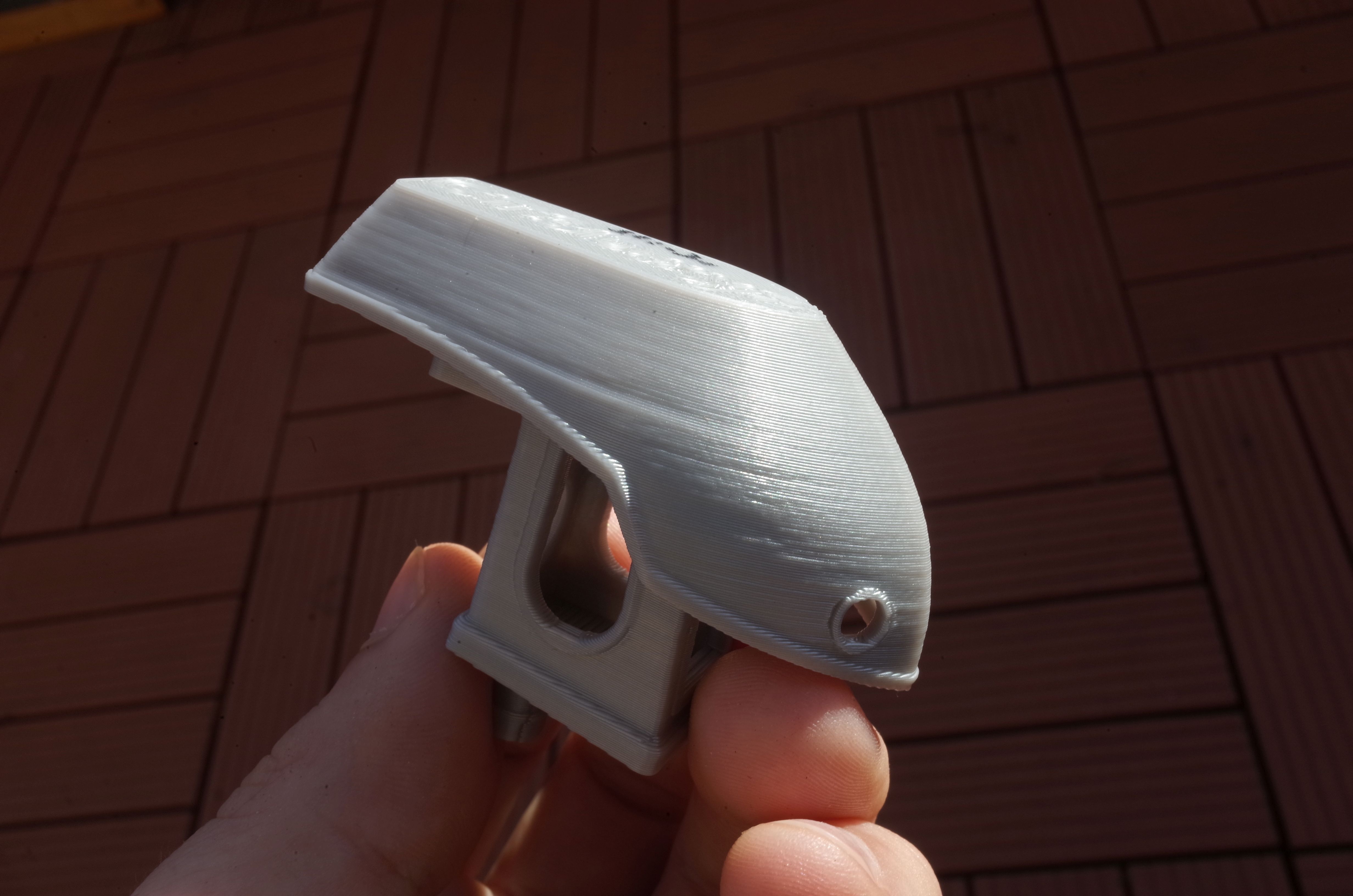

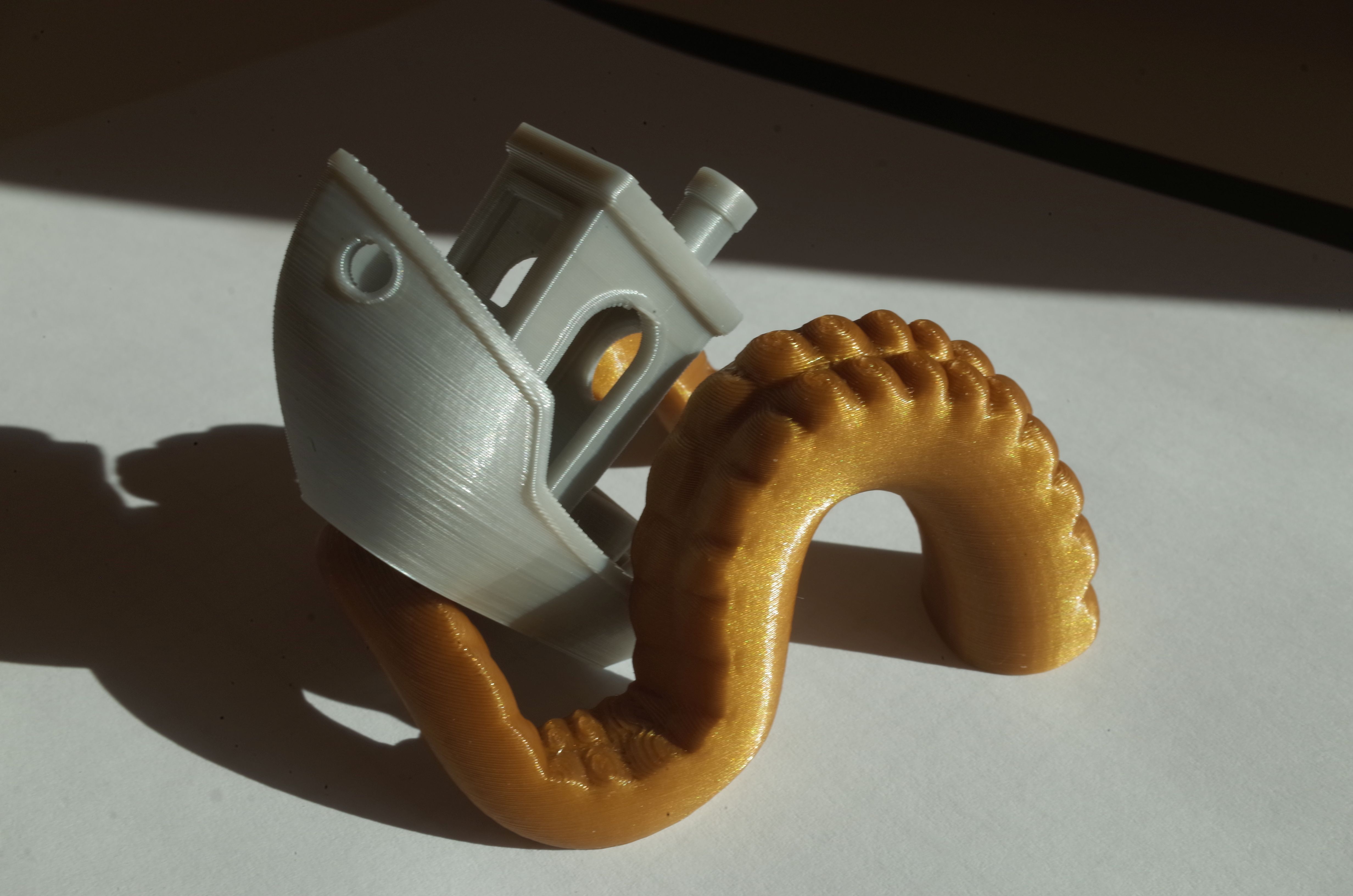

I am working on my S3D profile for half a year. And now it is giving me perfect results. At least for my standard prints (PLA, 0.2 layer height)
If someone wants to try printing it without Simplfy3D i have the gcode in the ZIP-File.
Here is a zip-file with the profile and gcodes inside:
http://www.mleke.at/drucker/s3d/s3d_mleph_20170320.zip
I updated my Make on thingiverse:
http://www.thingiverse.com/make:251465
And some images to compare (they are in high resolution - save them to get a closer look):
Posted : 21/03/2017 10:24 am

philipp (or anyone else), does simplify3d hide z-change seams in corners the way slic3r does? I've tried to find an answer and i couldn't find a definitive one.
I bought s3d and tried it for the benchy using the settings from prusa and from matteo (I think) and the seams were all over the place and left massive zits.
I took a look at philipp's gcode though, and all of the seams were hidden inside the corners. The only difference i can see is that his settings have the outline starting point set to "Choose start points closest to specific location:" i think, with the location set to 0,0,210.
Does that enable hiding seams in corners?
Posted : 24/03/2017 2:44 pm
MlePh
(@mleph)
Re: Simplify3D print settings (August 30, 2016)
Yes in case of the benchy it makes the z changes in the corners. Looks even better then the Slic3r version - if you compare the text on its back.
For most of my prints this point is the best solution. But it depends on how you place the object.
Posted : 25/03/2017 8:38 am
