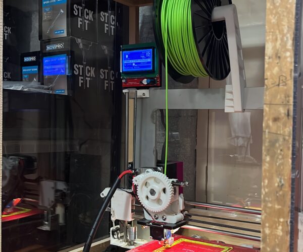

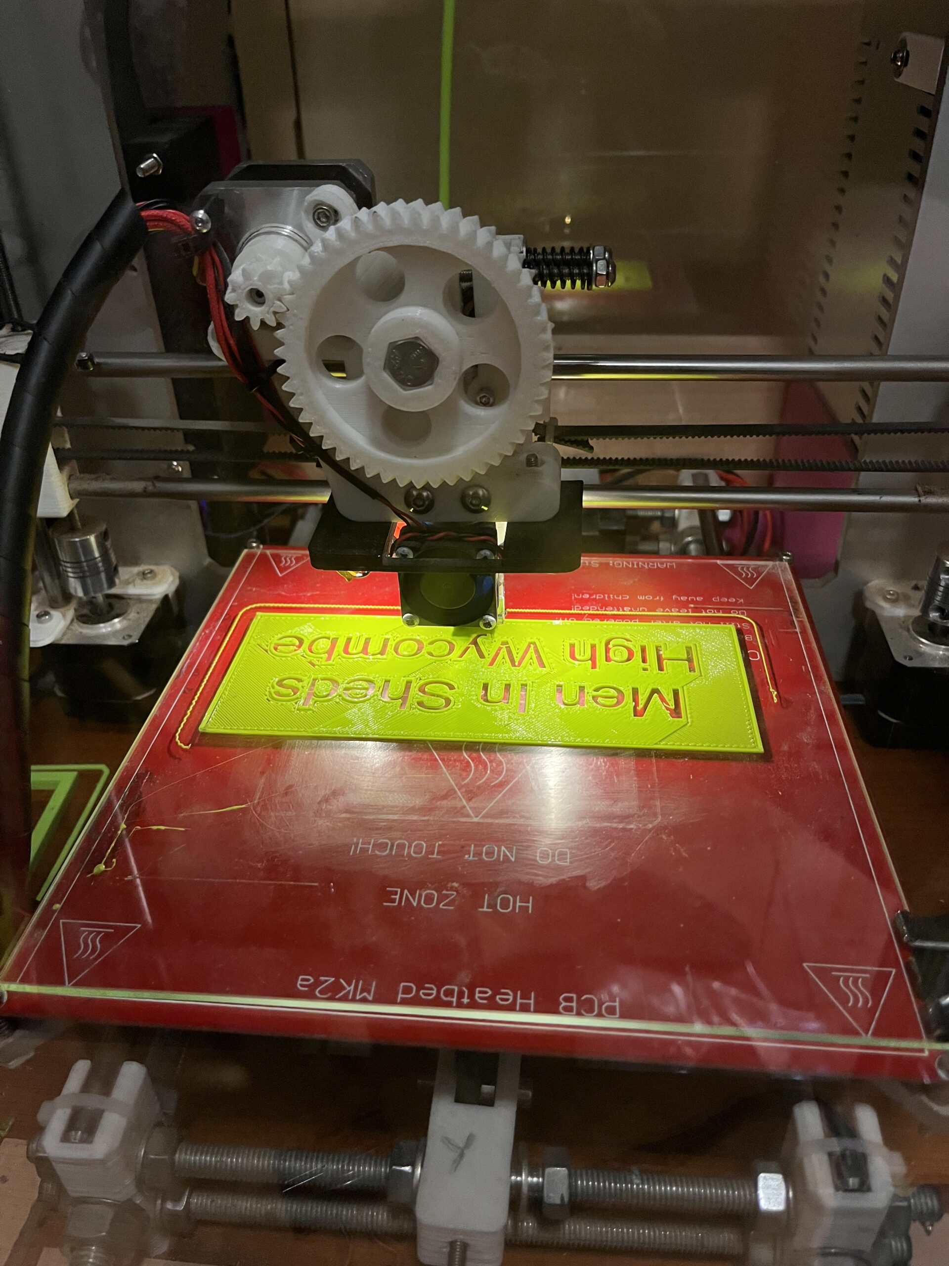

Hi Prusa community,
I have joined a "Men's shed" and they have a 3d Printer donated by a member's son. None of them really know how to use it and all I've got is some Gcode files on an SD card previously sliced by the original owner. I have taken it upon myself to get it working for them. I am aware it's a Prusa i3 as that's what it says on the LCD screen and it's got a MK2a Heat bed so assumed it was an MK2. The issue is I'm not quite sure how to interrogate it any further.
I've attempted a test print but it looks like the extruder is starting too high and so isn't laying things down properly. How do I change the default starting z position. In addition to that I'm not really sure what the parameters for the printer actually to put into the PrusaSlicer programme to make the gcode.
Thanks in advance!

 A few pictures would help us determine what you've got.

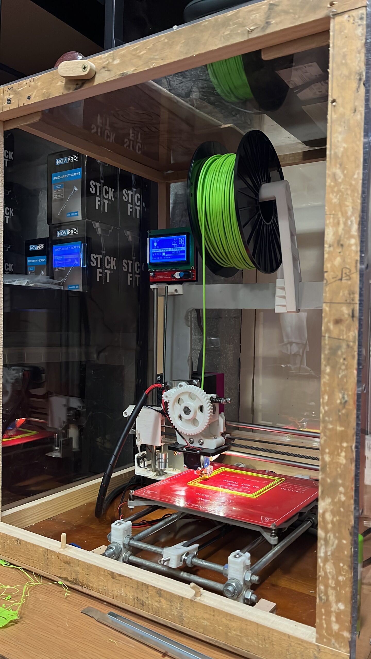

Thank you for your reply! This is all I’ve got for the moment in terms of pictures, I will take more next week. Helpfully they’ve built an enclosure for it so that’s will prevent the entry of rogue dust.

That looks like a Prusa Mendel i3 Mk1 (but no-one called it Mk1 until Mk2 came along) with a bunch of mods - @joantabb, can you confirm?
This is from 2011/2012 - another problem for Men's Sheds is being regarded as a dumping ground for obsolete but once treasured machinery ... it may well have more value as a museum piece than as a practical printer.
Yes, it could be made useable and it would make useable parts for your members but this was a generation when the hobby was running a 3D printer, not making useful things that happened to be 3D printed.  I would not inflict this on beginners.
The levelling is off because there should be a borosilicate glass print sheet clipped on top of the head bed which is then levelled with screws at the corners.
If you have contact with the original owner you might be able to source a suitable set of slicer presets - recreating them from historical software and tweaking them in line with ad hoc modifications may be difficult.
Although Prusa continue to support many older printers; the Mk2.5 had a firmware update last year, the oldest I would consider genuinely useful would be the Mk3.  There are a lot of Mk3's available second hand for around £200 and although there are plenty of cheap new printers at that price a good second hand Mk3 will be a better buy.  Support and forum expertise will probably remain available for another 8 - 10 years.

Are you able to confirm from the photo whether that's PLA on the spool from appearance alone? Is there any reliable way to tell. I assumed it was and it did extrude on the PLA settings (as you can see on the photo). Aside from the glass plate and trying to get a hold of the slicer presets, are there any other things I can do with regards to maintenance that might help before giving up?

I have to thank you both once again  greatly for your help for without it I’m not sure I would have managed. Put the glass plate on and fine-tuned the z-level and finally managed to get it running with Slic3r and printing our own designs after a few weeks of tinkering. No doubt there is fine tuning to be done and more issues will rear their head in due course but for now we’re off!
