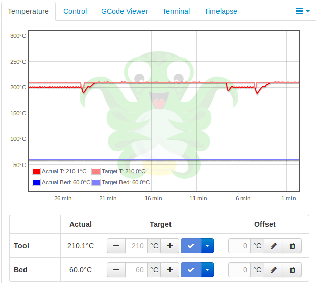

I had similar problem this morning. The printer paused and says "heating".
I am not 100% sure, but I think in my case the displayed temperature was 200° instead of 210°.
This afternoon, I figured out that the temperature seemed to stabilize 10° lower than the target temperature after about 10 min.
Then I set the temperature to 200°, and back to 210° it goes back to 210° for about 10 min, then drops again to 200° (see attached octoprint screenshot).
Disabling the filament sensor solved the issue in my case. Filament used was Light Blue PLA from FormFutura.
