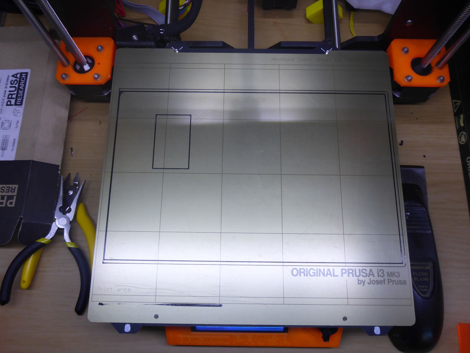

Can't print below x=5 ish - print truncated
My printer won't print at x coordinates less than about 5mm. That is, I don't seem to have 250mm usable bed width, I can't print at less than x=5-ish. There's no skipping or straining - it's not that the print head can't physically get to that position, it's just that when commanded to go there it doesn't. A "G1 X3.500 Y181.594 E0.01714" gcode, for example, is simply ignored.
It's a Mk2.5S that started out as a Mk2 (in 2016) and has been incrementally upgraded to Mk2S to Mk2.5 to Mk2.5S. I noticed the issue on firmware 3.7.2-2363 but I've upgraded to 3.8.0-2684 and get the same behaviour.
Send: M115
Recv: FIRMWARE_NAME:Prusa-Firmware 3.8.0 based on Marlin FIRMWARE_URL: https://github.com/prusa3d/Prusa-Firmware PROTOCOL_VERSION:1.0 MACHINE_TYPE:Prusa i3 MK2.5S EXTRUDER_COUNT:1 UUID:00000000-0000-0000-0000-000000000000
I'm printing PETG, it's in a Lack enclosure, I'm using OctoPrint 1.3.11 on an Octopi that's still on stretch, but is up-to-date for stretch (though I don't think those things will matter).
I'm trying to do a print that has a first layer that's rectangular, 240 x 150mm, and has a skirt 2mm offset, so the skirt should be 244mm wide, so should fit on a 250mm wide print bed, so should be printable on a Prusa Mk2. It's a 34 hour print that uses more than half a roll of filament, so I'm watching the first layer carefully. The first layer is truncated at about x=5mm, so the skirt runs into the print, and the print is (possibly) truncated.
After much checking of my model and my STL I've got to reading the gcode and the OctoPrint console log, and the gcode is fine, the printer's just not doing what the gcode says.

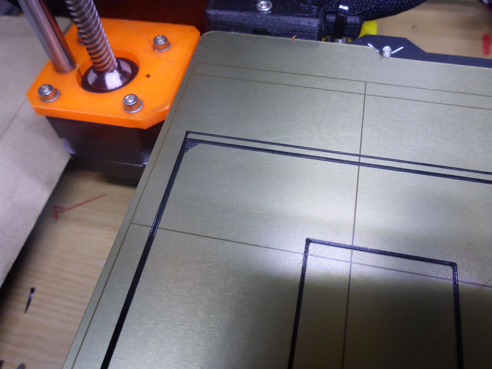

This is what prints:
full bed: < http://www.astounding.org.uk/ian/temp/3d/fr_fullbed.jpg >
left side: < http://www.astounding.org.uk/ian/temp/3d/fr_topleft.jpg >
bigger: < http://www.astounding.org.uk/ian/temp/3d/fr_topleft2.jpg >

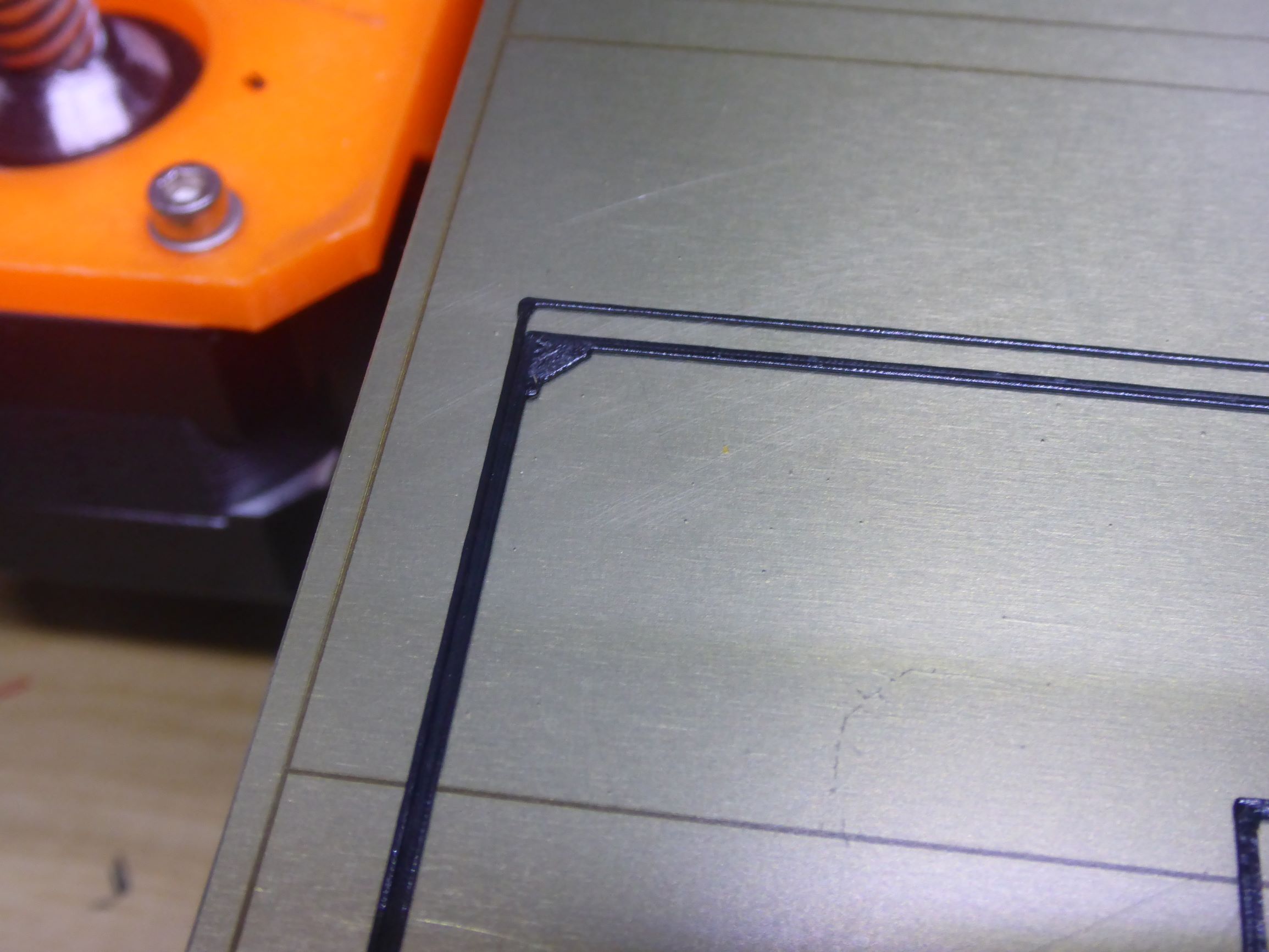

The right hand side is fine - the skirt is clear of the perimeter. On the left side, though, the perimeter and skirt run together. The skirt is definitely truncated (no radii at corners) and I fear that the perimeter is too.

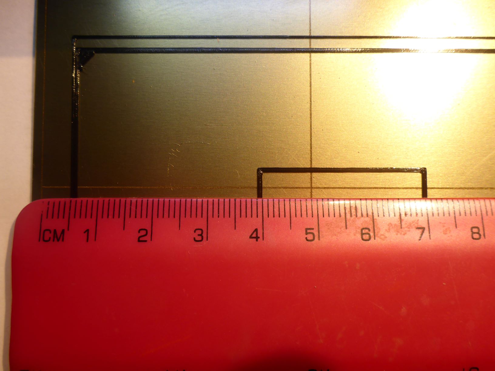

The internal perimeter is a hole that's 30mm wide. In the gcode the inner edges are a bead at x=34.790 and x=70.210. Thus, I can put a ruler on the print and see what x values the printer is actually doing:
with ruler: < http://www.astounding.org.uk/ian/temp/3d/fr_ruler.jpg >
The skirt, which should be at x=2.811, is at about x=5, with the perimeter beads which should be at x=5.201 and x=5.587 at between that and x=6, so close to the right place, but I'm worried not exactly.
As previously noted, the steppers don't skip, there's no straining, the head doesn't hit anything or jam. The printer simply doesn't do what the gcode tells it to do.

My printer cannot reach the leftmost edge of the printbed, because the stop hits the microswitch, but that cannot be the cause of the problem.
The printer has no way of knowing where the printhead is except when the head hits the stop (note, this is not true of the Mk3 - it apparently  detects the motor stalling, but none of the mk2 variants do that).  So if the problem was just that the stop was wrong or something was wrongly adjusted the printer would think that the print-head was at x=0 when the printhead hits the microswitch.  When you sent it to M=250 it would then overshoot the far end of the printbed, but that doesn't happen.
There aren't any 'sensors on the bed' to tell it to stop at 250mm, it stops when it gets as far from the start as it knows it can reach.  So if it can only get from 5mm to 250mm, the firmware has been told it has a bed that's only 245mm wide.
Actually, however, it doesn't think the head is at x=0.  The gcode M114 instructs the printer to tell you where the head is, and if you home the head and then send M114 it tells you the head is at 4.80mm.  At least, mine does.
As a further test, home the print head and then tell it to move to x=2mm by sending 'G0 X2'.  The printer will respond 'ok' but the print head won't move.  The firmware is set to not go further left than x=4.8mm (at least, mine is).
Or home the printhead, then tell it to go to x=10mm by sending 'G0 X10' and measure how far it moves - which for mine is about 5mm, definitely not 10mm.
You can check the far side by issuing 'G0 X250' then 'G0 X249' then 'G0 X250'.  The print head moves back and forth, so it's able to move to x=250.  At that point the nozzle on mine is directly over the edgemost line on the steel sheet.
If I substituted a shorter endstop, the cable bundle would hit the vertical plate.  It's already presses on the electronics enclosure.
It seems clear to me that the design of the mk2.5S printhead is such that a Mk 2.5S can't actually get 250mm of movement, it can only manage 245mm of travel, and to achieve that for some reason rather than set it up to print from 0 to 245 Prusa have set it up to print from 4.8 to 250.
The cockup on their part is that they haven't told the slicer that the printer can't get the head to less than x=4.8mm, so the gcode the slicer produces still has printing in the x=0 to x=4.8 range, which simply all gets piled up on the x=4.8 line.  So if you send a 244mm wide print (as I did) the slicer puts that on the printbed extending from 3mm to 247mm, but fails to print the left-most 2mm.
It would have been nice if Prusa had admitted that the Mk2.5S, as well as all the super new stuff, reduced the print volume by 5mm.  That would have saved me a lot of annoyance.  I would have been really pissed off if I had designed a 246mm object that couldn't be printed at all.  Of course, maybe they 'lost' the 5mm at an earlier version of the printer - can anyone with an earlier incantation report what x value the print head is at after it homes?

I see what you're saying, regarding instructing the print to go to x=0.
However the fact that my printer can't physically reach the edge of the build plate isn't going to be solved by firmware, and from what I could gather from your message your printer has the same issue?
Now on a regular printer there's no other way to know if you're at zero than the endstops, but prusa has the xyz calibration and checks for the location of the metal on the bed, I would expect the firmware to use those as reference points to calibrate origin. (pure speculation on my part, have not looked at the code yet).
So it can know where those points are, set origin based on those and then hit the endstop and not allow past that.
I've made a endstop with 2mm less to test this, if your hypoteses is correct and this is a firmware limit we should still hit that limit (that is the x will be closer to edge but we won't be able to go more than 245mm).
If it's the endstop and it uses some other way to calculate origin we should gain 2mm.
I'll attach my stl to this message as I won't be able to test this tonight (a Christmas print got in the way), but I'll try tomorrow and report back.
Cheers

I have just used Settings | Move axis | X and found you are correct. Right travel extends happily to 250 but left travel stops at +4.8 - recently assembled, perpendicular.
