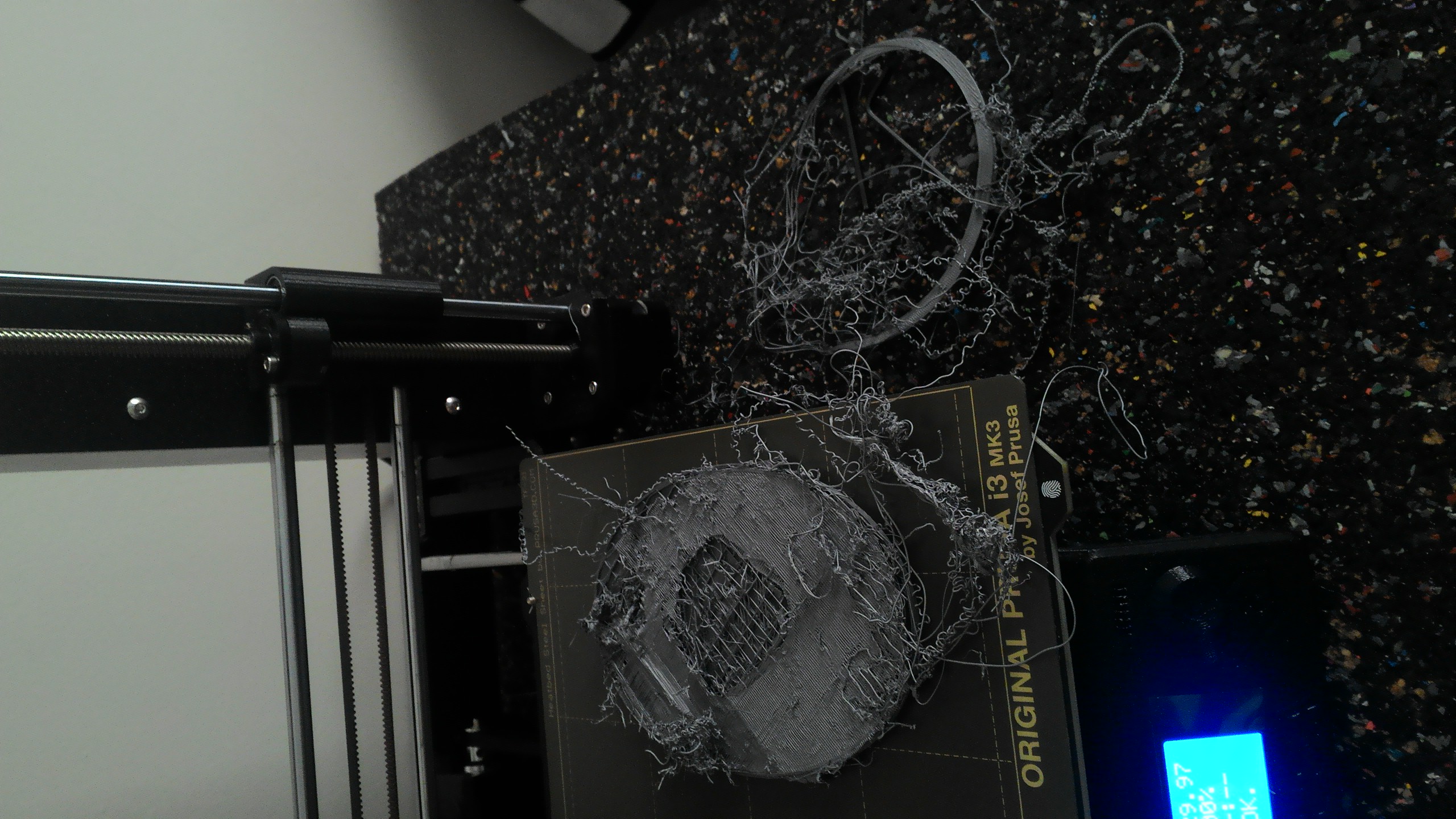

Hi all,
Hardly a day passes without a problem with my mk3s kit. Today's problem is random crash. When I look at crash statistics I see X:2 Y:5 crash detection. What causes this, and how to avoid them?
Thank you. Jpeg

First i would try to deactivate the crash detection and restart the printjob. I would also check whether all axes run smoothly.

Thanks for the answer, Sir. All axes run relatively smoothly. I can try to deactivate the crash detection but isn't that good feature? I mean if I can know what causes this would be healthier than the deactivating crash detection.

Maybe read this here: https://help.prusa3d.com/en/article/crash-detection_2100#check-the-tension-of-your-belts
In my experience, the crash detection is not 100% reliable, so I have deactivated it and can print without any problems as long as there occurs no hardware error (defective linear bearings, wrong belt tension ..)

I see. I've deactivated the crash detection and printed succesfully after that. Thanks!
