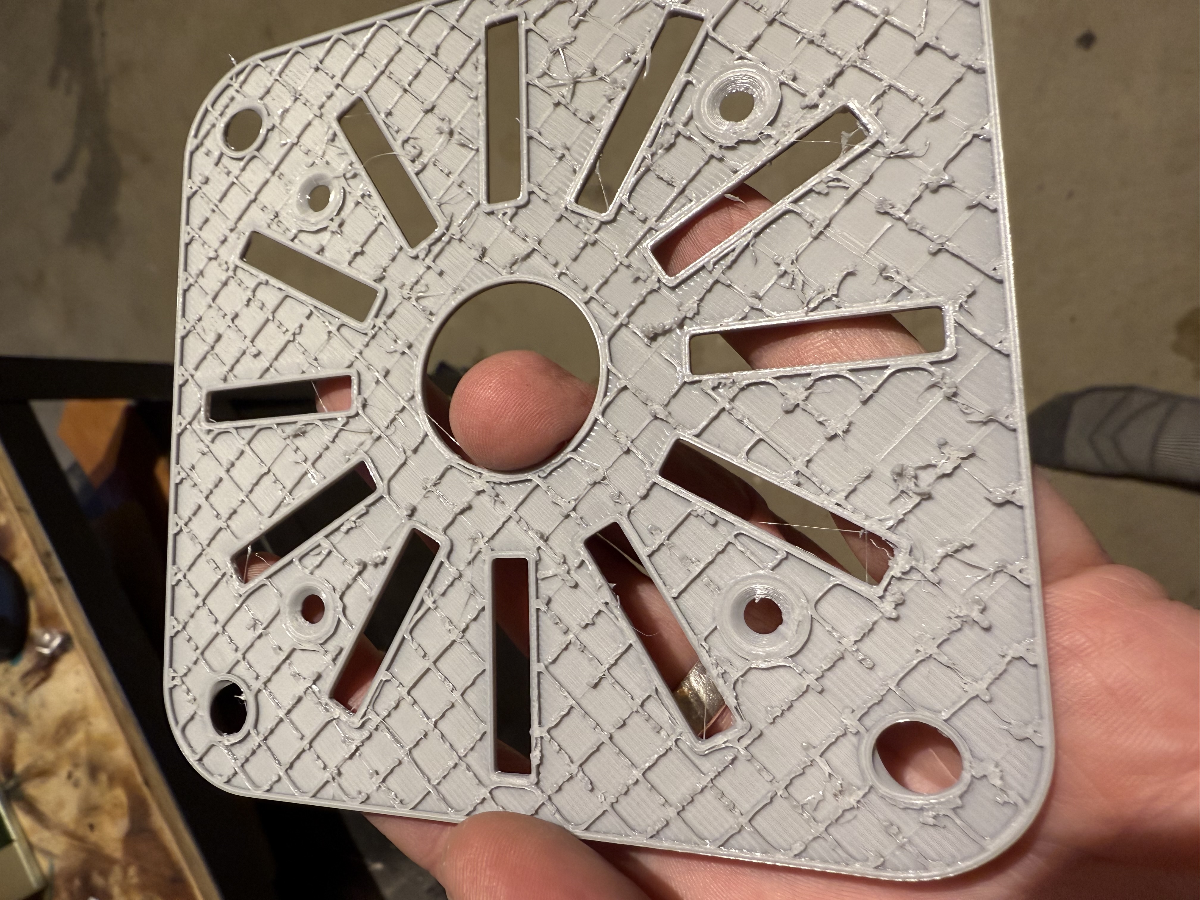

My XL just won't do PETG infill nicely. The walls and top/bottom layer look fine, but the infill looks like the extrusion is sputtering. I've cleaned the nozzle and tried adjusting temperature, with no success.
The same slicer will generate beautiful output on my Mk4S with PETG, and the XL does great with PLA. I'm at a loss.

Looks like Grid infill. I'd try something else such as Cubic or Gyroid. Surprised it works on your Mk4S.. Grid is just horrible as it build up filament at the intersection that eventually trip up the nozzle.

Also looks like underextrusion.  I see you said you played with temperature, but what temperature are you printing at?
What filament brand are you using?
Are you using an enclosure?

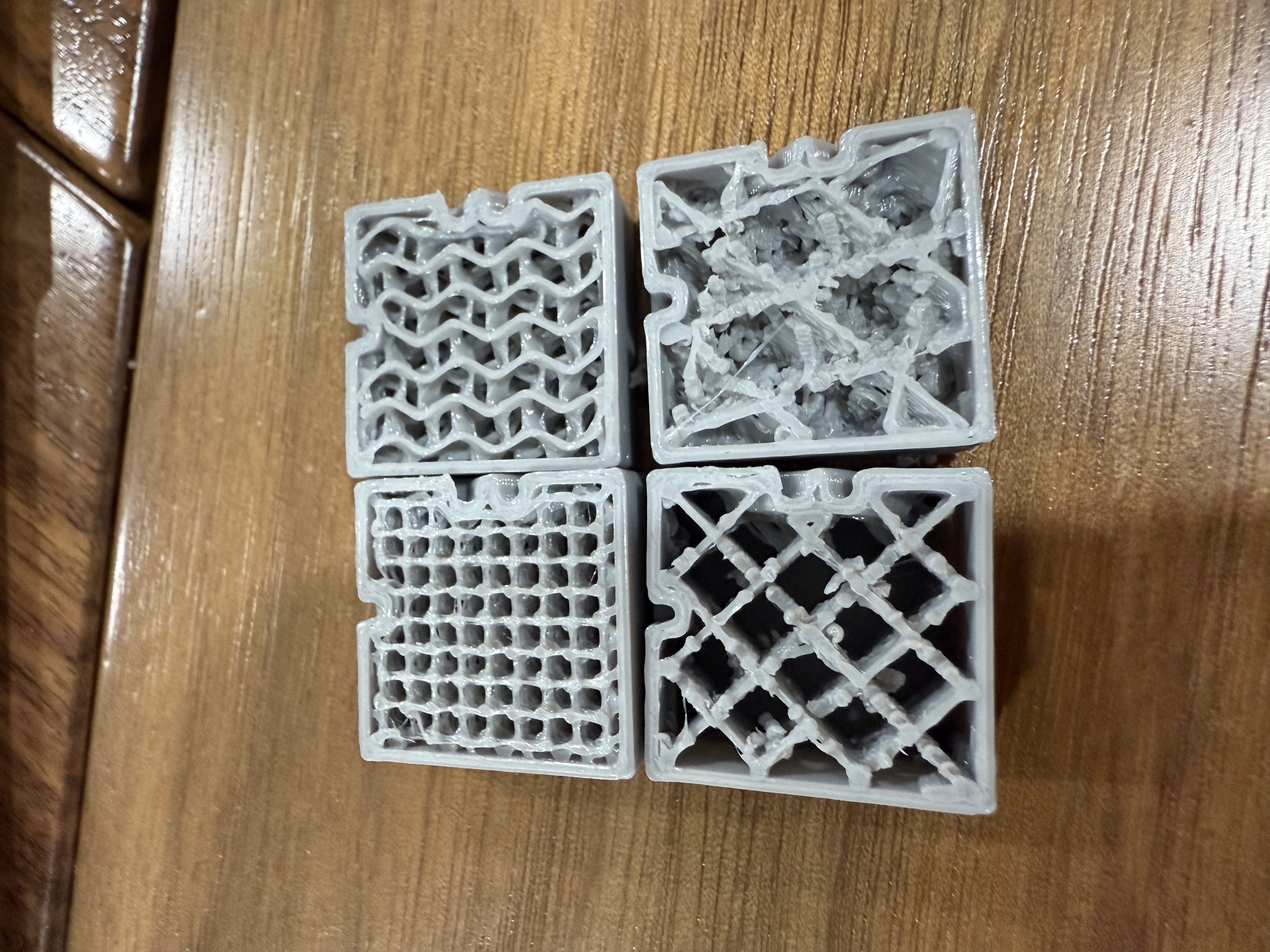

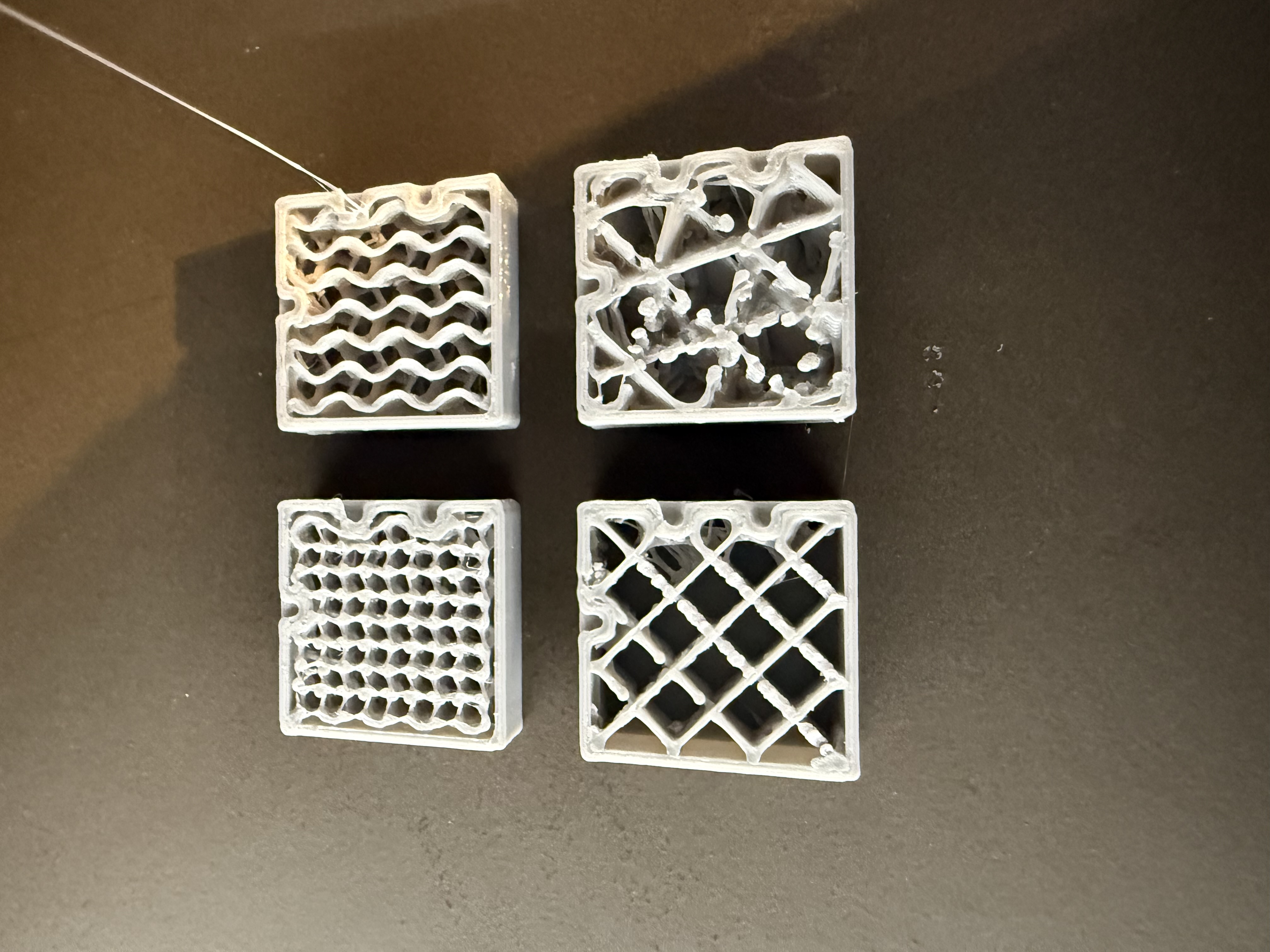

I ran some tests on different infill and got the attached. Clockwise from upper left:?(I don't think I noted this one correctly, so not sure), gyroid, cubic, grid. Gyroid definitely looks a lot better.
I also ran an extrusion calibration cube and got 0.445. So only 1% off. That doesn't seem to be enough to explain this.
Polymaker filament, no enclosure. Again, grid works perfect on the Mk4s that sits one shelf down from the XL. Very odd.

There's more going on than infill. Yes, gyroid looks good but cubic should be fine too. So I'm inclined to agree with Brian to see what happens if you run it hotter, even though in my hands polymaker has worked fine at generic PETG settings.

Tried 240/250 and it didn't change much; I was able to confirm that the top left in both runs was 3D honeycomb. The 3mf file is also attached.
