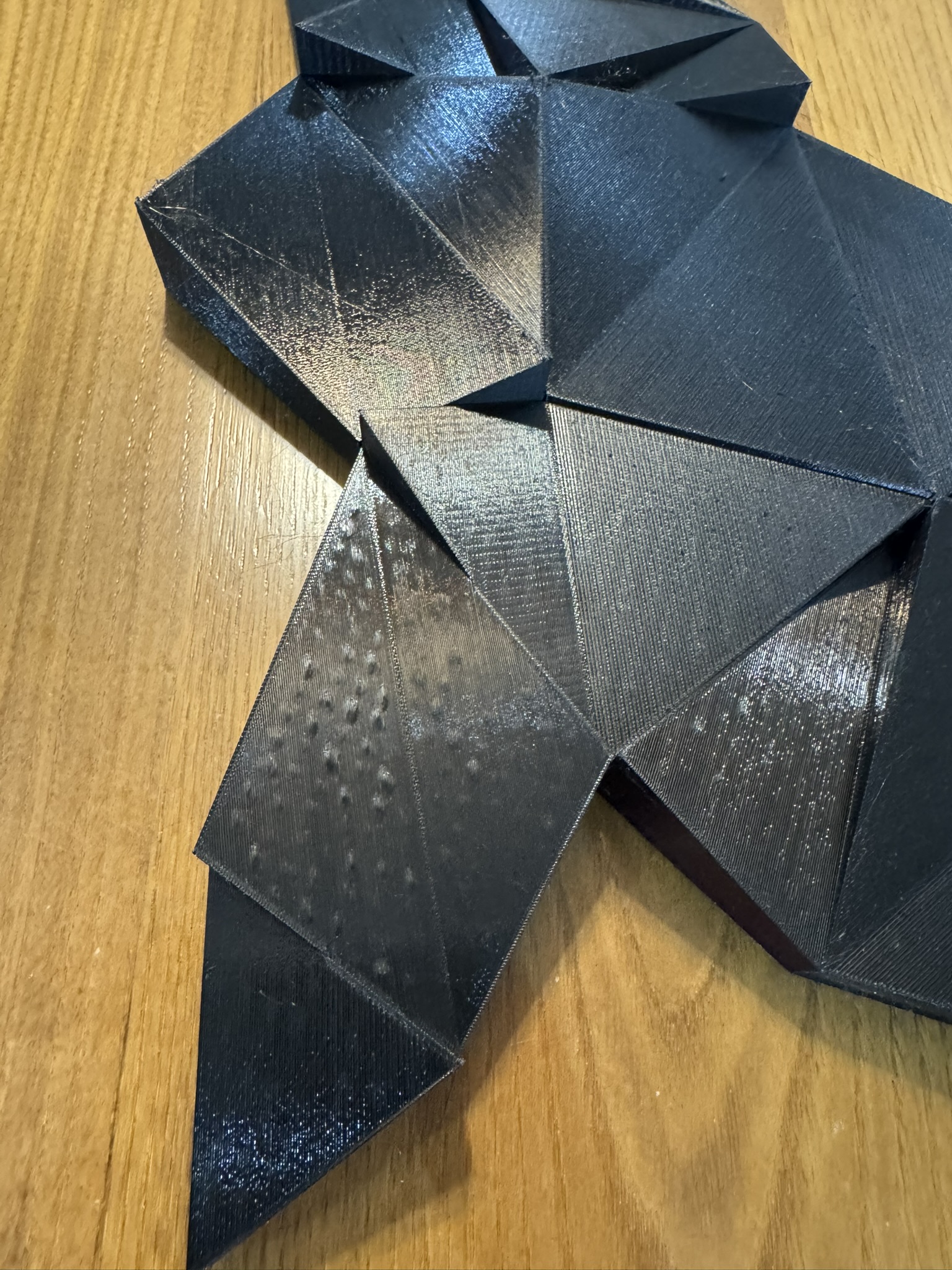

Hello,
I'm having a printing issue with the XL. The surface at the top shows bubbles in some directions. This problem does not occur with the smaller mk3s+. Same dried filament. The XL has a higher nozzle temperature due to the printing speed, but the rest of the settings are the same. Does anyone have any idea why this is happening? Should I maybe increase the head fan speed?
Thanks

Hey,
so the problem here is that the upper layer pushed out due to heat between the infill. Things that will help:
-more top layers
-less temperature (for my XL nearly all profiles were 5c° too hot.
-More infill would make it a little better, but doesn't really solve the root cause.
