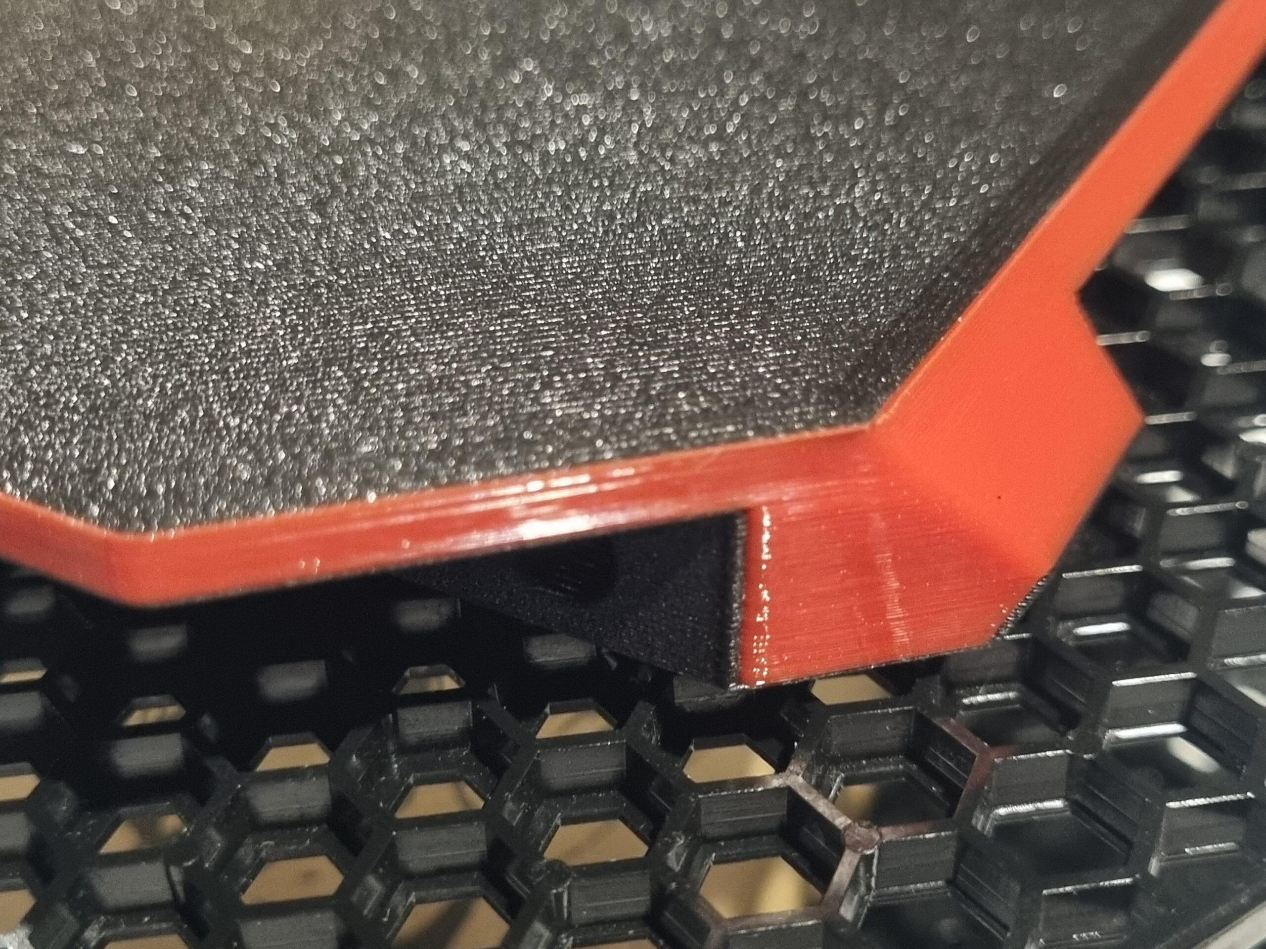

RE: Is the Nextruder hot end design choice a mistake?
The Revo has started to see issues with nozzles slowly backing out and ultimately being snapped off when they come into contact with a print at high speed.
Yep. The default profiles for the XL, even the IS ones; are very slow. Prusa do this deliberately to have stock profiles that with generally result in success and quality and they made it clear that speed was not a high priority for them.
The Nextruder will happily run WAY faster with a lot higher volumetric flow rates and still produce amazing prints. I am running way faster than the stock profiles without issue.
Speed comes at a price in other areas, depending on how fast you go.
I've only had my XL for a week and am producing awesome multicolour prints with the stock 0.6 nozzles teamed up with one extruder running a V6 adapter and a 0.6 NozzleX for PETG CF.
Drying your filament is critically important. I live in a very hot and humid area. Before printing, I dry my filaments till they are stable at 20% or less for 12hrs.
99%+ of my prints are in PETG and after some tuning, my XL punches out print with little to no stringing at all.
Also, printing and installing these brush holders has been a massive improvement.
https://www.printables.com/model/462473-prusa-xl-series-nozzle-scrubber-brush-update-inclu
Posted : 05/12/2023 10:58 am

Now that is interesting.
Yep. Running the 5T IS profiles, but the speeds should be the same regardless of the number of tool heads.
The settings I was using are 0.20 SPEED XLIS 0.6, 2 or 3 perimeters, 15% cubic infill, 4 top and 4 bottom layers. But really, as long as you are using the same settings on both nozzle sizes; you should still see big differences.
