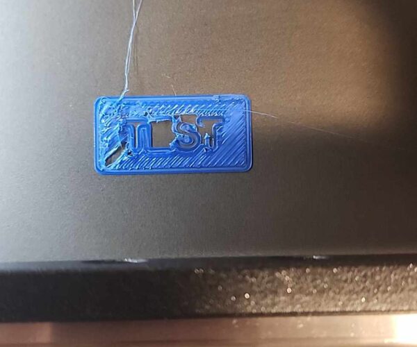

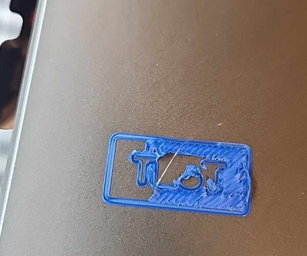

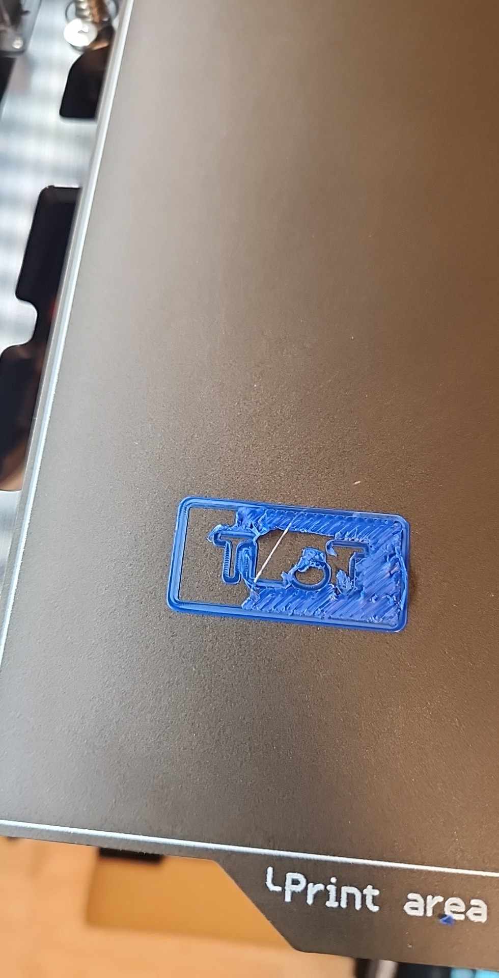

More first layer issues.
So like other people on here I'm having issues with the "perfect" first layer. I've had a few successful prints but nothing with a good first layer and now I'm just at the point where nothing can print. I've read other topics on here and have tried their fixes. Like removing the z caps, usuing the satin sheet verses the textured, dried my filament, let my heated bed sit at temp for over 10 minutes, tried to do the live z adjust to go lower to improve adhesion. I'm printing in PETG and I never had this much issue with my mk3s and I'm just starting to feel like I wasted my money on this thing.

RE: More first layer issues.
that looks like the live Z is too low,
Try adjusting the number positive say 0.060, and see what happens... see if it improves,
