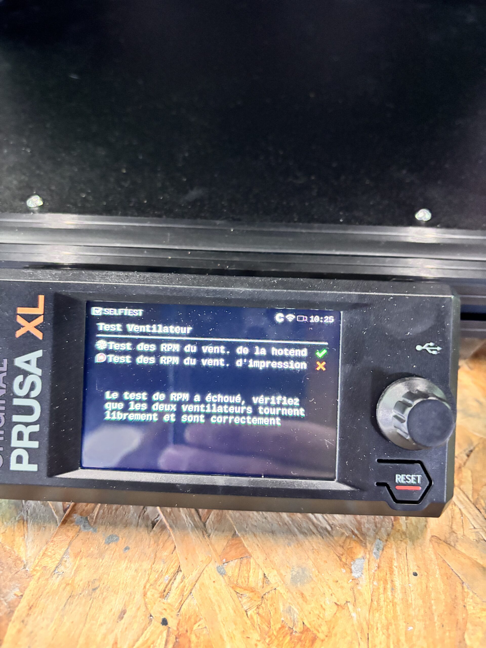

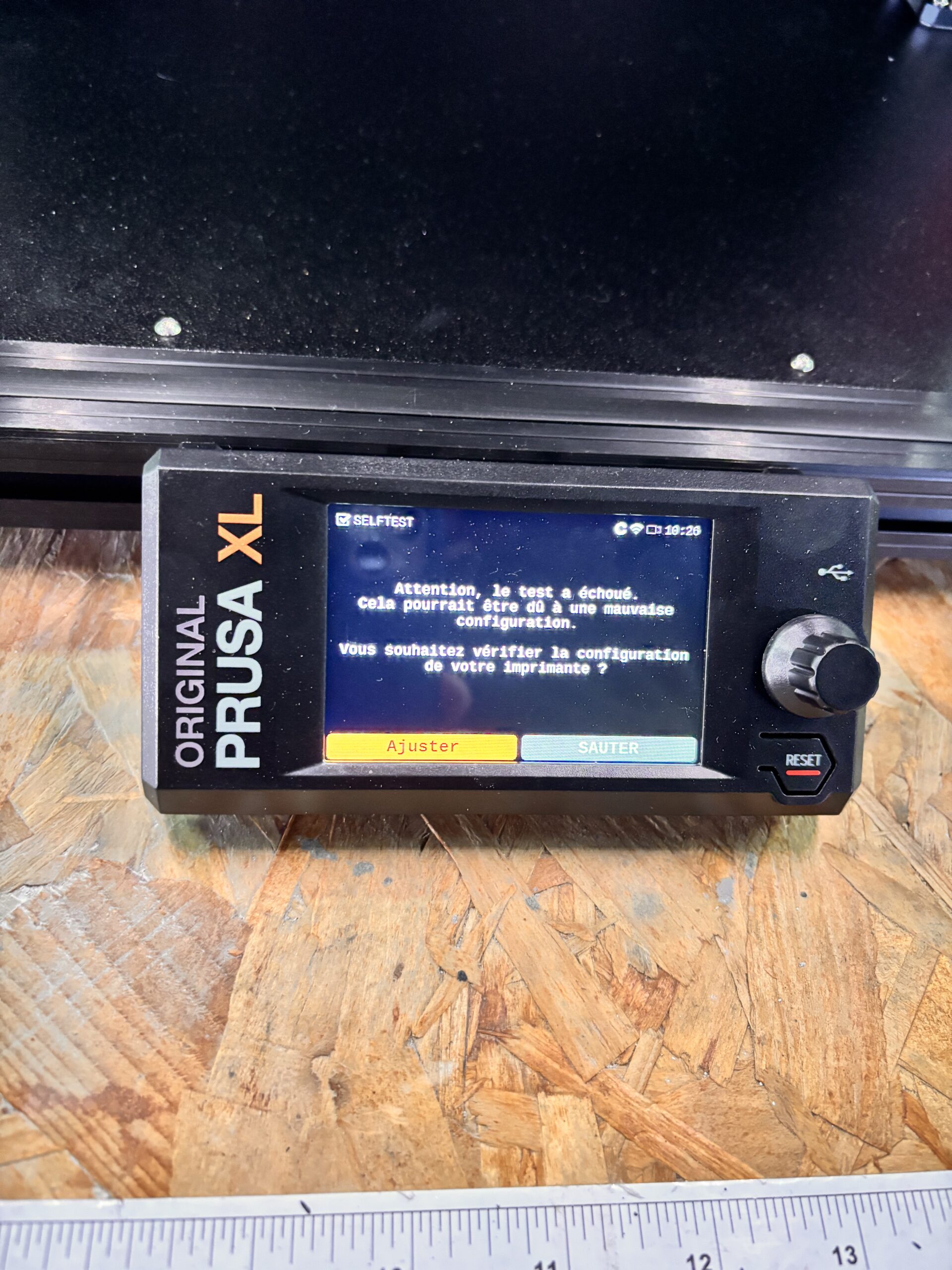

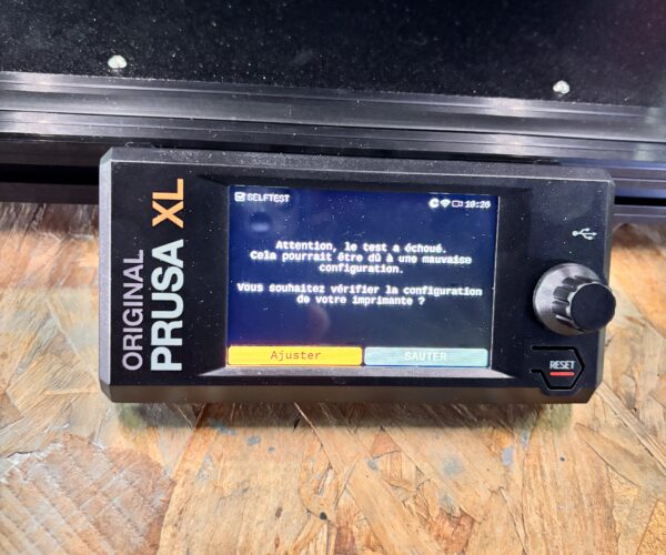

Hi, I’m having trouble doing the firt test with the Prusa XL
and the fan is spinning during the test but still it does this message …
do you have any ideas ?

Take off the part cooling ducting, rerun the tests, pass them, reinstall the ducting, never run part cooling fan test ever again. ¯\_(ツ)_/¯
