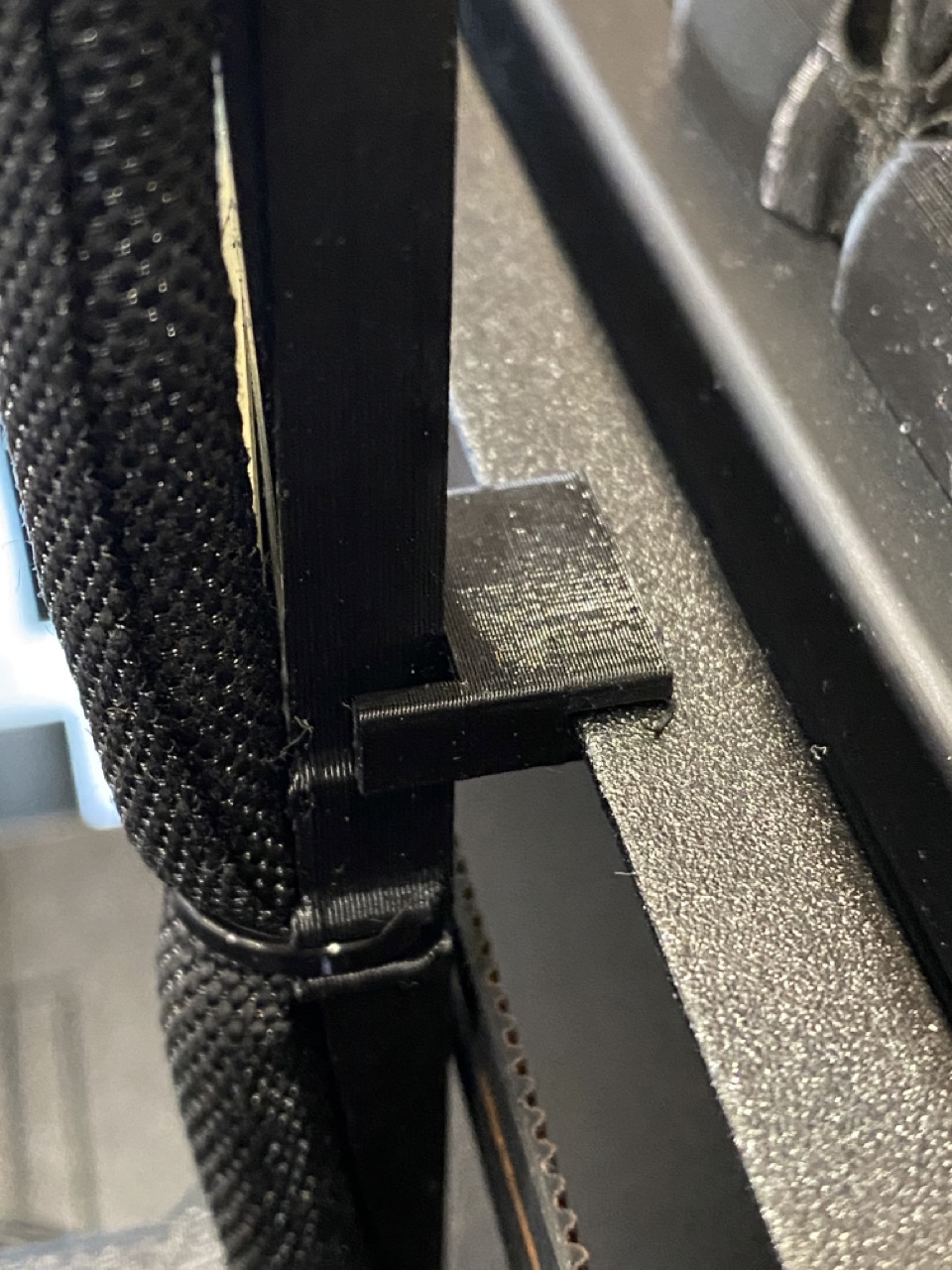

I just finished assembling my XL and noticed that the back of the extruder cable holder (the part that screws to the frame) is basically rubbing against the back belts.
Pretty sure I have all installed/tightened properly. Is this normal?

It's for me the same. I was observing it for a while and I think there is still a very small gap, but I'm not sure if it stays like this, when the material is aging. I'm wonder why Prusa make it this way as there are many better design solutions. However I printed a small spacer clip which maintains the distance.

From my experience, I would bet it's not fully inserted into the extrusion.
The fit is very tight with the paint on the extrusion and even when it felt like it was super tight on my side it was still not inserted fully and would wiggle when the tool was parked. Either the bottom was in but the top was not and the dock was tilted back or the opposite with the tool tilted toward the bed.
There a "teeth" that need to be fully inserted into the extrusion, I had to move the dock back and forth while I was tightening it for a bit until the paint got scratched enough for it to fully get in there.
The instructions don't really mention any of that.

Thanks! I had the same issue. I filed a bit of plastic off and re-installed. I think the plastic piece should be re-designed with a bit so it fits into the extrusion more easily (and maybe make it a little shorter), but I now have a clear 1/8" of space.

Like jF wrote, this is with 99.99% certainty a mounting problem. This is not engineered well and will catch so many people who are assembling the printer.
The problem is, that it's also very hard to check if the mount went in all the way. Because of all of this are shiny black parts, and the geometry is covering the sight to the aluminium profile.
You should get around 2.5 mm clearance if it's mounted correctly.
