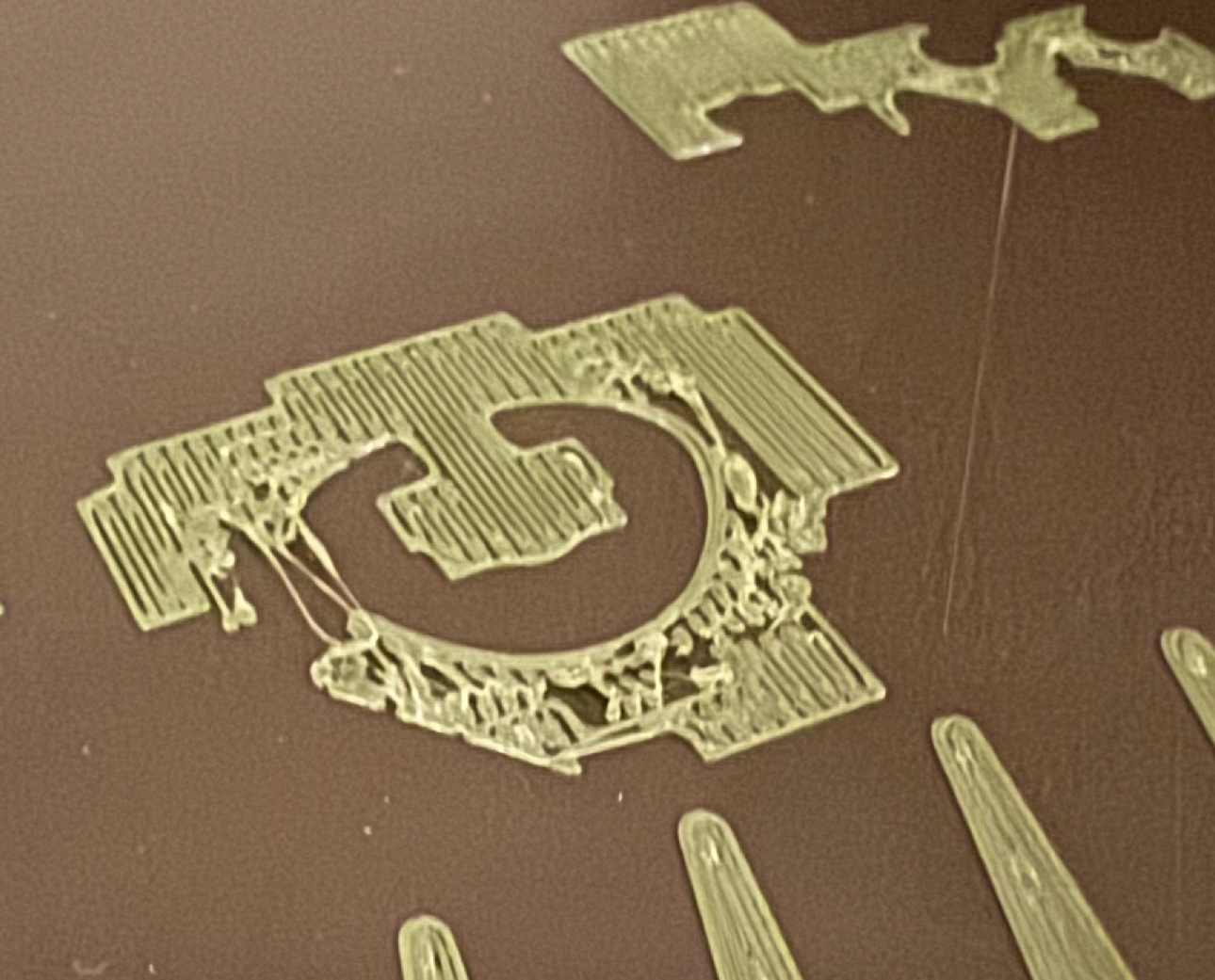

Stigern
(@stigern)
Also had severe first layer problems on my mk4, factory assembled.
I had to adjust my nozzle, loosened the two screws and every so slightly moved it closer to bed. And re-tightened.
Not sure if thats the correct way but it seems to help.
