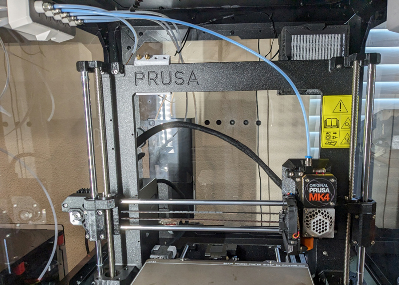

Posted by: @robmccoy
Perhaps this isn't an input shaper limitation, but I've noticed that when starting a new print, the nozzle cleaning step will fail. I believe this is because my spool is heavier and is confusing the load cell tester. Once printing begins, all's well. I usually have to run an auto home before each print.
I isolate the filament pulling from the spools using a PTFE tube setup anchored at both ends  See picture below.  The  "pull up in Z" effect on the head assembly is eliminated when pulling tight/stuck filament.   Feeding the filament directly from an overhead roll, it can pull up when the filament is stuck on the sides.   With my setup I have had it collapse the PTFE tube when pulling stuck filament from the end of the spool and it did not leave any flaws in the print.   Nextruder does the job.
