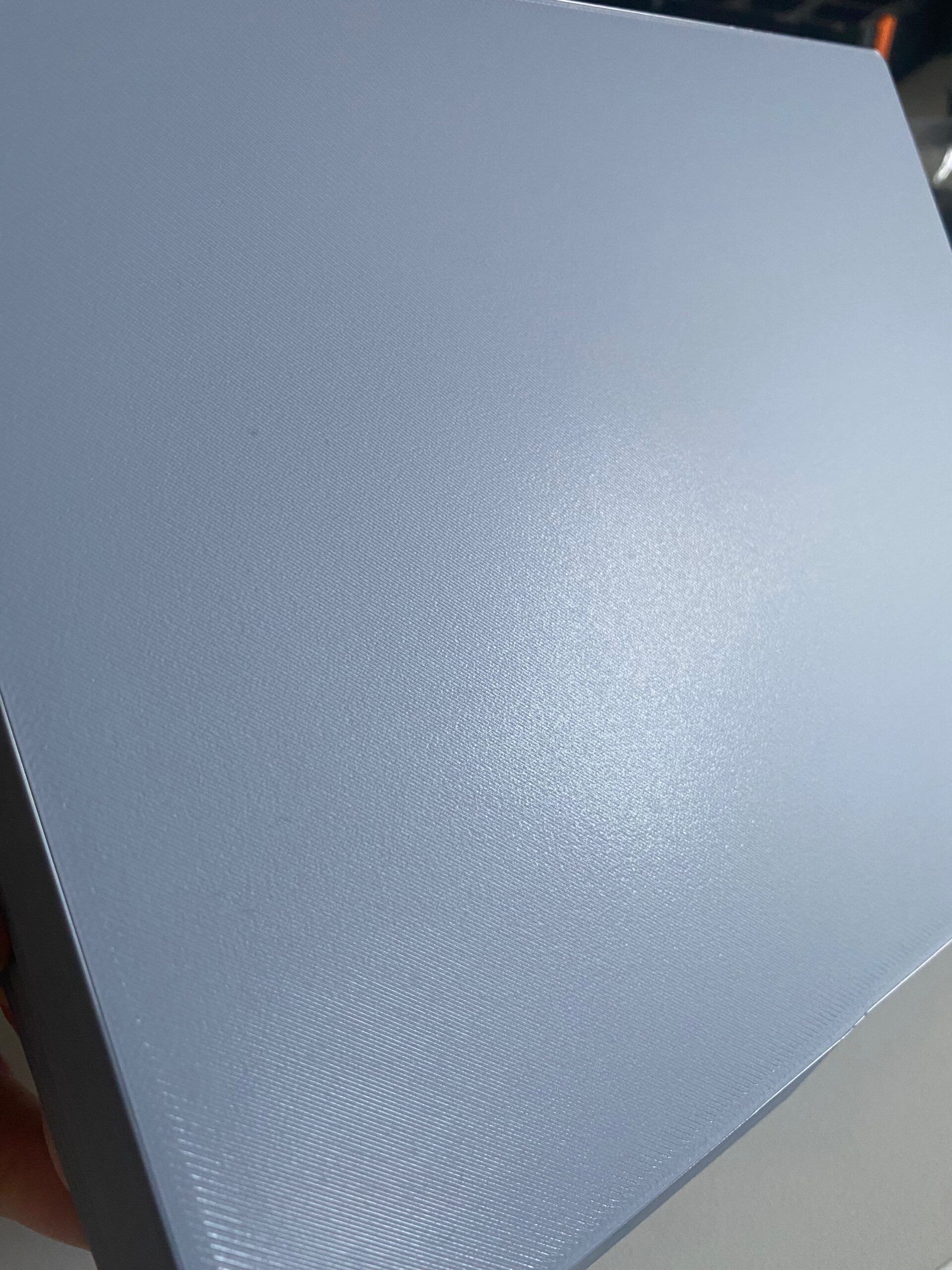

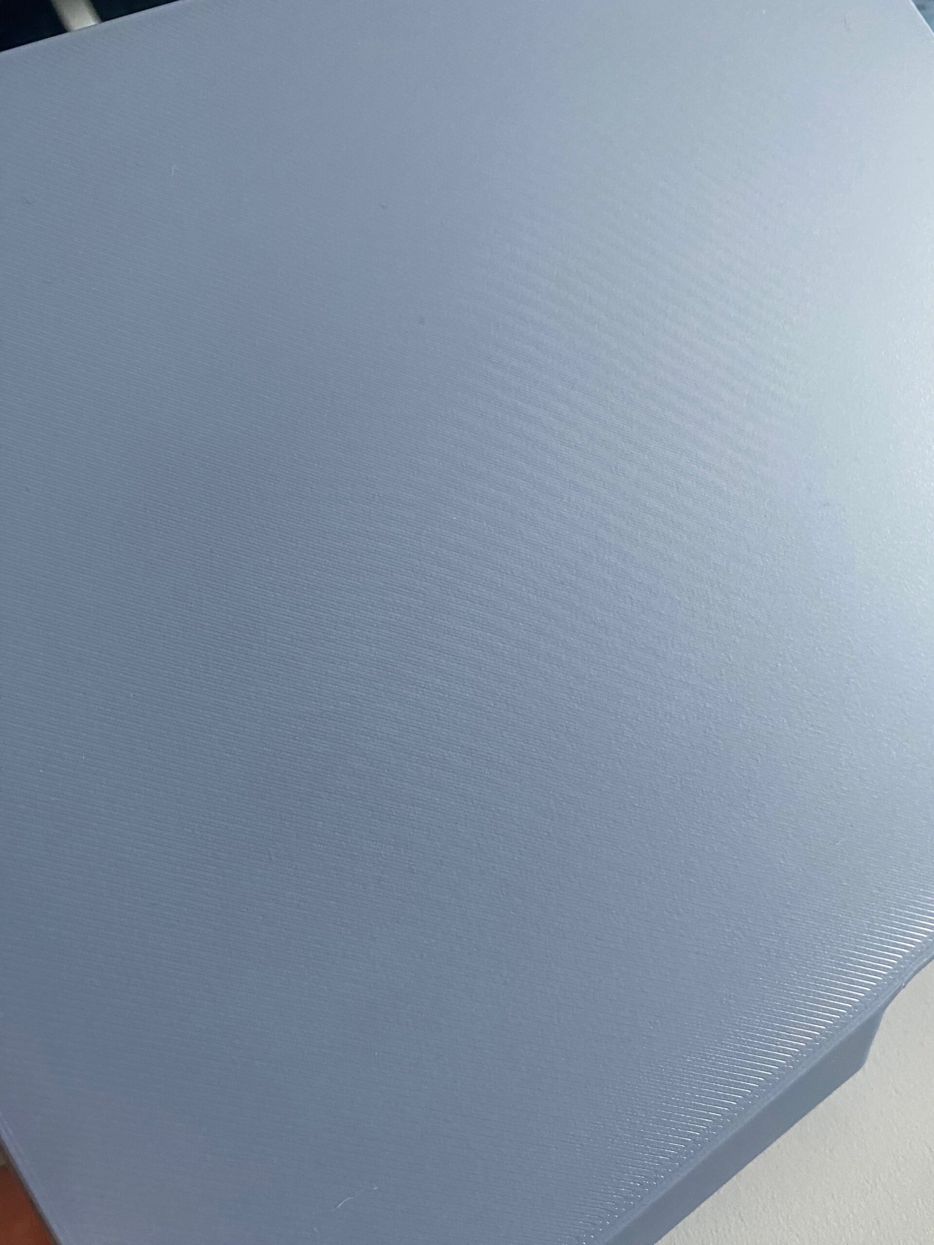

Everything works stable for me with 5.0.0-RC except for one issue I am having when printing large first layer.
Currently printing 220mm x 180 sorting trays, and first layer has very visible "zebra pattern".
It is visible when using either 0.20mm SPEED or 0.20mm STRUCTURAL profiles, on both smooth and satin sheets, eSun PLA+ Grey filament.
When printing using 5.0.0-RC firmware, but "classic" printer & profiles from PrusaSlicer - 0.30mm DRAFT - the issue is gone.
Any advices apart from printing layers slower?
