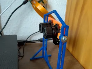

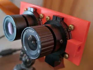

On weekend I constructed and 3Dprinted a dual Raspberry GS/HQ camera holder:
https://forums.raspberrypi.com/viewtopic.php?p=2200179#p2200179
[for high framerate (>300fps) stereo video capturing, two concurrent 688x136@402fps recordings just work]
Although the tripod mount worked, I continued with original plan to create a PT stand for the holder:
By accident my OpenSCAD files made the print 10.2mm too wide, and I had to 3Dprint two round 5.1mm distance parts.
I just wanted to slice the corrected (10.2mm) less wide .stl with PrusaSlicer 2.6.0 to get time for new model, I used "0.15mm quality" before.
But starting that version tells me that it is incompatible with currently installed configuration bundles (from 2.7.1).
So for 2.6.0 the time to 3D print with "0.15mm quality" and 100% infill was 6h30m.
With 2.7.1 for same "0.15mm STRUCTURAL" and 100% infill the 2.7.1 PrusaSlicer generates 4h43m gcode.
And with "0.15mm speed" and 100% infill 4h27m gcode.
Obviously that design has not enough potential for high speed because there are nearly no long parts.
So I tried the camera holder (that took 1h16m with 2.6.0 and "0.15mm quality" and 100% infill) with 2.7.1.
"STRUCTURAL" .gcode print time 52m, "speed" 47m.
I would have awaited "speed" showing more difference for that model.
But overall ("STRUCTURAL" seems to be what was called "quality" in 2.6.0), STRUCTURAL is so much faster than quality in 2.6.0 without input shaper(!).
(I use 100% because I want the parts to be stiff and stable, and because they are one-time prints)
