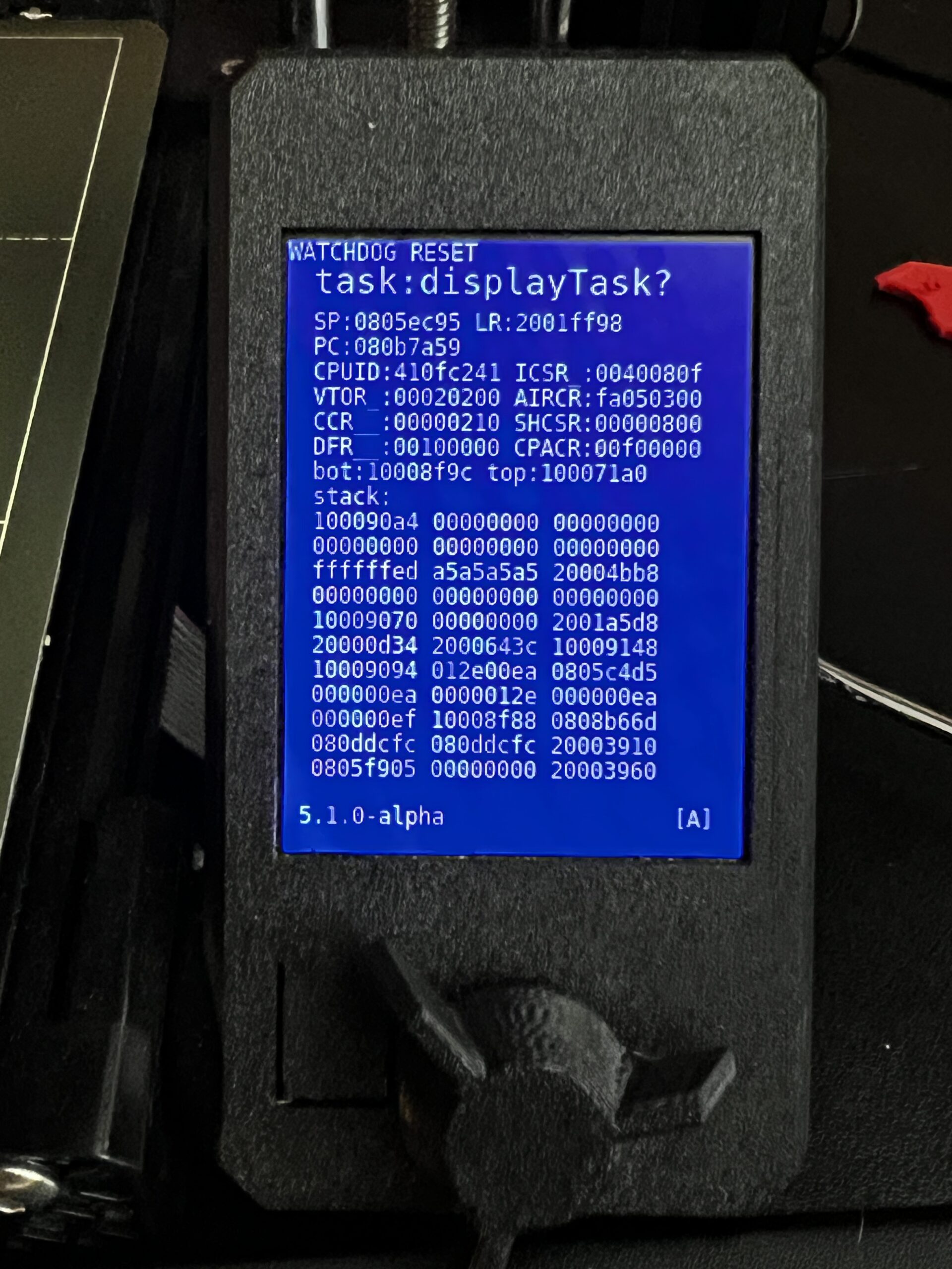

I wanted to try out this new firmware, but every time i choose a file to print, the screen freezes and crashes. Anyone know how to fix this? I factory reset the printer as well and this did not help. This Video show exactly what I see every time and I am including an image of the error screen.

One of the files I tried printing is the speedbenchy and the bonkers benchy provided on the alpha release GitHub. I tried my own gcode files but everything, including the provided benchy gcodes, caused the error. I downgraded to 4.4.1 and these files will print, but without input shaping.

I also have the same BSOD described above whenever I try to print with the pre-release FW (v5.1.0-alpha1 ) that was released last week. Everything else in the pre-release FW worked for me including the complete self-test which was successful.
Had to do the reset and press the knob thing to downgrade back to 4.4.1. The model that I sliced with the new Input Shaper printer configuration in PrusaSlicer seems to be able to print with 4.4.1 though the print quality needs to be checked since the FW is not doing input shaping compensation.
