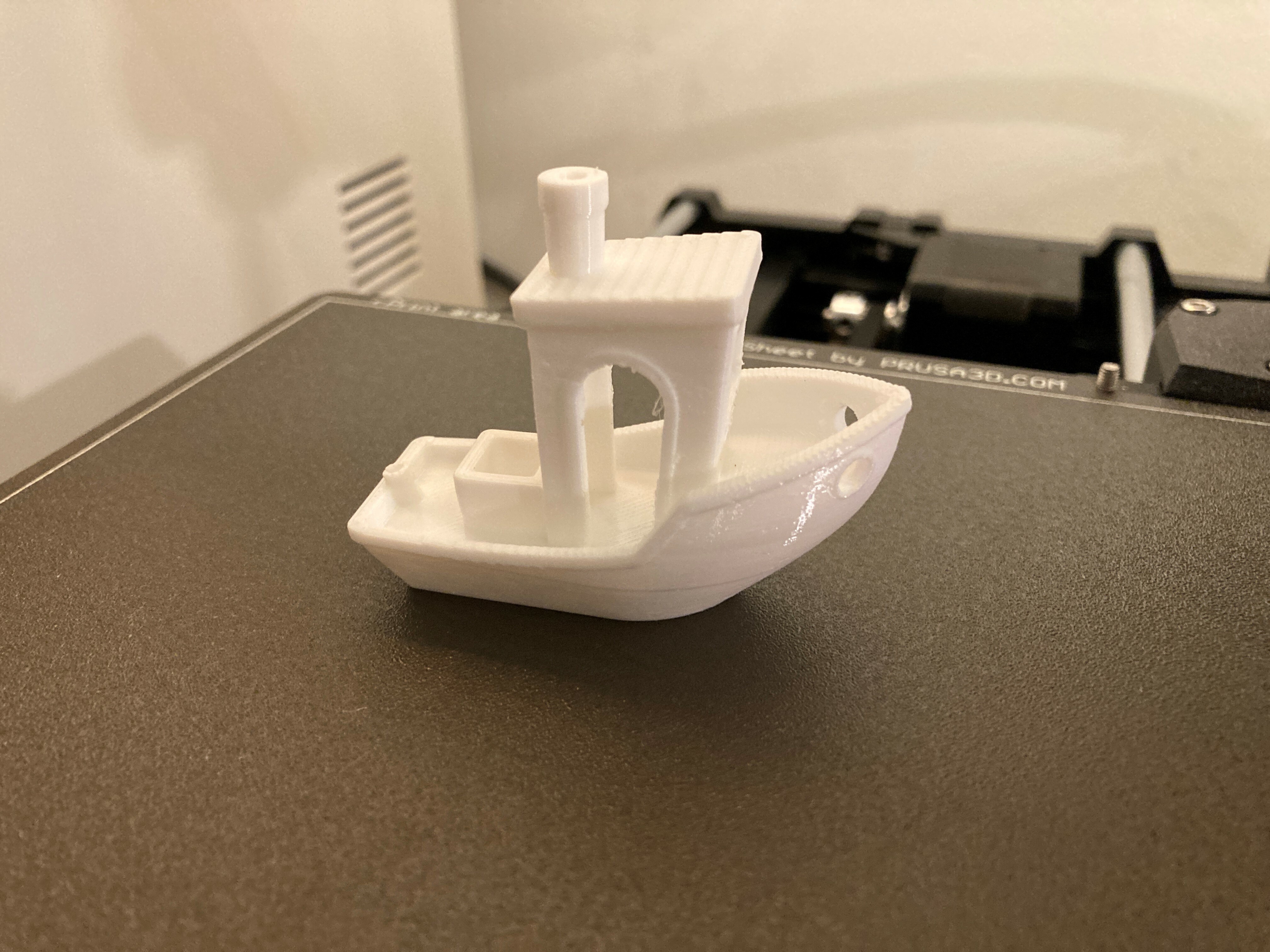

Hello everyone,
I wanted to share with everyone a cool video that helped me calibrate my Prusa Mini+ slicer settings well enough to print TPU with it.
The guide is over here and it has a very scientific approach.
This post & thread I think can be of help to someone. If you have had any experience printing TPU / flexible filament on the MINI, please share your experiences!
I'd be interested to see if anyone on the stock extruder managed to print TPU?
It was a big selling point to me in terms of the Bondtech extruder upgrade which I ended up getting, but I actually never tried to do it on the stock extruder.
I printed a retraction tower, which shown me that 9mm/s should be best, but possibly even 10mm/s would be OK; could test that further.
Next, I printed a temperature tower, and for my TPU (S-FLEX from Spectrum, black color) I found the optimal temperature to be 235 °C first layer, 233°C all other layers. This all is shown in the video.
Overall probably like 10g-20g of expensive TPU filament "wasted", but it helped me learn a lot about how to print with it.
So it is not really a "waste".
My approach was, following the video:
  1. Download newest CURA and add the temperature/retraction towers add-on like instructed, to generate proper GCODE files for calibration
  2. making a retraction tower, like the video instructed (make sure to double check after how many layers retraction distance switches)
  3. making a temperature tower, like the video instructed (make sure to double check after how many layers temperature switches, it was wrong to me)
  4. from the video I have learned that TPU prints slow, but it still requires fans. I found conflicting information online; some people claimed it prints so slowly that you could have your fan on 0%, but I disagree; prints cleanly only on 100% speed.
  5. from the results I got that 9mm retraction is the setting I want to go with; also, the temperature settled at 233-235. Keep in mind filament says 200°C -230°C , according to the manufacturer
  6. made sure my Prusa Mini extruder upgrade from Bondtech (Different extrusion GCODE) is included in the printer settings.
  7. To compensate for the cura slicers' wall overlap, I did give an extrusion multiplier to my material. I might have overdone it, but I am already satisfied with the result, and I would rather have a bit of extra lines on the sides than the cube being not rigid and/or separating.
  8. Created a set of settings in PrusaSlicer reflecting what I learned, created also a separate printer profile, material profile and set the temperature accordingly, only for this purpose.
  9. I had problems with first layer underextrusion, turns out I made the calibration badly; I should've trusted the calibration I made with PLA filament before all this. If you're getting first layer underextrusion, try some Live adjust Z during prints, and see if anything changes.
  10. If everything else fails, try going slower. I ended up having 15mm/s in every field in Print settings -> speed. First layer was 10mm/s.
  11. Printed a calibration cube, results below.
I know the cube is not perfect, but then it's TPU, so you have to compromise. I think precision and rigidity is good, and for mechanical applications they are the key parameters. After this calibration, I am going to print a stationary bike foot holder, because it broke.
Below is also the quote from my settings that I used to print, if anyone is interested.
If you save below code as an .ini file, it should be importable into PrusaSlicer.

rinkel
(@rinkel)
Topic is a bit old, but printed a benchy in TPU95 today.
This might be not as soft as the others here printed, but it suits my needs.
tpu_benchy
Posted : 16/03/2022 9:00 pm
