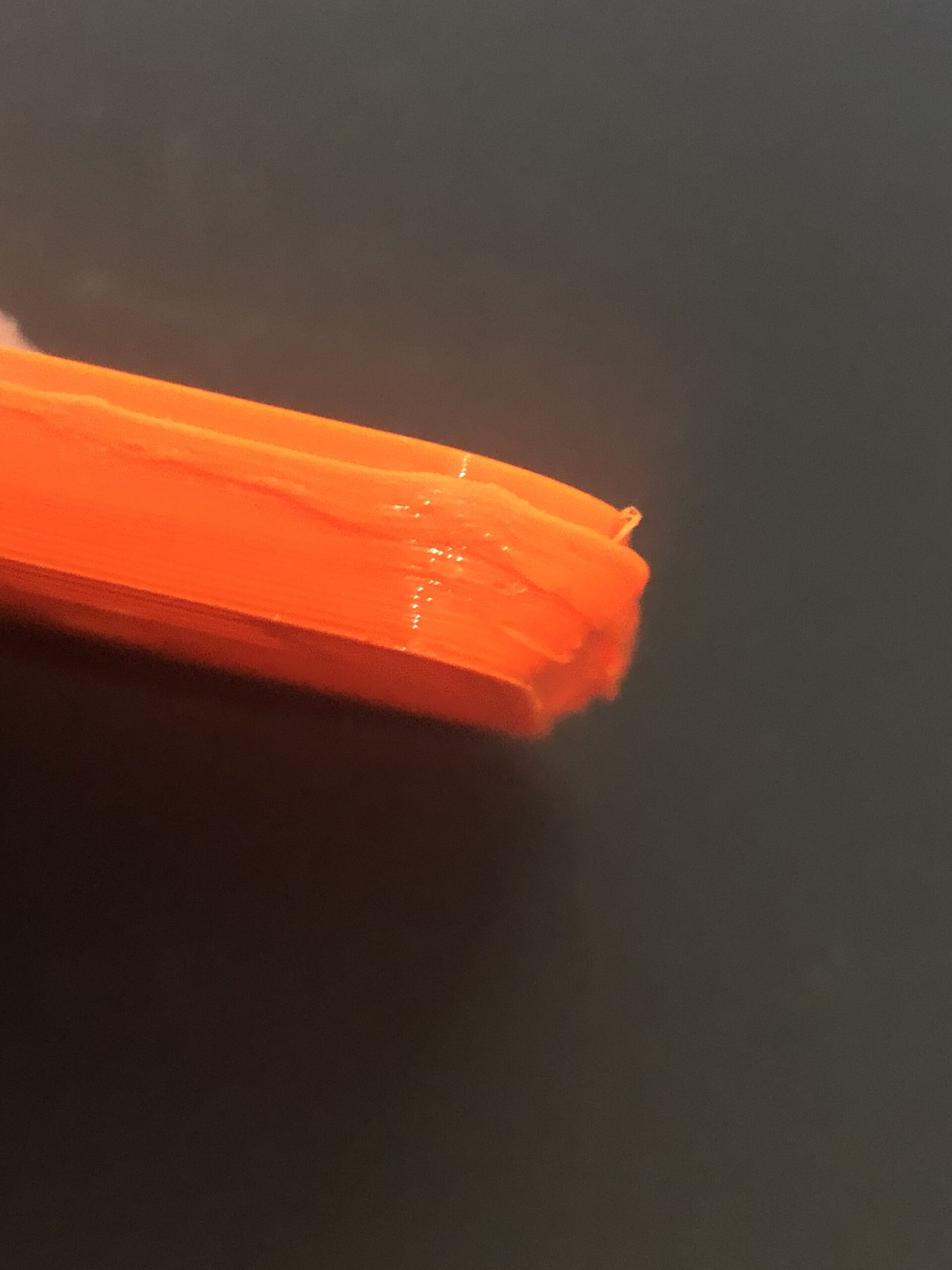

Hello
I need some advice. It's the first time I'm struggling so much.
Here is a model I want to print

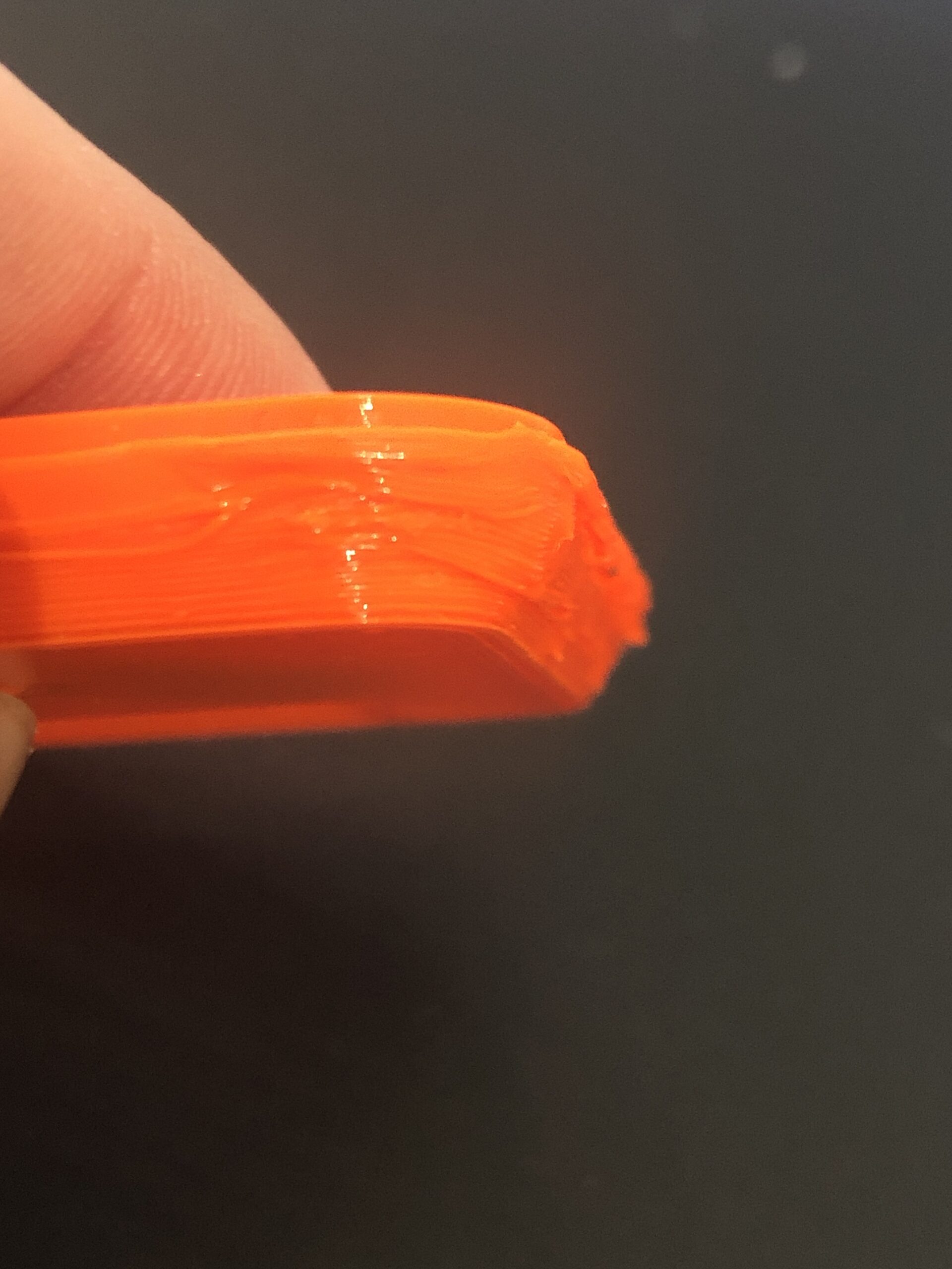

I print it lying on its backside. The "raising" fillets are far far from what I would expect. They ends up irregular/damaged (some material strings printed in the air). I tried supports but it didn't help either.
Print without an Input Shaper looks a bit better but is still far from the model definition. In general, despite irregular print, the fillet is closer to the chamfer.
Just for reference, my MINI prints 3D benchy perfectly.
Is it possible to print such curves upside-down on MINI?

Nope, not on any fdm printer really.  Those are precisely how NOT to do a 3d print design.   The bottom of the curve is a complete overhang, and as the gap between the bed is so small there isn't enough room to get supports and the z support gap under there, so supports cant help.  By the time its high enough to fit support the angle has changed so that supports are less useful anyway.  A Better design has the lower part as a 45 degree chamfer that then transitions to a fillet once the angle increases higher up.
Your print looks particularly bad so you might also have some other issues going on with cooling but that geometry just doesn't print well at that orientation full stop.

If you support it with PLA or PETG depending on what your printing, with zero clearance you can do it.  Model separate bodies in CAD that match the shape exactly.
I've done it with good success.

No, @neophyl is right.  It looks like the op has followed a design for injection moulding.  Whilst it could be printed with elaborate workarounds, as it's his own design, it's simplest to chamfer the corners.

Thank you for your responses.
I print using PETG Prusament with default Prusament profiles. I cannot confirm or refuse arguments about temperature correctness. But I don't have other problems with printing, so I assume OP problems are specific to this particular case.
As mentioned the easiest way would be to replace fillets with chamfers. Another way is to get rid of slicky design leaving sharp corners. I have to admit that it would be the easiest solution. It's just a box for God's sake 🙂
But I hoped it can be achieved somehow.  I'm going to look at Brian's videos too. Right now I succeeded in printing it upside-down, with a hollow space facing a print bed. Of course with extensive use of bridges. The result is great. But it requires a lot of additional material for bridges, takes twice the time, and... the box has an opposite part which is even deeper with some sizing-sensitive elements inside.

Alternative option.... print it right-side-up, and support the underside.
No need for mixed material, the shown surface keeps good quality, and minimal scarring underneath due to flat supporting.
