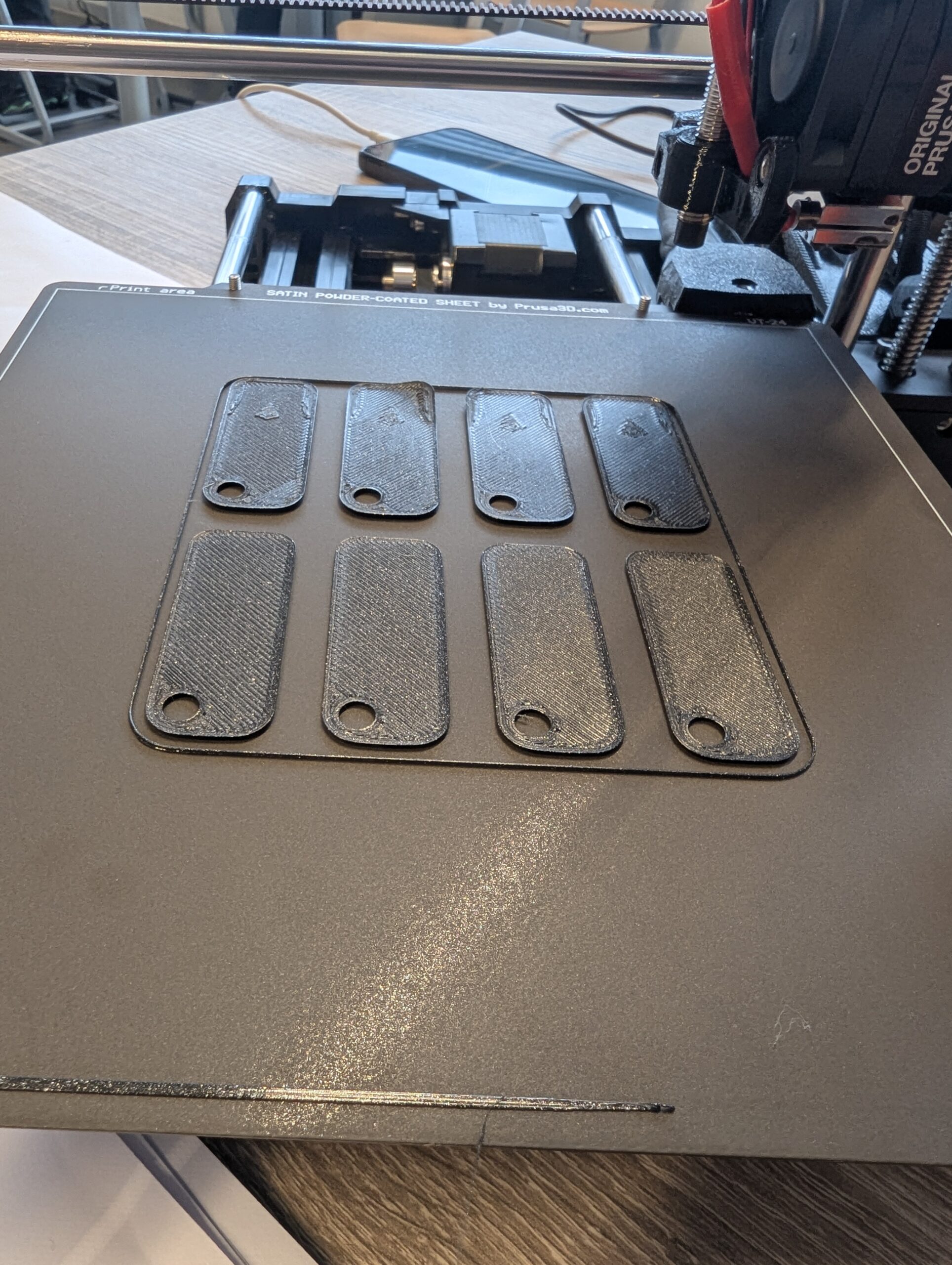

I have tried all different kinds of printing this in PLA. With and without Brim, putting the bed a few degress higher (210/65(or 70)). But it still keeps unsticking, any suggestions?

Thoroughly clean and dry the print bed with hot water and lint-free cloths.
Reduce the first layer height (?) to 0.15 mm, for example.
Set the Z-offset to -0.05 mm if problems persist.
However, ensuring that the print bed is free of grease and residue is the top priority.
