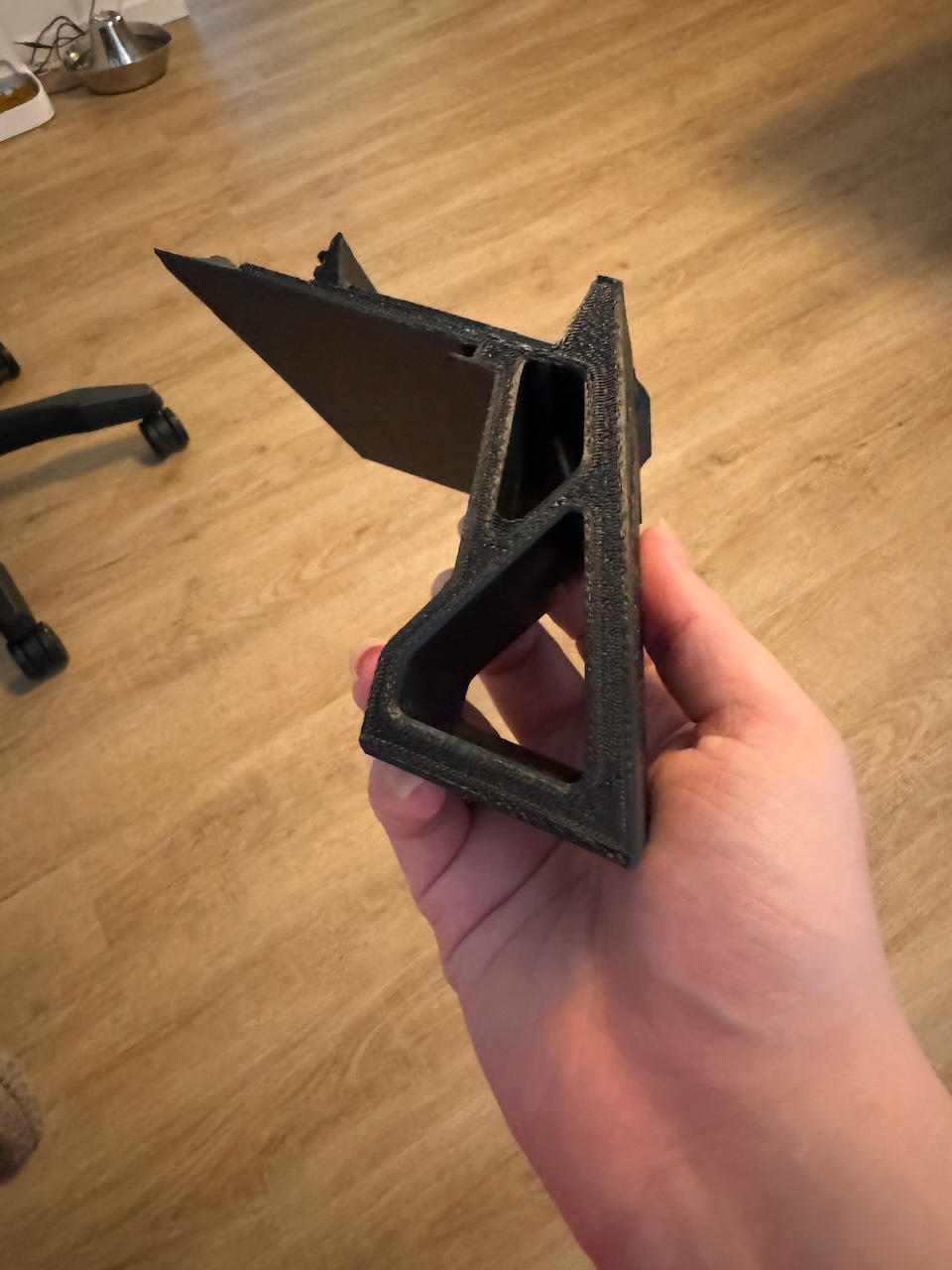

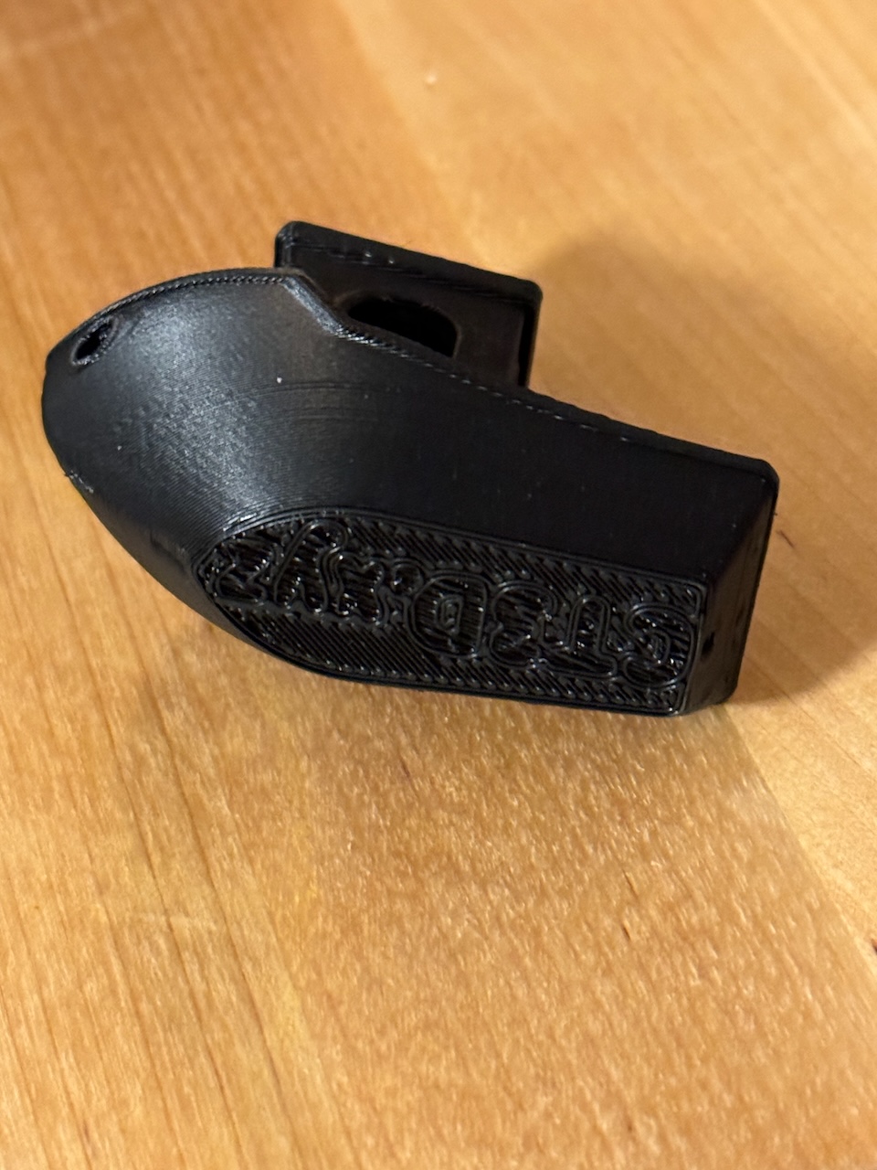

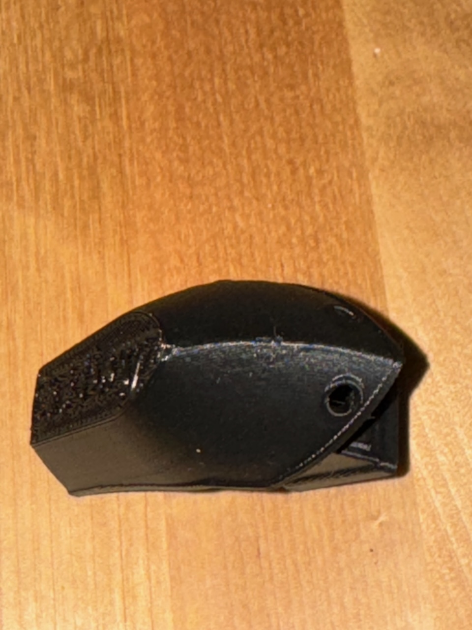

hello
was trying to print the mini base and after watching the first few layer I went to bed and woke up to a kinda dirty nozzle and bit messy print generally there were a loot of little wire/spaghetti of melted PETG stuck to between parts and the support that was supposed to be created was not created correctly could only find a tiny piece with pet spaghetti on it
any idea whats wrong?

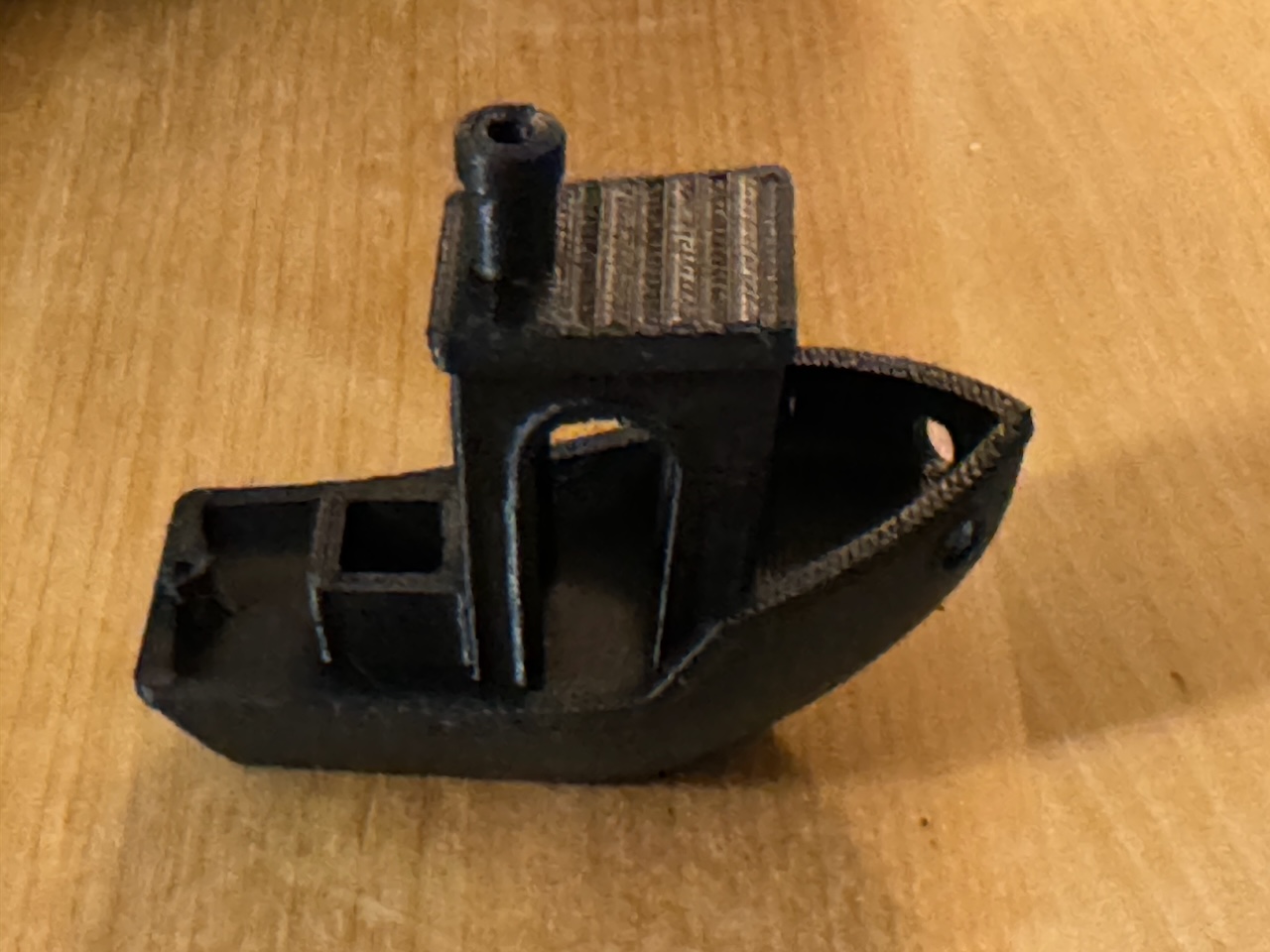

tested a benchy not bad but not perfect

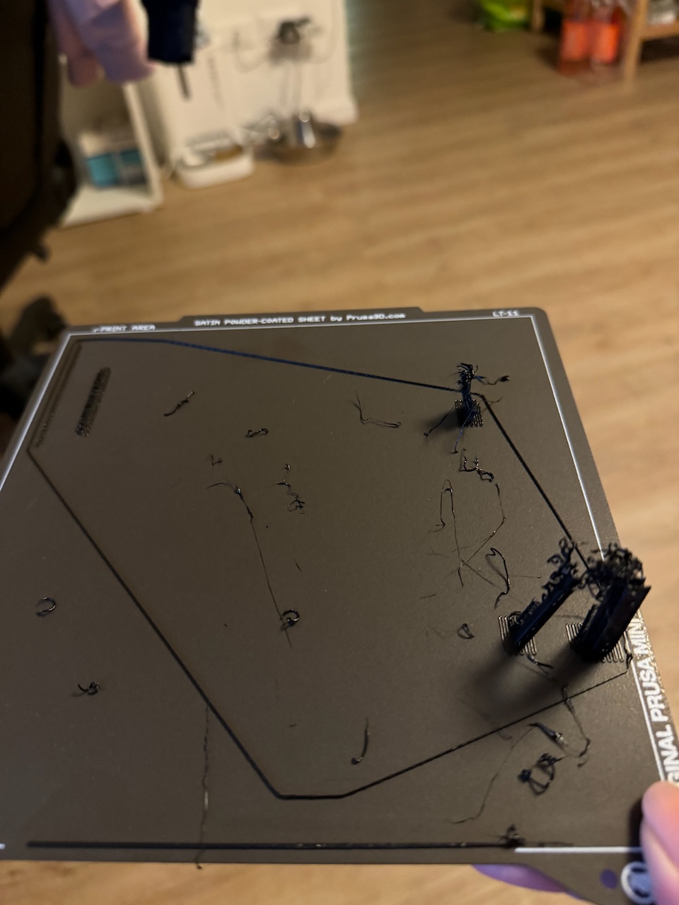

Left over from the mini base print (1st post)

Your first layer offset is way off. Far too high, that means the filament is not nearly squished enough onto the build plate. Otherwise your Benchy looks quite ok. It looks like it is printed a bit too fast (or part cooling is not set high enough).
