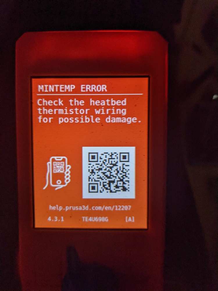

This week I started randomly getting the red screen reboot of death while printing from OctoPi.  Disconnected the pi and printed from USB with the same result, but this time with better error codes indicating the MINITEMP had triggered.

Error screen:
Error screen

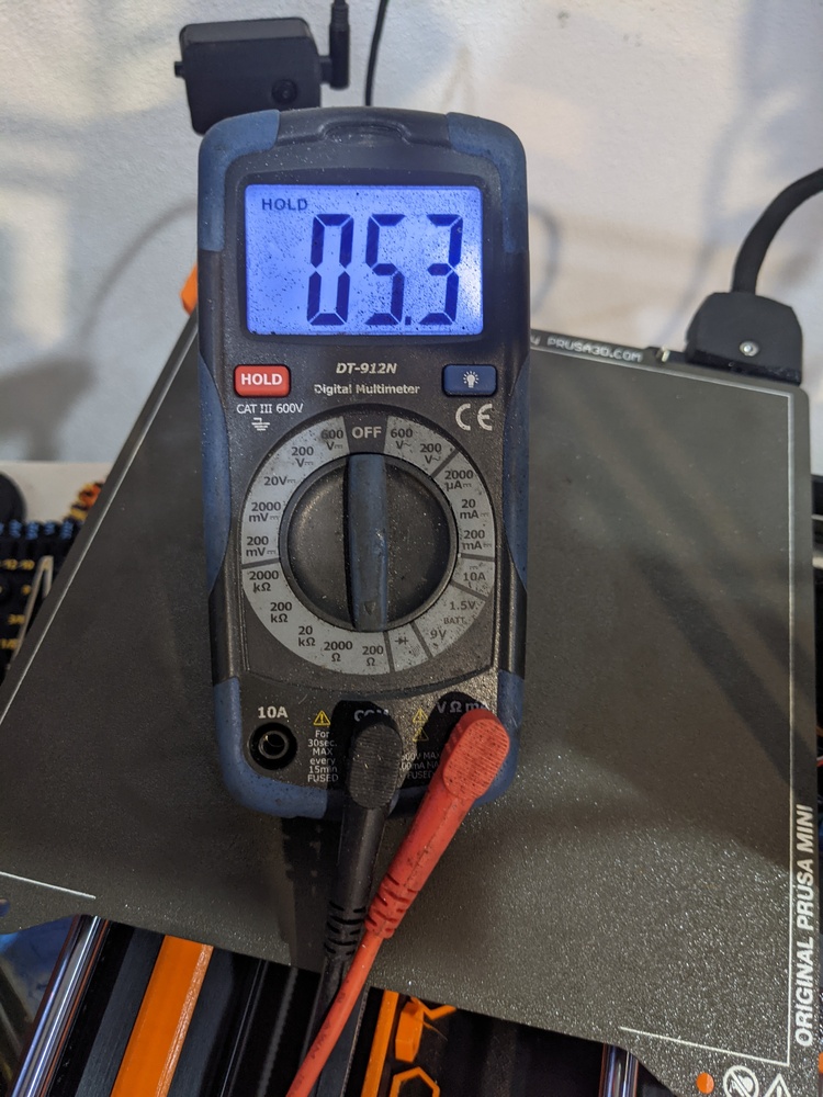

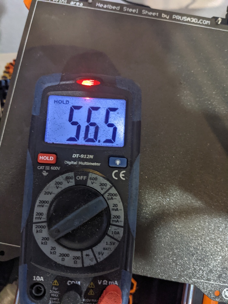

Bed probe resistance:
bed probe resistance

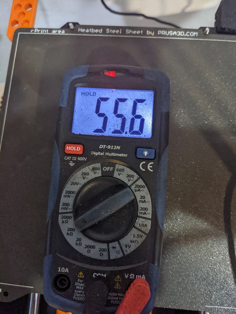

Hotend probe resistance:
hotend resistance
Heater resistance:
heatbed resistance
