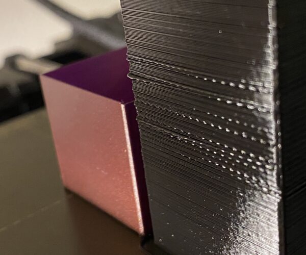

I'm having trouble with inconsistent extrusion on my Mini. Sometimes it prints perfectly after a filament change or a cold-pull, but after a little while it extrusion starts to vary. From so low there is small holes in a line to blobs hanging on the side of the print.
I have done a lot to get rid of this:
  • Installed a Bondtech extruder (updated e-steps, and verified them).
  • Installed Bondtech heatbreak and did a PID autotune. Temperature is steady.
  • It happens with multiple filaments. The two in the picture are just-out-of-the-box Prusament Jet Black and Mystic Brown.
  • Print temperature has no effect on this problem.
  • Changed the nozzle to a new one.
  • Cleaned the nozzle with an acupuncture needle.
  • Changed the bowden tube to a new one.
  • Changed the PTFE in the hotend. Both when installing the bondtech heatbreak and again later. No debris or any leftovers to be seen there.
  • Reset the heatbreak to put more compression on the PTFE tube even though that shouldn't be ad critical with the bondtech heatbreak.
  • The extruder stepper is not warm nor does it click or grind the filament.
  • I've printed both from usb and from Octoprint.
  • Tightened the belts. May have been a bit loose, but it didn't help.
  • Tried tightening and loosening the tension on the extruder with no effect.
The prints in the image is simple vase printed squares.
Brown one was after a filament unload/reload. Black one was after a cold-pull, good at first, then bad.
What else can cause this effect?

It looks a bit like layer shifting, but on some layer it looks like its squeezed. Whats the tempreture you're printing with? Did you tried to change it?
Does this also happen at other prints?

I have the same issue with my Mini. If I clean up the hotend with a cold pull, the first print seems like ok, then it over/underextrudes again. I also have the bondtech extruder and the heatbreak, also upgraded the PINDA probe to the Super PINDA. I'm really clueless right now.
Did a cleaning, still there is a bit of overextrusion
The next one totally failed...
After a cold pull, again, quite decent.
After this, of course it goes back to inconsistent again...
