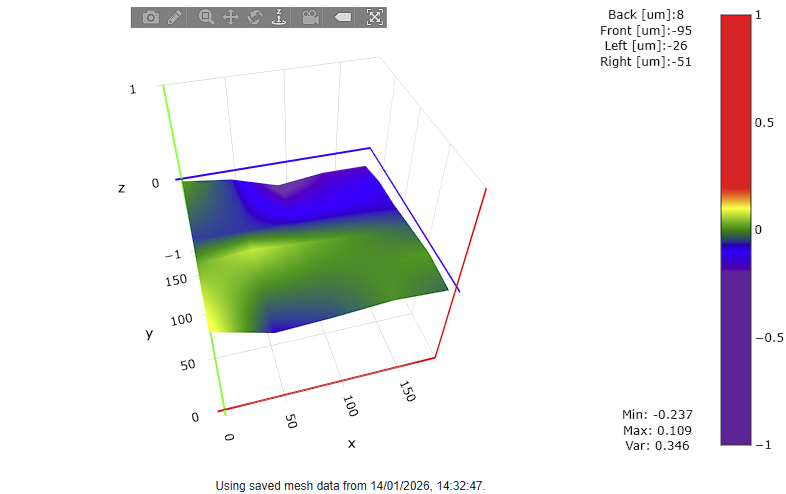

first layer anomaly
sometimes i get incosistent first layer on my mini+ and sometimes is good, bondetch extruder, revo micro, nozzle 0.4mm HF, filament 220°, bed 60° (sunlu gray pla+ 2.0 in image), the bed level looks good (bed visualizer from octopi in image) any ideas?
Mini+, Core one+

Needs more pictures under different angle and againt the light.
Looks like a nozzle being too low and dragging over the bed, try to increase the znoffset a bit higher.

i've almost completely dismounted the mini+, looks like the ZX printed block (the one with motor in) has cracked and broke, i've dismounted half of the printer and will re-print all printables pieces in PC blend, hopefully the issue will go away.
thanks for the tip anyway.
