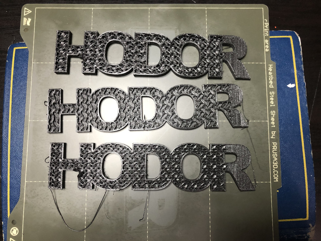

I just received my Prusa Mini recently and I have had a very hard time printing anything other than what is included on the thumb-drive that came with the printer. After a third of the print, it starts probing, says probing failed, and then bed leveling failed. I tried the same print 3x and it failed in the same spot so I made a quick video. This exact thing has also happened on several other models I attempted to print. I used Prusa slicer.
Not sure what's causing it. Any suggestions?
Best Answer by dm:
Turns out the USB Thumbdrive that I received with my MINI has some sort of issue with writing new files to it. As soon as I switched the thumbdrive with one I had lying around, the prints started finishing successfully. I Would recommend anyone having these issues to try a different thumbdrive.

@dm
I can confirm the usb that comes with the mini is crap. I have two minis and both thumb drives have gone bad (cant write to them) withing in 2 days of getting them.
