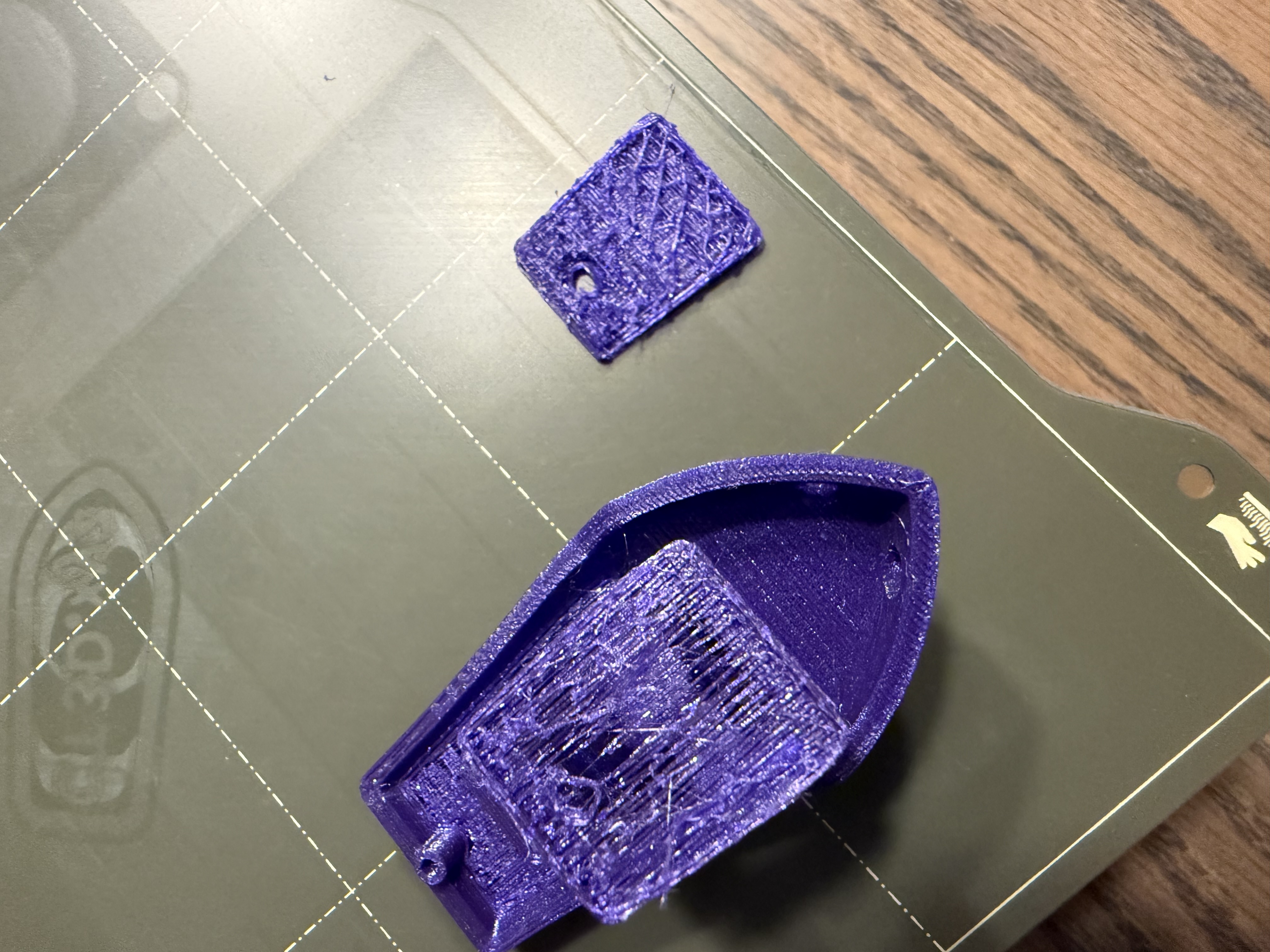

So I raised the temp 5 degrees, put in new filament. It printed much better except the top of the benchy. The top of the roof came off, like you could just peel it off. And the pipe on top of the roof just snapped off by just touching it.
however the rest of the benchy is really strong. I can’t separate any of the other layers on the haul or anywhere else. It is just the top. Of the roof & the exhaust stack.
I uploaded pictures to show what it looks like any other suggestions on how to fix this? I will run a couple other prints to see how they print.

Looks like under extrusion where it's printing fast. Are you using the same print profiles you always did, or have you recently changed them.
Under extrusion has lots of potential causes, partially blocked nozzles, poor extruder door tension, printing temperature too low.
Guessing by looking at that print I'd guess maybe your using a speed profile and you need to raise the nozzle temperature by 10 degrees minimum.  That infill looks really underextruded, and that makes sense because that prints at the highest speed.  You can watch while it's printing and raise the temperature until it prints correctly.
The other option is to lower either the infill speed in the print settings, or lower the volumetric flow rate in the filament profile.
I have found over the years that not all filaments are created equal.  Aka Hatchbox PETG has a max recommended printing speed of 100mm/sec while Polymaker PETG is only 50mm/sec.
