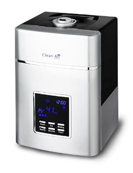

Dry air favors the formation of electrostatic charges. A room air humidifier can help if the correct humidity level is reached, e.g. something like this:
air humidifier
