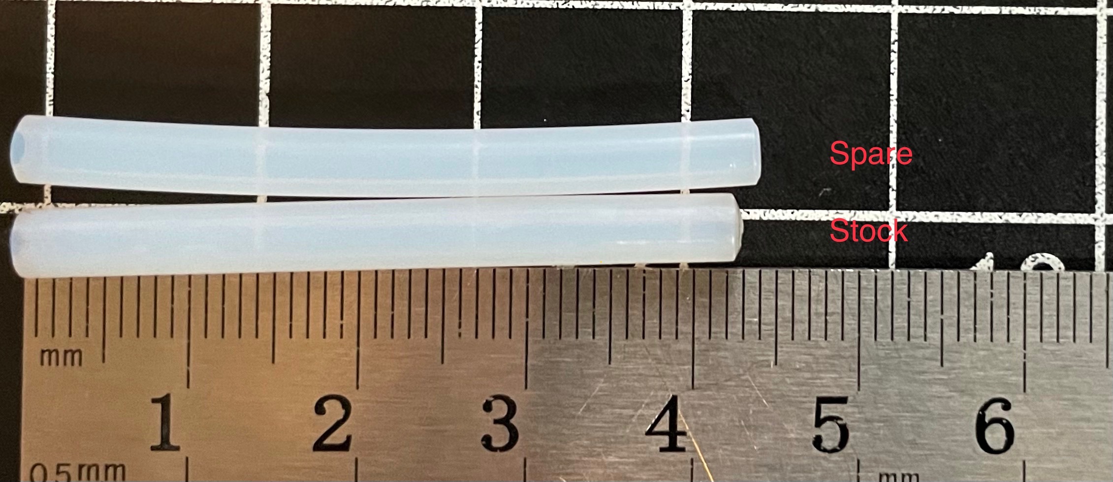

I have been having issues with extruder skipping and awful extrusion lately after hours and hours of printing.  I still have in consistent first layers which is another topic.  I pulled the stock ptfe tube out today after reading through the posts and compared it to the one from spare kit.  Is it normal for it to me a few mm shorter due to compression?  Look at the difference in this not so scientific taken photo. I just swapped them out and will try a test print. Prusa mini stock vs spare ptfe tube.
Opublikowany : 27/10/2020 4:34 pm
