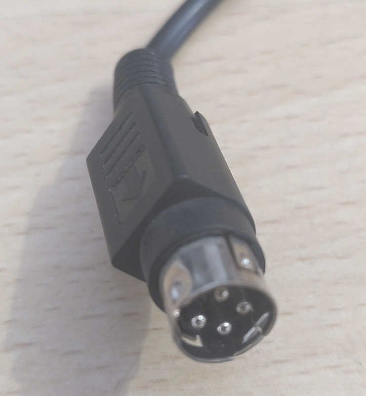

DC Power supply
Can the Prusa MINI+ be powered directly from a battery that delivers 22-29V depending on charge status?
What's the name of the connector they use?
Here are the image of the power supply marking and the connector:

You might find more details at PSU datasheet https://deltapsu.com/en/products/adapter/ADT-150C24AC ( https://deltapsu.com/en/products/download/Datasheet/ADT-150C24AC)
The connector is a standard '4Pin Din'
