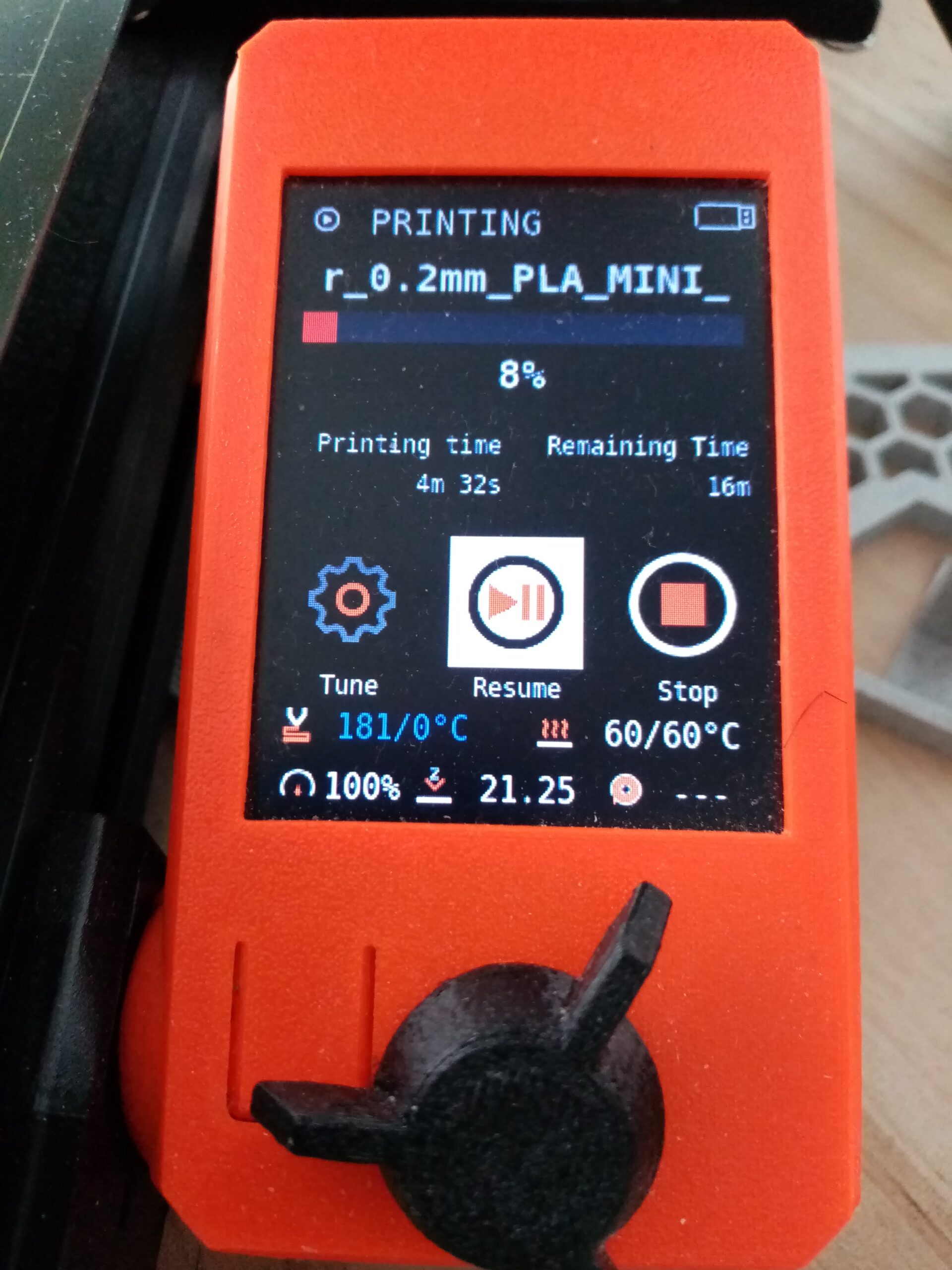

When inserting a command 601 the printer does not pause.
Same with MK4.
MK3 works perfect.

There is a known bug for the Buddy board which the Mini and Mk4 uses.
https://github.com/prusa3d/Prusa-Firmware-Buddy/issues/1963

I think you are doing something wrong.
On my mini+, the M601 g-code works as it should.
Attached is an image of the M601 command in the g-code.
