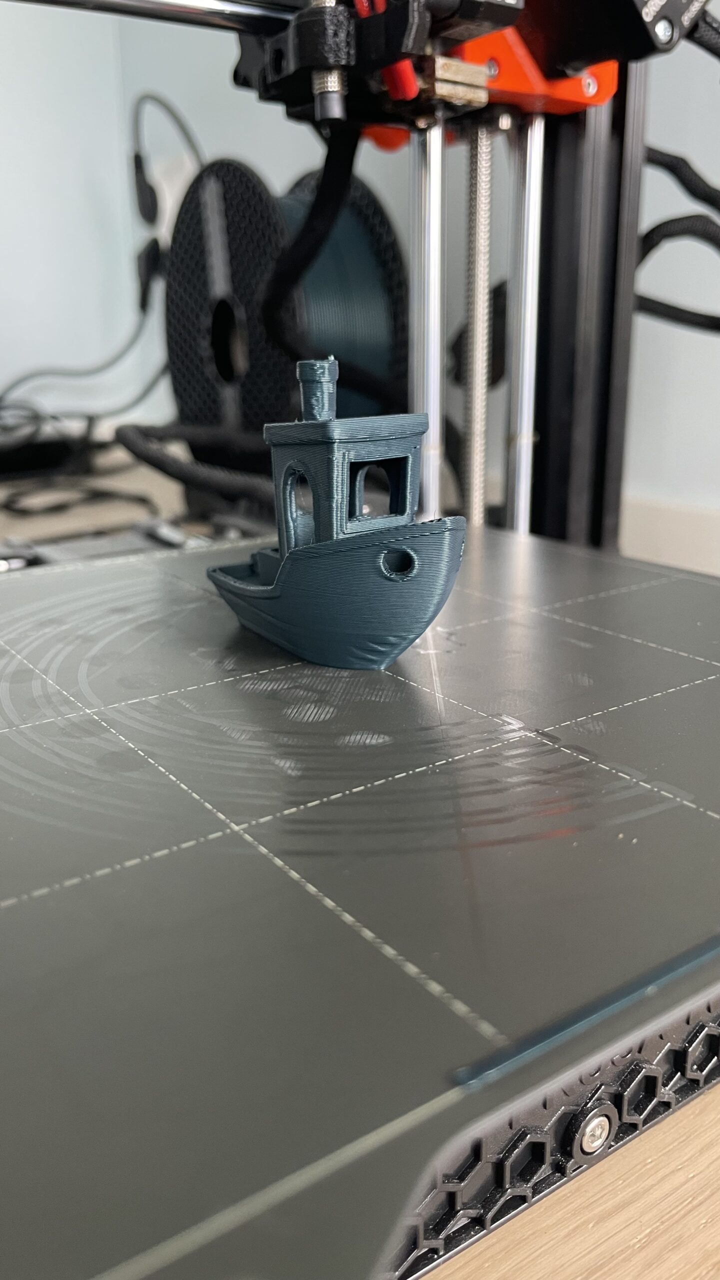

Wish I had read past the first post with the lnk to the firmware...  My machine had the x and y axis issues.  First I had some filament debris that I thought was blocking it. Then I actually found a dead moth in the way.  Neither fixed teh axis error.  Tuning the belts seems to have worked.  Re-tested teh XYZ and the printer passed. Doing my first alpha method print now.  FAST.
Seems like a game changer.  Doubles or halves teh number of printers or print time.  It doesn't give you a 'spare' though.  I have two minis. One has a REVO on it and that is the one with Alpha.  The other MINI is really sick and needs some dep maintenance.  I'm switching it over to REVO when I do that.  The Mk4 with Alpha is pretty sweet.  So three printers, or which it seems one is always down for some reason. I hope the NK4 with the Nextruder set up and REVOs on the Minis takes the biggest headache- hot end issues off the table.
For some reason the belt tuner on my iphone 12 only works with Chrome also, not Safari....
Posted by: @jaydubblazer
On your Mac you need to run it with Chrome.  For what ever reason it lose t like Safari.
Posted by: @cor-2
Just installed everything and it looks very promising. I ran into a bug though, when I try to login to prusalink it wont accept my password on a mac. I just keeps popping up the password menu. On my windows computer there is no problem loggin in.
Cheers!
Ps. holy crap its now printing the benchy and the speed is insane 😀
This post was modified 2 years ago by MileHigh3Der
Posted : 27/09/2023 10:14 pm
