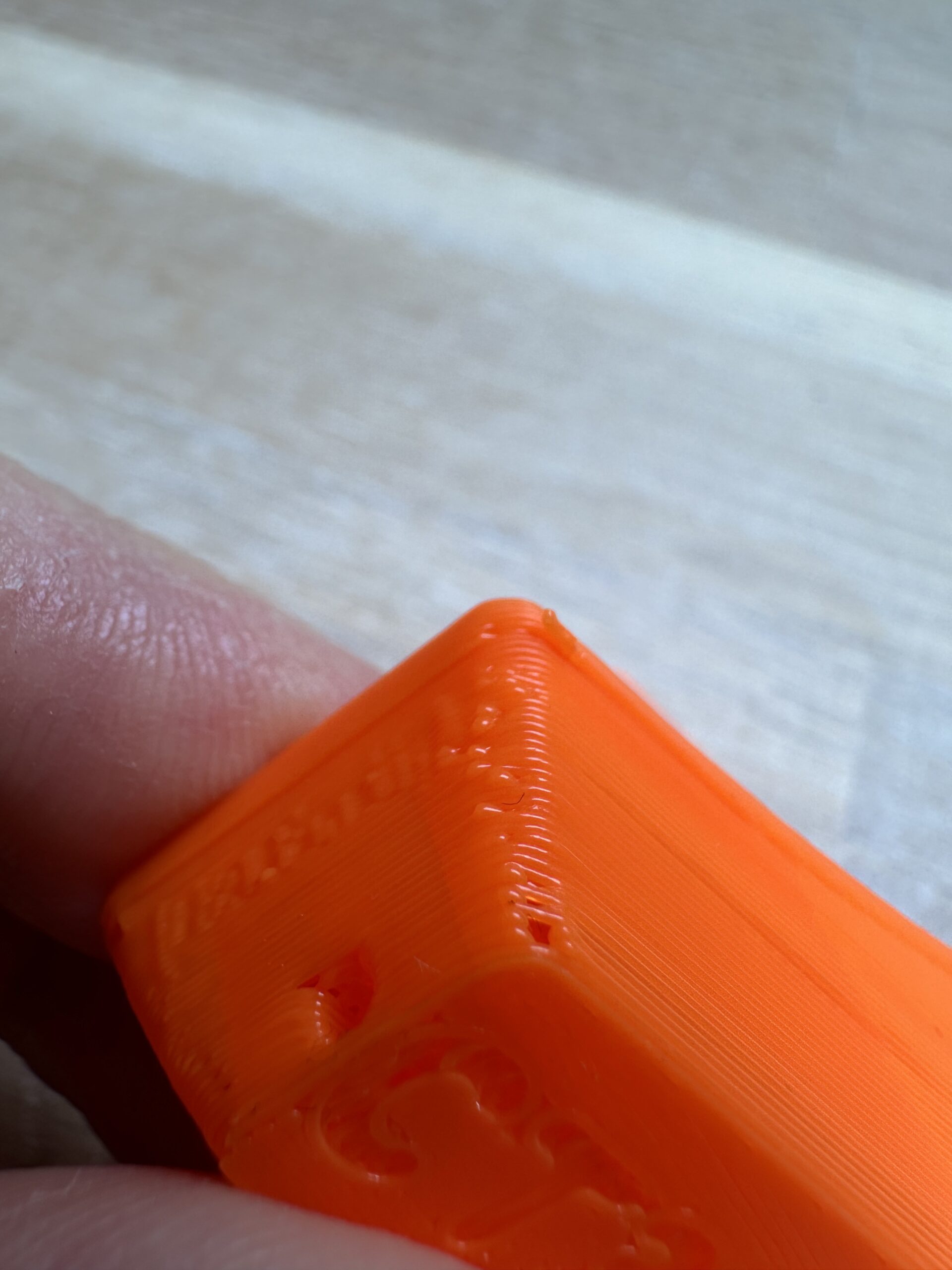

Can anyone tell me what is wrong with my corners? I used the G-code that comes with the firmware and use prusament PLA. Should be good right? Some hardware issue perhaps?
