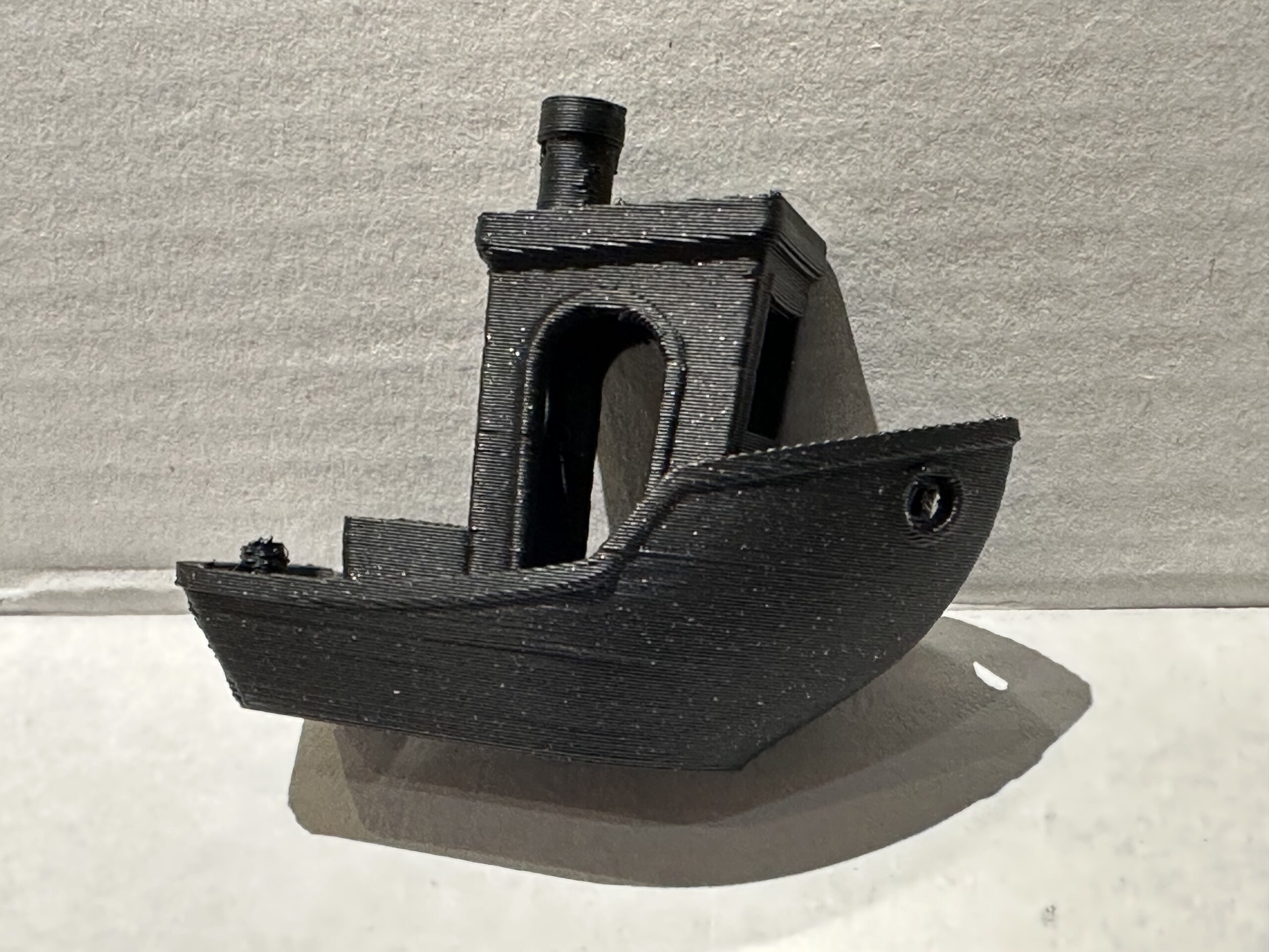

I am impressed! Especially considering I forgot to swap my nozzle from 0.6 to 0.4.
I have never seen my Mini move so quickly. No ringing on this print either.

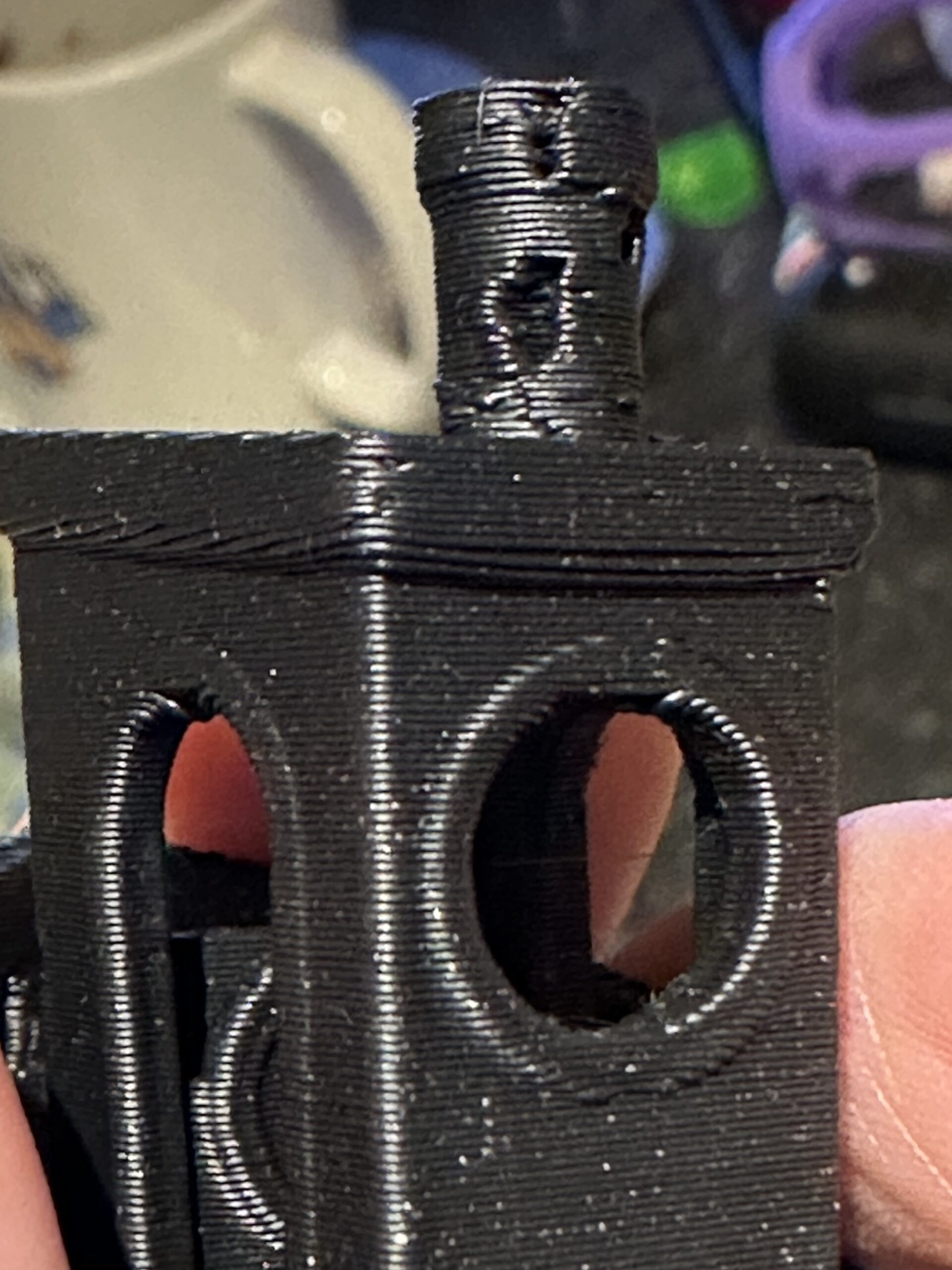

I was impressed before I put the right 0.4 nozzle on, now I'm very impressed. For a 17 minute Benchy this is pretty amazing.
Although the seams need a little work...
